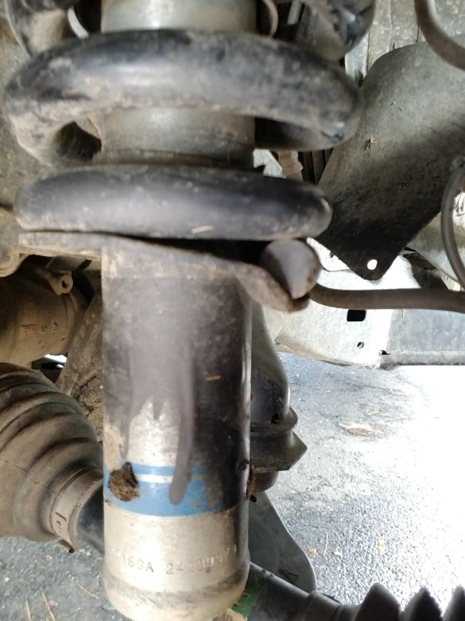

    So long story short, when I installed my 5100s, the snap ring got bent downward a little. I flipped it around assuming that the spring perch would just hold it in place. Yesterday I was looking for a clunking noise in the area, and noticed my spring perch is slightly crooked on the strut.
    What are the chances the spring perch just slides down the strut and I have nothing holding up the front driver side of my truck? If it fails, will it ride on the bumpstop to limp to the side of the road or will my wheel jam itself into the top of the wheel well and fuck everything catastrophically?

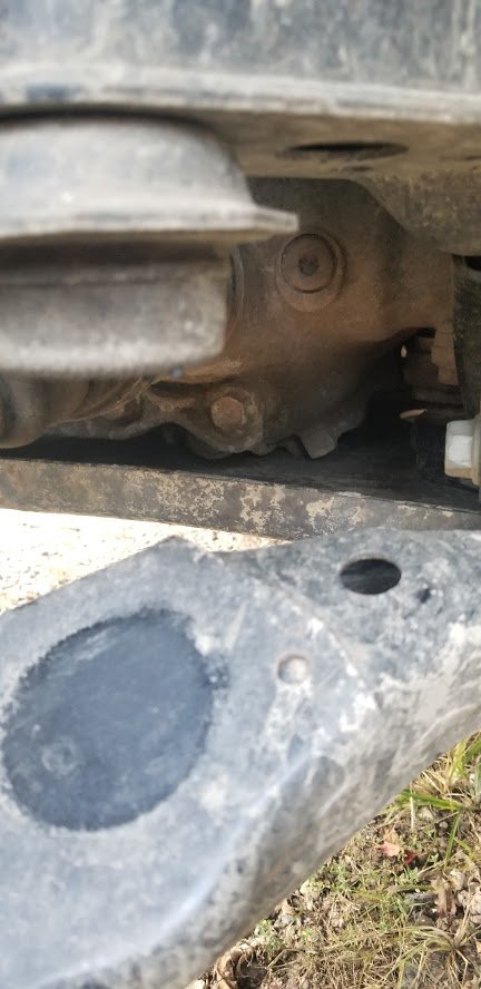

    I don't know why I didn't take any when I was looking yesterday. I did however take a picture of my skid plate basically against my transmission. Any problem with that?

    That could pose a problem if you bottom out on that skid plate.
    There should be a gap between the two.

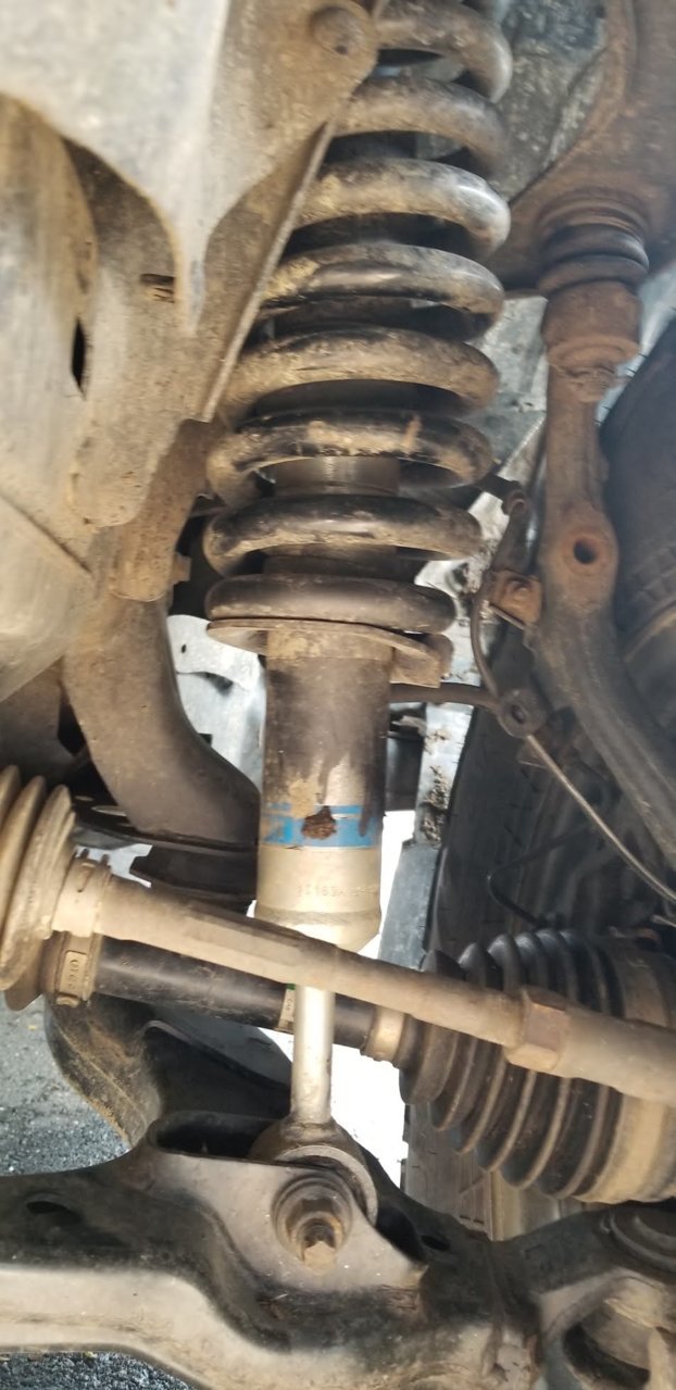

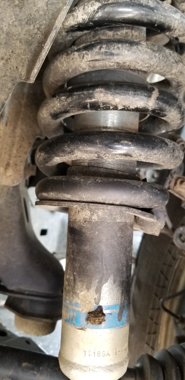

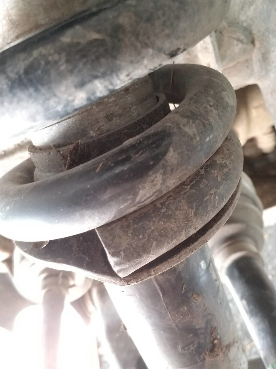

    @Skierrichy here's the best I can do while wearing dress clothes and not taking my wheel off. I think the last picture best shows it crooked. I originally installed the perch upside down, bending the snap ring a little. I had hoped the tight hold of the perch would keep it in place
    The black stuff is not paint, it's graphite lube from trying to figure out a squeak a while back

    You are going to want to replace though, there's no guarantee the rest of the ring will not start to bend, especially off-road.
    Ranger357 and Cativelense like this.

    I'd be nice to it until replacing.
