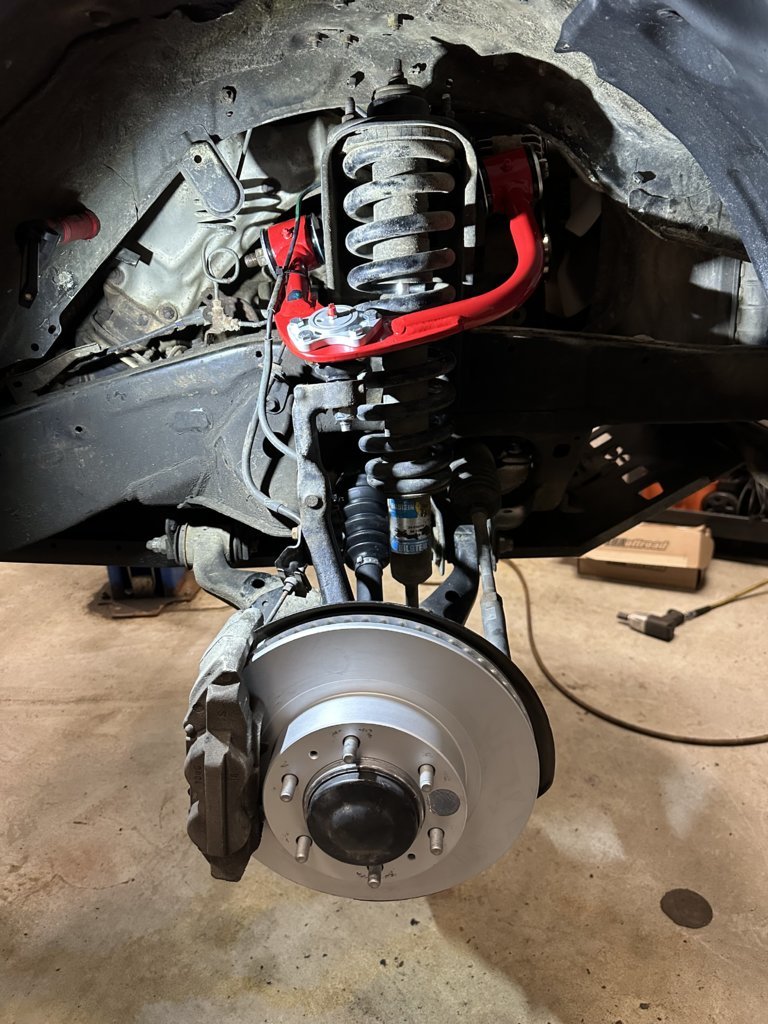

    Another issue is the axle nut. I can’t install the cotter pin with the aftermarket nuts and torqued to spec. I was able to make do with what I have. Ordered two new nuts from work.

    New axles, hubs/bearings, rotors, JBA upper control arms, new rear pads for the leaf springs (needed 10, only had 8). Cut one U-bolt and chamfered the end (more to do but cutting one took a while).
    Do have a small squeak (rotor hitting dust shield :confused:). I'll look at that on Monday. Hopefully my axle nuts show up on Monday but I'm thinking Tuesday.
    I used the old center caps until the new nuts show up and I know what the squeak is.
    Truck is so quiet now. Alignment is slightly off, thought it was going to be.
    Next on the docket is ARK splash shields, new front shocks, new calipers, cut the rest of the U-bolts and the two remaining leaf spring pads.
