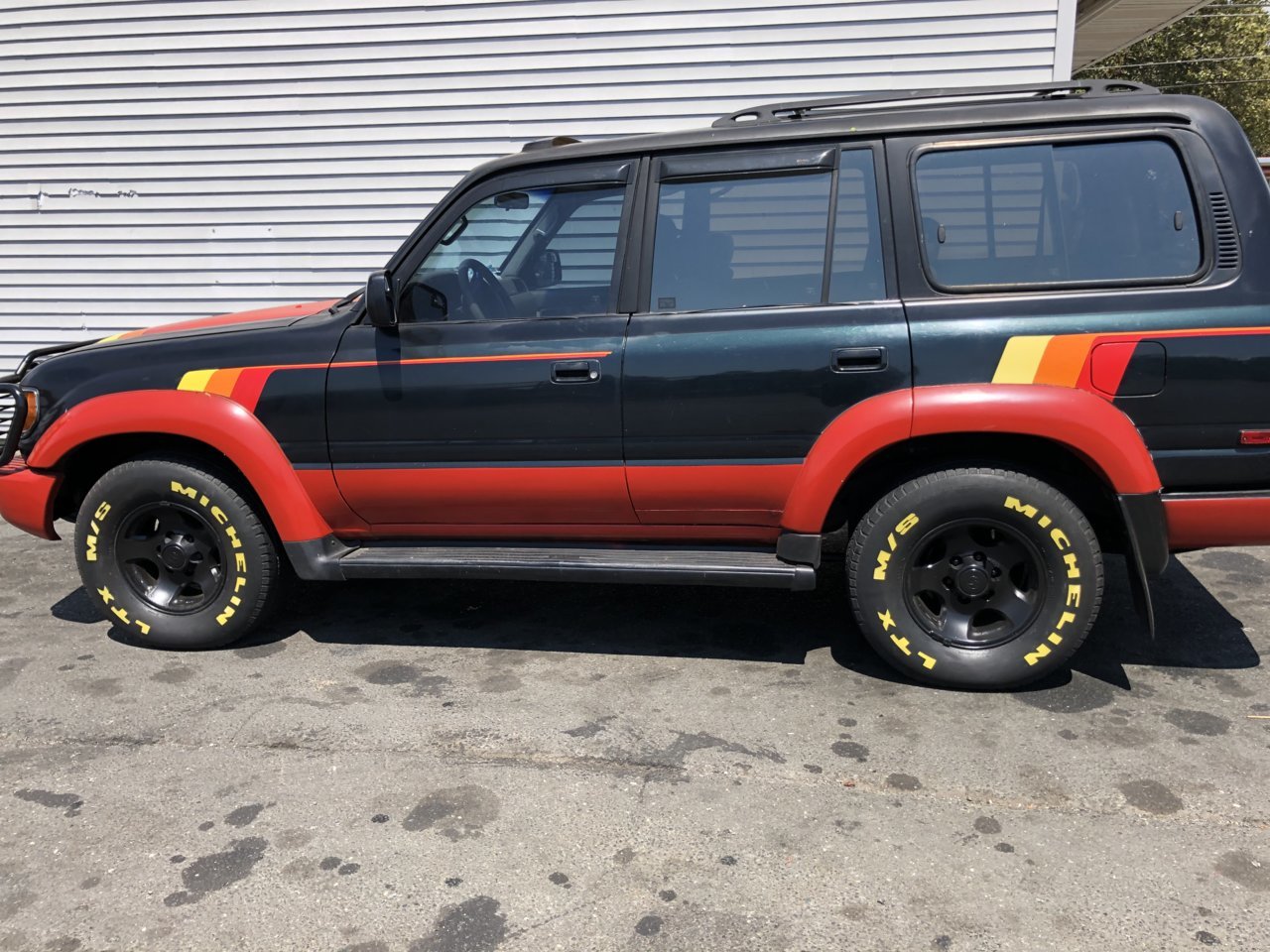

    Saw this beauty at a local gas station the other day.

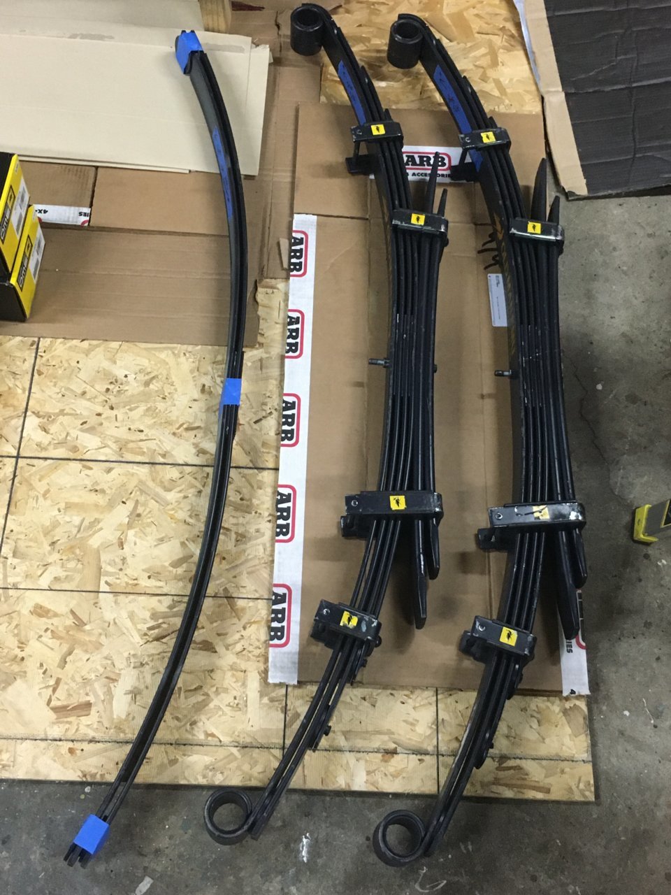

    I spent yesterday calling and looking around for shops that could set the preload on the new coilovers. Apparently its not easy to do on the BP-51’s because the size of the shock in the coil creates clearance issues. They reccemend a Branick style compressor and their 60 dollar adapter tool. Called two shops from ARBs “find a shop/retailer” based on my zip code and both said they no longer deal with ARB/OME, and cant set the preload on my coilovers.
    Also saw that EVP in Danbury was a shop on their list, as well as Main Line Overland. Called EVP and they thought they might be able to do it, but I sensed some hesitation. Im not bad talking EVP here, just not sure I want to move forward based on the hesitation I sensed.
    Called Main Line Overland in NH and they said they couldn’t do it by the timeframe I need (8/31); I was fairly annoyed because it probably takes all of 45 mins and you cant possibly fit me in within three weeks?
    After some additional research, I found a thread on TW where some people had success in compressing the spring with a $100 Macpherson compressor they got off Amazon. Ordered and will be here in the timeframe I need. https://www.amazon.com/8MILELAKE-Macpherson-Spring-Compressor-Interchangeable/dp/B01DP2CDJU/ref=aw_pd_cart_vw_crc_1_1/140-5345062-6255151/ref=trb_chk_auth?_encoding=UTF8&pd_rd_i=B01DP2CDJU&pd_rd_r=5a3a24e5-b10c-4aba-8c2d-fbdff01cd75f&pd_rd_w=qMH3p&pd_rd_wg=v6R93&pf_rd_p=62b82e01-5daf-47f0-b95c-15c24a9dcfdf&pf_rd_r=QYS99WJ2B93C9D89K3DW&psc=1&refRID=QYS99WJ2B93C9D89K3DW&trb_auth=1&trb_open=1&trb_bid=buy-now-button&serial=
    Already split the leaf packs and pulled the third from the top to make them medium packs. I ordered HD packs because I eventually plan on running a rtt.
