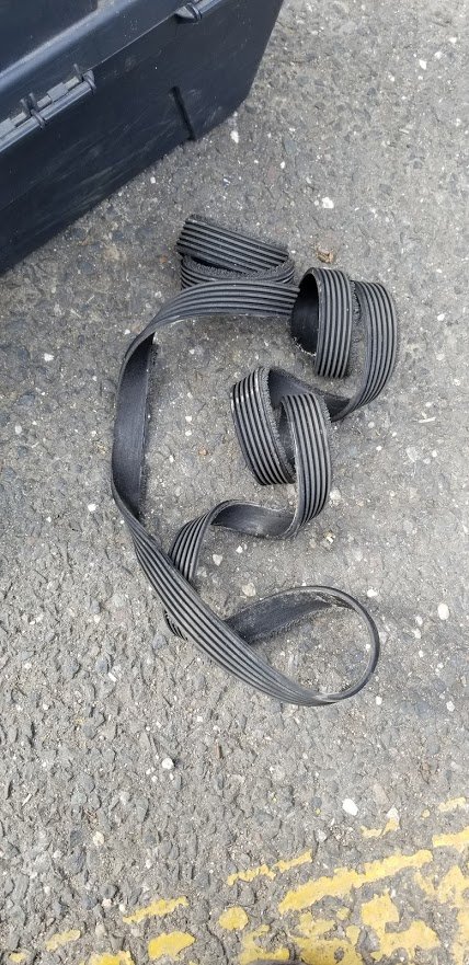

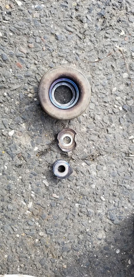

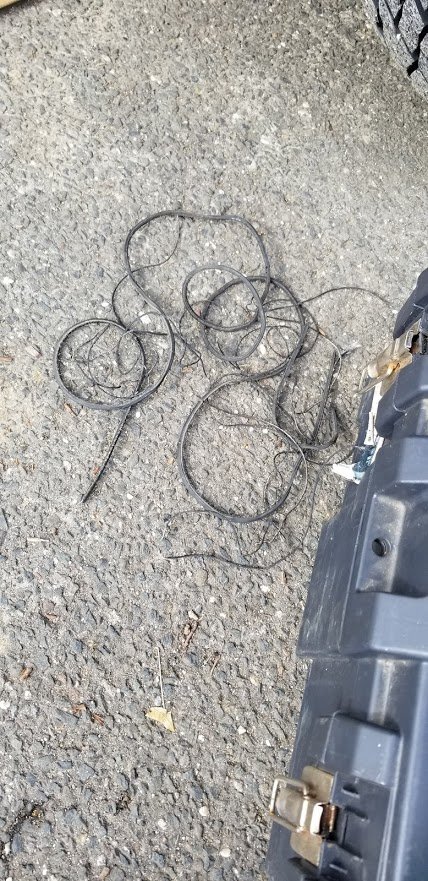

    You all may have seen me post the last few months about a noise I couldn't track down, a screeching from my engine bay. Originally I thought it was the alternator, but narrowed it down to the idler pulley right by the alternator. Ordered a new Gates pulley, and it arrived like 2 weeks ago. Except it's gross and cold, and I don't have a garage to use. So I figured "Ehh, I'll do it eventually"
    Saturday night, the girlfriend and I go out to dinner for an early Valentines, since Valentines day is my birthday and we were going to celebrate Sunday. We go to The Mill on the River in South Windsor, about an hour from her place. Dinner was good, she's an adventurous eater but hasn't been exposed to a ton. She tries escargot and seared sea scallops for the first time, both were delicious. I had a Johnnie Walker Gold, was not impressed. Too peaty for me
    Anyways, we're coming home and that pulley is SCREAMING. It comes and goes though, so I wasn't concerned
    Well, about 2 miles from her house, my battery light comes on. I have snapped enough serpentine belts to know what that light means. Turn off the stereo, crank up the heat, and try to get as far as I can. Fortunately I was able to get to her neighborhood before the temp gauge got way up there. I hiked up to her place, printed out a quick explanation of why I took someone's assigned spot, and drove her car down to pick her up. When we got back, I ordered a new belt to pick up the next day.
    Thank goodness the weather was pretty nice, I enjoy the cold and was pretty comfortable in jeans, a t shirt, and a new long sleeve Carhartt shirt she just gave me. Drop my heavy-as-shit SOS front skid, and rip this stupid belt out
    Once I was done there, I grab a pair of pliers and get to work on the massive knot that has been created around my fan shaft, and rip this shit out
    Finally, I get to work on the pulley. I spin them all by hand, most of them are good. I'm going to replace them all probably this weekend though. So I go to spin the bad one to see how bad it is, and find it just fucking exploded the right before.
    I'm guessing it's that weird purple color because it got so damn hot from the friction.
    Fortunately everything went smoothly. By far the hardest part was taking my skid plate off, which I am leaving off until I do the other pulleys. So on my birthday, I got to wake up early and go fix that stupid pulley and belt

    @Checkers10160
    I'm close to changing out my belt due to time not mileage.
    What belt did it get for replacement?
    Stock or Bando or something else ?
    Thanks

    Tom, I went with the Gates Micro V Part # K070834. Partially because O'Reilly's had it in stock, but also because I've heard good things about Gates' pulleys, so I figured their belt would be good too. I used the video below to help me, getting it over the fan was a little weird but not too hard. It's literally
    1. Use a 14mm socket and wrench to push the tensioner out of the way
    2. Stick something small in the hole below the tensioner pulley to pin it out of the way. I used a drill bit
    3. Slip the belt off
    4. Put new belt on
    https://www.youtube.com/watch?v=ZKq3FBsvFsI
    Below is a diagram from TW showing which Gates pulleys are needed, if you're interested in changing those too. Amazon has them cheaper than local auto parts stores
