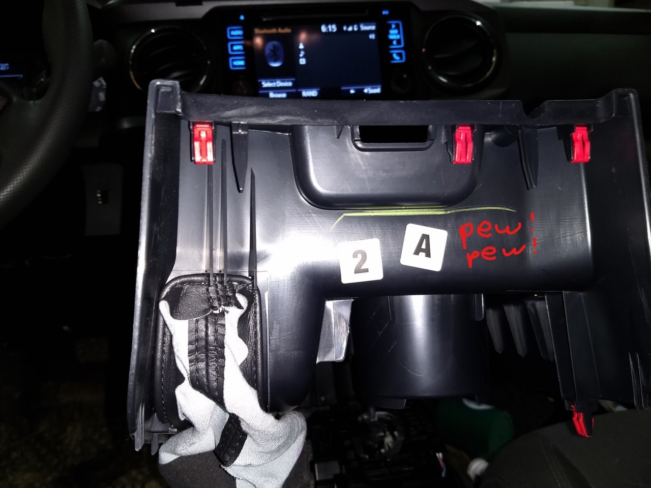

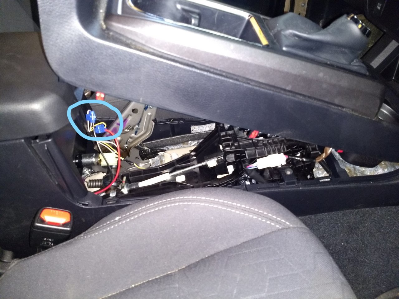

    Back seat USB ports mod complete. Easy as anything. Would have taken me 2 hours but only took 30 minutes thanks to that mechanic buddy.

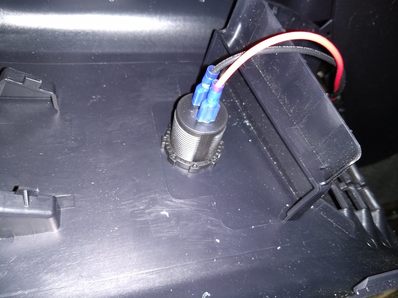

    I used the template for the hole to make it perfectly centered. *** USE A STEP BIT *** You can find it on the last page of the official installation guide. I'll link to it when I find it. (It's at the bottom of the post now.)

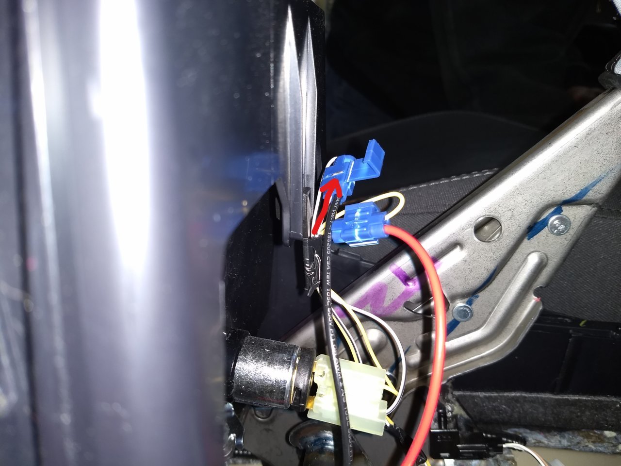

    Guide the wires through the right side and used vampire clamps to get power. The guide says t-taps, but this is what I had on hand.
    You can test for positive connections using a multi-meter on the top here, before you snap the cover down.
    Looks like someone at the factory is a secretive gun nut...
