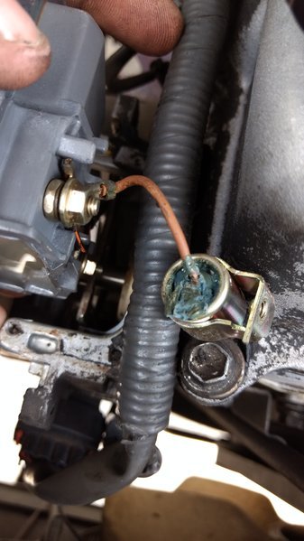

    So I'm having an issue, my truck is a cobalt blue Pearl 1995.5 Tacoma single cab, 2.7 5 speed 4x4. The issue is that as I'm driving, in a certain rpm range it starts spitting and spuddering. It's a base model truck so not tach, but I could assume it's around 2000 rpm, and it only does it while I'm driving, free reving is not effected. If I floor it as it starts spitting around, it seems to get a bit better, but not alot, I'll list what I have replaced so far...

    And some other things I'm not remembering right this minute. I have taken the distributor apart and have found what looks like the resistor is melted? I'm not really savy with distributors, but the one wire coming out of the resistor should be to the ground? Or the 12 volt? Any info to help me fix this would be great! Thanks guys.

    Here is a picture of the resistor.

    If you still have an issue with this the part is not a resistor but a capacitor used to cancel the electrical noise caused by ignition. It should be between +12V and ground. My electrical diagram shows Brown wire to ground, Black/red to +12V.

    And about the ignition, I ended up replacing the whole distributor and it runs perfect now. I assume it was the pick up on the inside of it that Toyota told me was part of the distributior. So I bought a new one and stuck it on and issue gone! I've done quite a bit of work on it since then, it's coming together nicely!

    Thankfully it didn't hurt anything on the outside of the distributior, I took the chance with one of the el-cheepo ones from eBay for like 50 bucks, to see if it was my issue. It seems that it was lol
