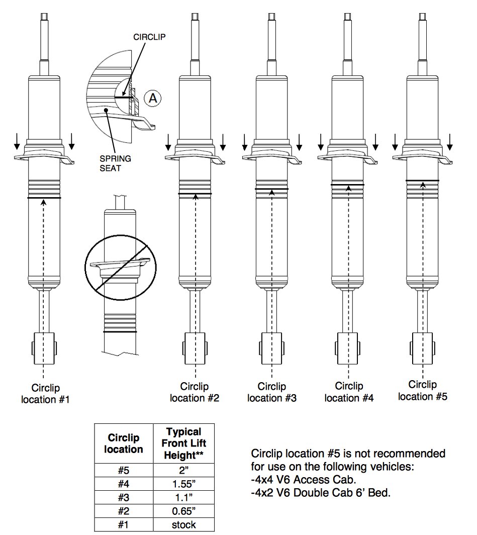

    I order 5100 bilstein shocks for my 2020 toyota Tacoma 4wd i need yor help for the right position to get 2"1/2 high passengers and driver side it's same position on notched the ring ...
    Thank. U for help ..

    Sorry guys forgot to mention i use my factory coil spring on this shocks

    If using the same springs then I believe it's the 3rd notch that'll give you the lift you need.

    Here you go!!
