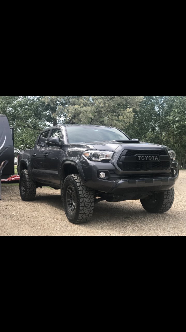

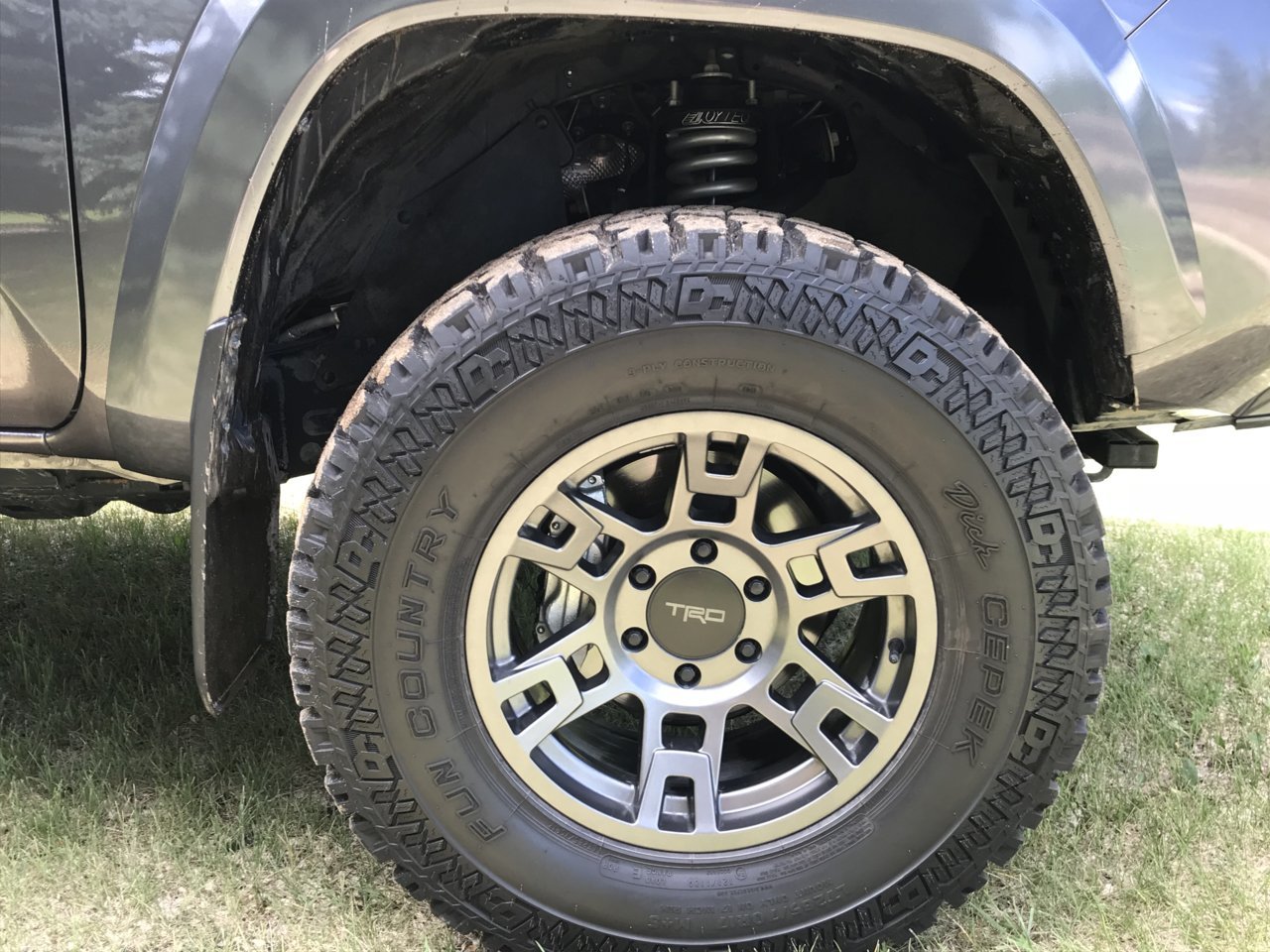

    Sooo after a year with my Yota I'm super happy with it regarding appearance. This thing turns heads wherever it goes and I love it. However, over the past year I've went on about 3 road trips about 16hrs round trip and do not like the ride on the HWY one bit. Currently I have;
    - Boss 2.0 Toytec lift
    - SPC UCA's
    - Dick Cepek Fun Country 285 70 17 Load range E tires
    On long straight roads I find that my truck follows the crown of the road and is nervous. I had an alignment about 8 months ago and it's good on straight flat roads but if crowned out it's It's annoying and exhausting after a while. I'm wondering if a front Fox or King coil over set up along with a tire change to a better quality ( Cooper/Nitto/BF Goody) would transform my nice ride into more of a hwy cruiser??? Could it be that my front coil overs are cranked to high? This is my first experience with a lifted Tacoma. I bought the truck the way it is and would spend the $ to get it right but wouldn't mind hearing what you guys have to say... Thanks in advance for any advise. Very much appreciated :hattip:

    Well, glad I never sold the Yoda... E load rated tires are for 3/4 - 1 ton trucks. I threw on a new set of Nitto G2's 285 70 R17's P rated rubber and couldn't be more happy. It's like I'm driving a different vehicle. Very impressed! Handling, alignment, ride quality, road manners, power, MT shift smoothness, gas milage are 100% better than with the fun country. Highly recommend Nitto G2's for tire upgrade if looking for city/hwy comfort and performance. Cheers folks, I have a new truck all over again :woot::yes:
