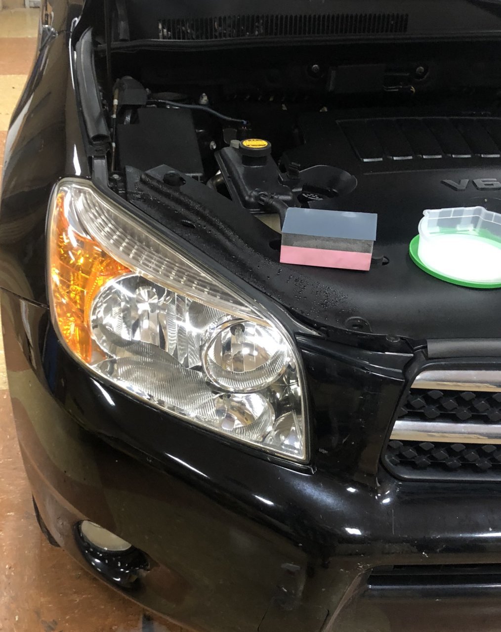

    #149703
    1,510
    I’ve done 3 sets of headlights so far with it and have been totally amazed with the results. You would need some polishing pads and either a drill with their attachments or a polisher/buffer. They have some videos on the link that I posted showing exactly how to do it

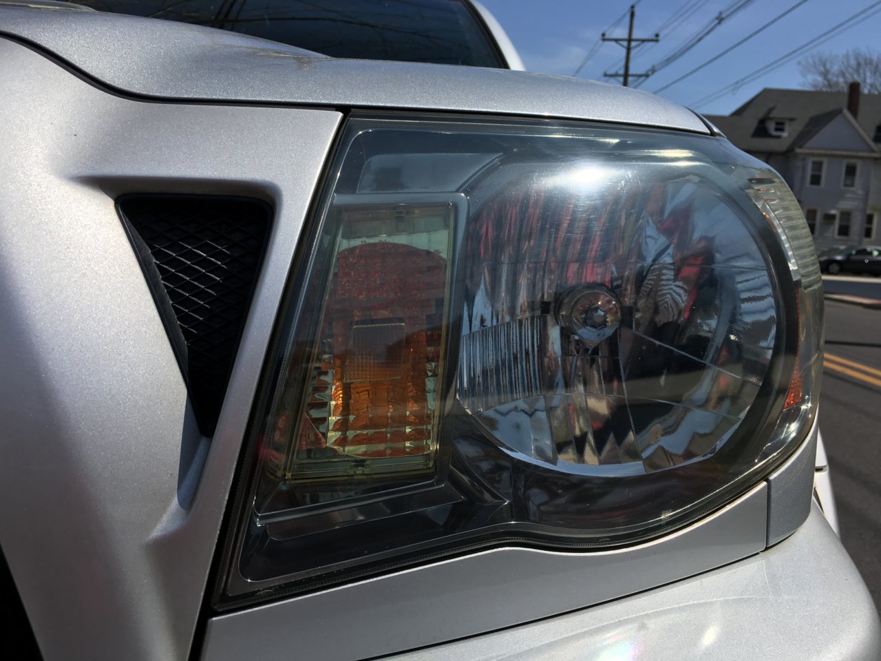

    I have successfully used the Turtle Wax kit for headlights. It was about $ 15 and did a good job. The whole process for the two headlights took about 20 min.
