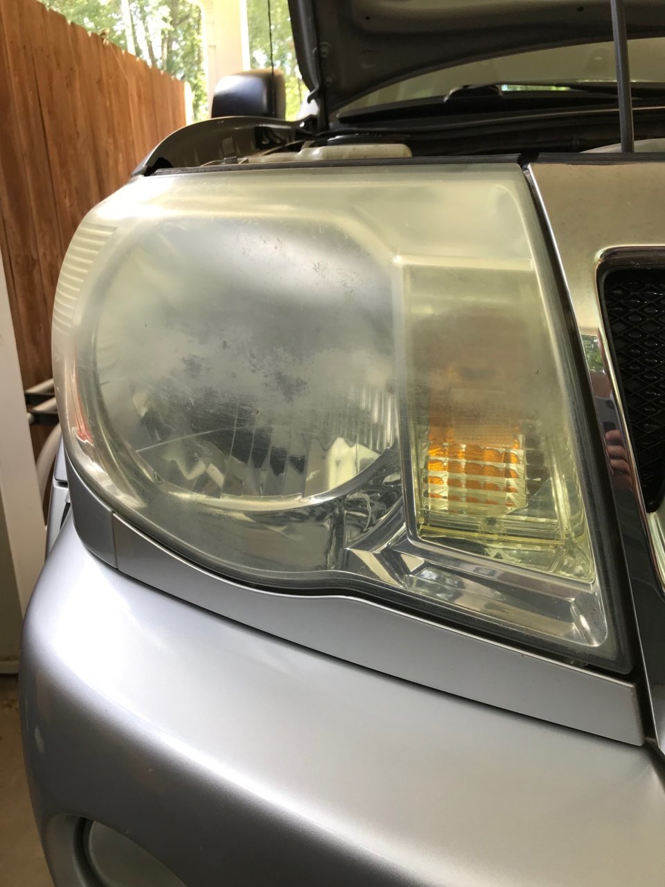

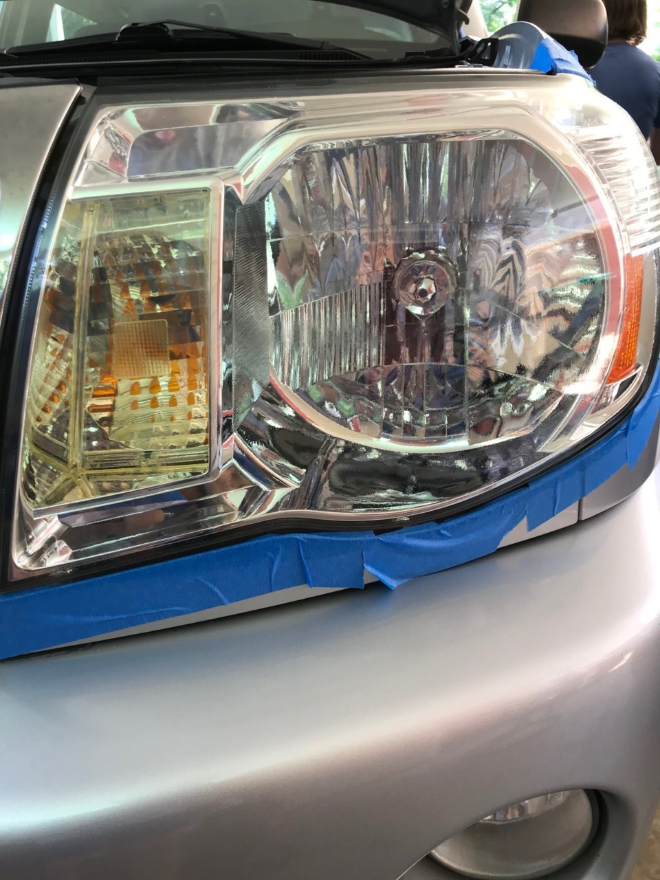

    I bought a cheap Armor All kit from Walmart the other day- before:
    After:
    It comes with UV sealant wipes...if i can get a few months out of it then i'll be happy.

    Yeah, thanks. I've just been curious why the OEM lasts for a long tine and the DIY techniques seem to need redone more frequently. If true what are they doing different? I suspect you are right.

    I’ve done this as well, and the results were surprisingly very good! I used the headlight UV coating I had from another kit instead of wax, though. 6 months later and my headlights are holding up nicely with minimal “maintenance.”

    I did the whole sanding and buffing kit , not sure from where , on my wifes Odyssey . It looked great for about four months then it started fogging up again. Im trying the ArmorAll wipes next .

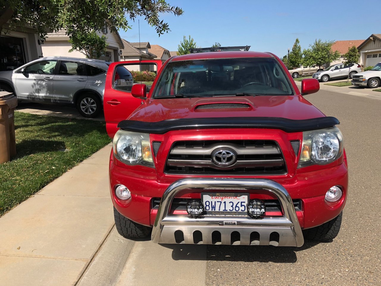

    Here’s a pic of my lights 2 1/2 years post Meguires Heavy Duty Headlight Restore. I just go over them every couple months with UV protectant.
