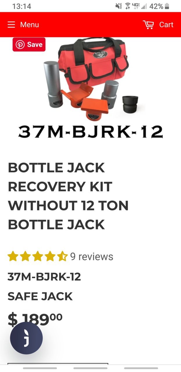

    I had an old 12ton bottle jack laying around so I bought the accessory kit from safe jack and keep a piece of 2x12 in the bed for a larger stable base. It worked well in the sand, haven't had to use it in any other terrain yet.Screenshot_20200225-131403_Chrome.jpg

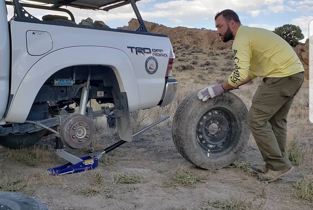

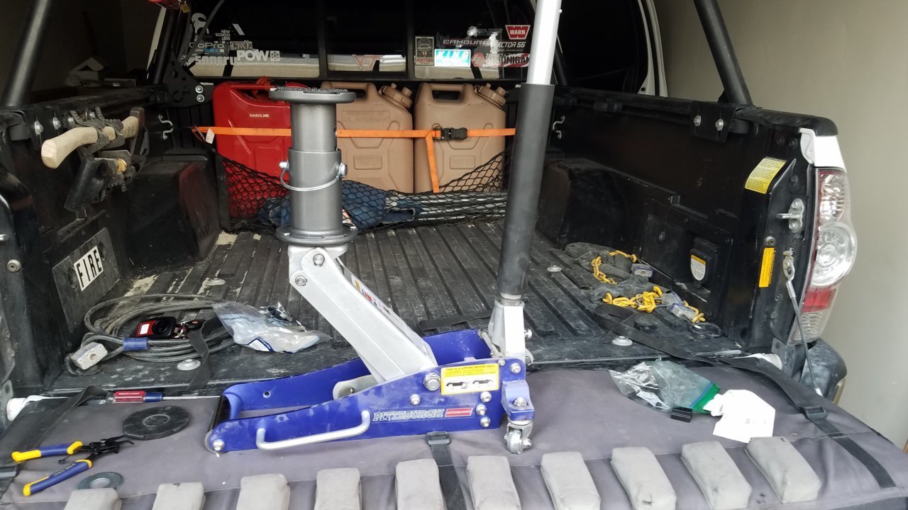

    You mean like this? I have a writeup in my build thread linked below that details what you need to do.

    It dropped right in on the HF jack. You just need a big fender washer to take up some slack between the new base and the jack arm since the pad is thinner on the PE. Light tap with a hammer to get the pivot bolt back in and you're g2g. Swapover takes less than 2 minutes.
