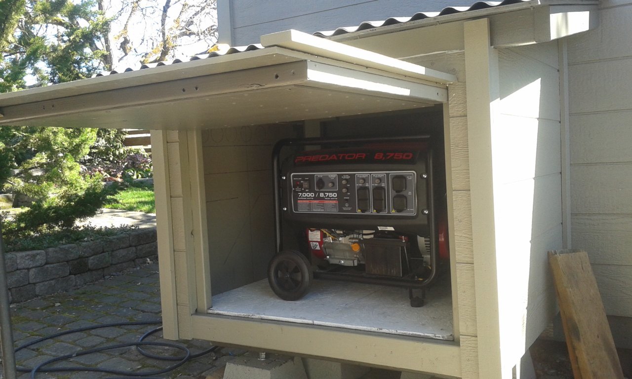

  5. Mar 15, 2019 at 12:52 PM
    #25
    windsor
    windsor [OP] Just a guy
    Dec 31, 2014
    #145322
    7,689
    Homeless in Oregon
    2008 Tacoma Super Duty aka Tundra
    Canopy, fitted seat covers, OBA with self leveling air bags, 100w solar, dual Rhino Rack Pioneer platforms, side & rear LED work/FU lights, CB, cell booster. 7x16 cargo conversion, 3" lift, 7'x6.5' fold down aluminum rear deck.
    Little bit of work on it. Adjustable base to level the shed. I will be working on sound reducing, intake/exhaust/heat venting later. But, it fits and is accessable once inside the box. I will hardwire it to the transfer switch and put a couple outlets on the wall.
    Edit: I am going to remove the wheel kit and bolt it to the 4x4 supports after I make the sheet metal floor panel. I will have a hole with a funnel under the oil drain for easy servicing. I am going to remove the muffler and make a new exhaust pipe to run outside the box to the muffler which I will mount outside to reduce the heat inside the box.

    You have air in and out for cooling, or is it only run with the door open? Gensets put out a lot of heat running.
    My 10kw diesel would shut down in the shed until I put an extraction fan on the outflow...plugged into the genset through a barn thermostat so it runs as soon as the unit is running and has warmed up the gen shed.

    Yes, I put an exhaust fan in the ceiling of the box with vent on the side under the eave and a 12x18 inlet in the back wall pulling air from inside the shed.
    Havent finalized the wiring yet, but will put a small auto battery inside with a switch to the fan and another to the LED light strip I put in the box.
