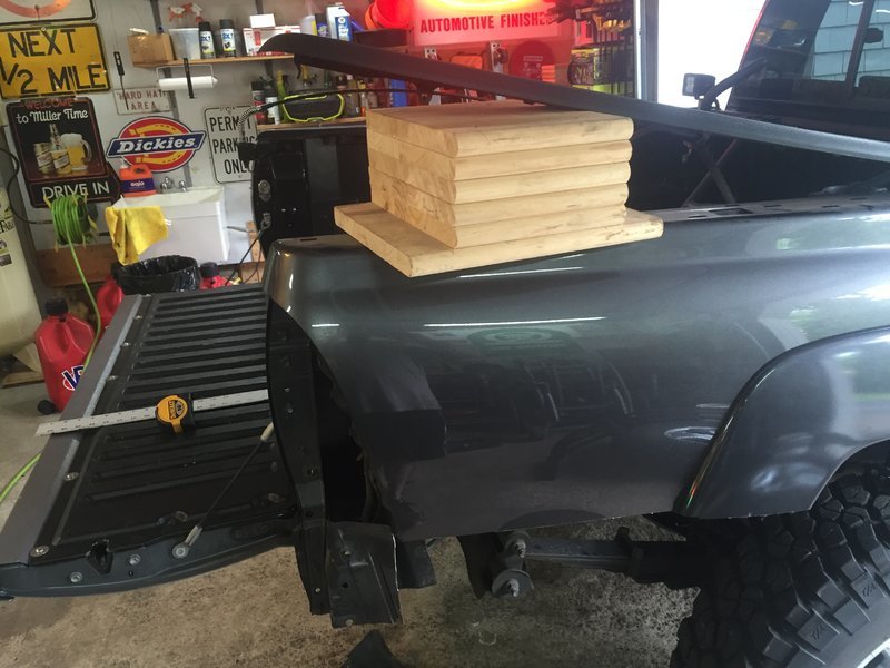

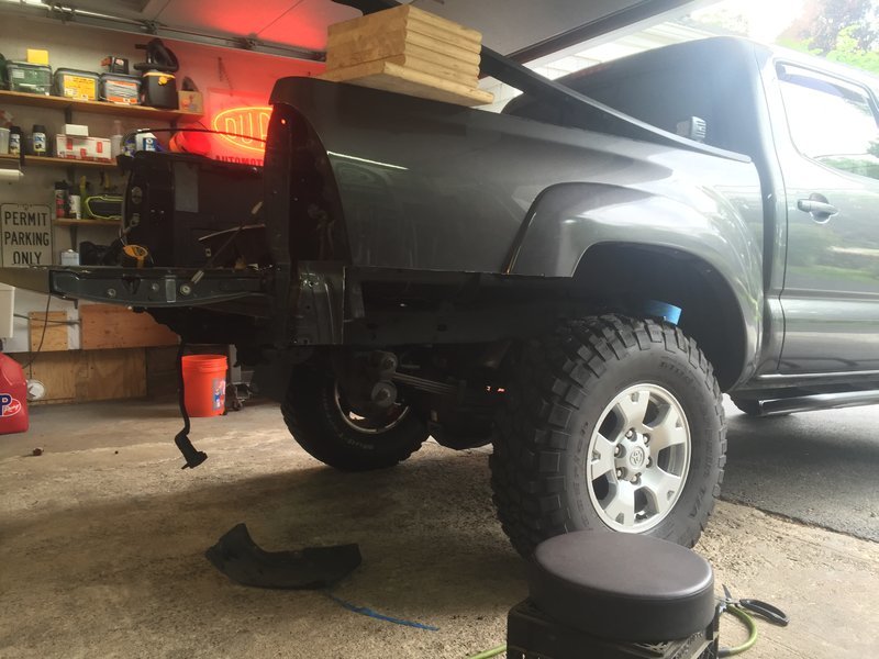

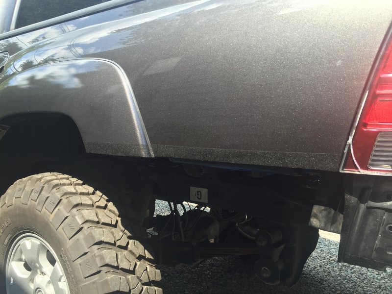

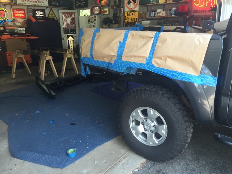

  9. Jul 17, 2016 at 12:47 PM
    #49
    HolyHandGrenade
    HolyHandGrenade [OP] NOOB
    Mar 25, 2013
    #100579
    11,800
    Tim
    Garage Most Likely
    DCFB (RIP)
    Some Stuff
    Both sides cut
    To seal the cut line I decided to paint one inch up with the same spray on bed liner that I painted the bumper with.
    Another bonus is that I think that one inch being the same color will make any imperfections in my cut harder to pick up...
    Now I'm just waiting for some help lifting the bumper into place.
    Since I had the bed liner out already, I also threw a couple coats on my tire carrier and antenna mount.
