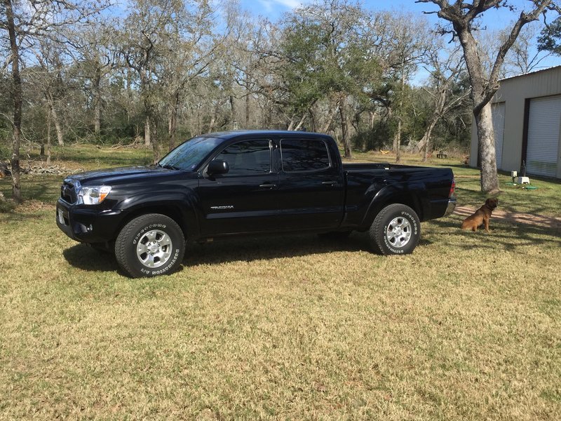

    I have a 2014 crew cab long bed taco. I want to run bilsteins in front set at 1.75 and a top plate spacer 1/4". Is anyone doing this? How is the ride and any issues? Thanks in advance!image.jpg

    I changed lift plan and couldnt be happier. I used the toytec 521600 springs,with two 1/4 top plate spacers. I added toytec 2.5 add a leaf and bilstein 5100 in front at lowest setting. Just got back together tonight. Test drive was very nice without any alignment. Plush, like factory ride, not stiff!!

    I gotcha! Im gonna post pics of mine later.
