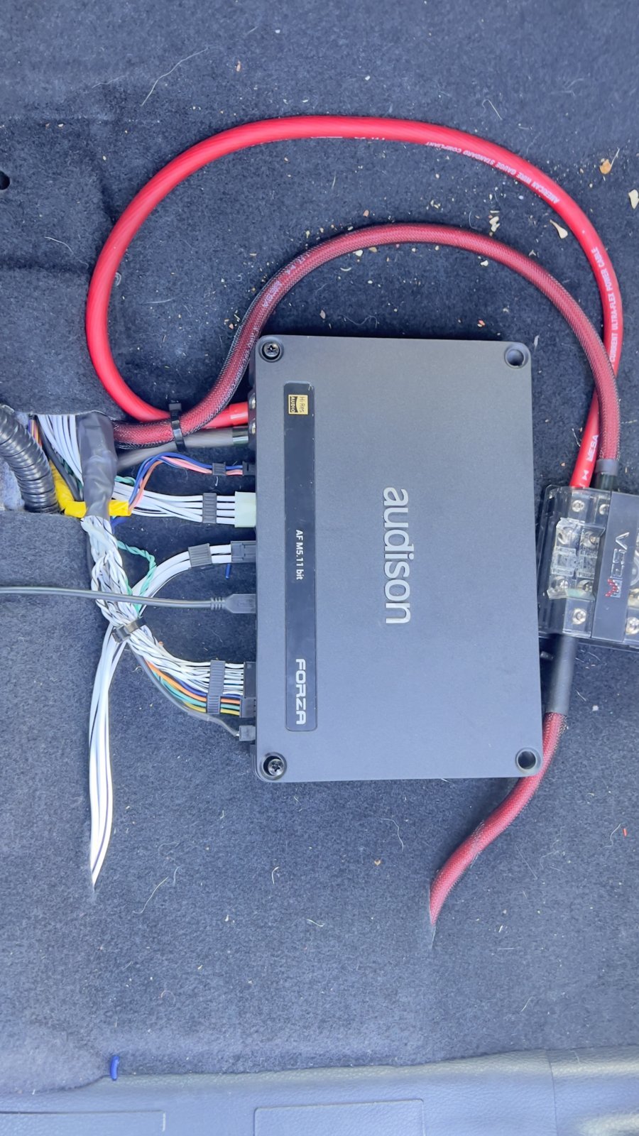

    As I promised on another thread to post once I would complete my system

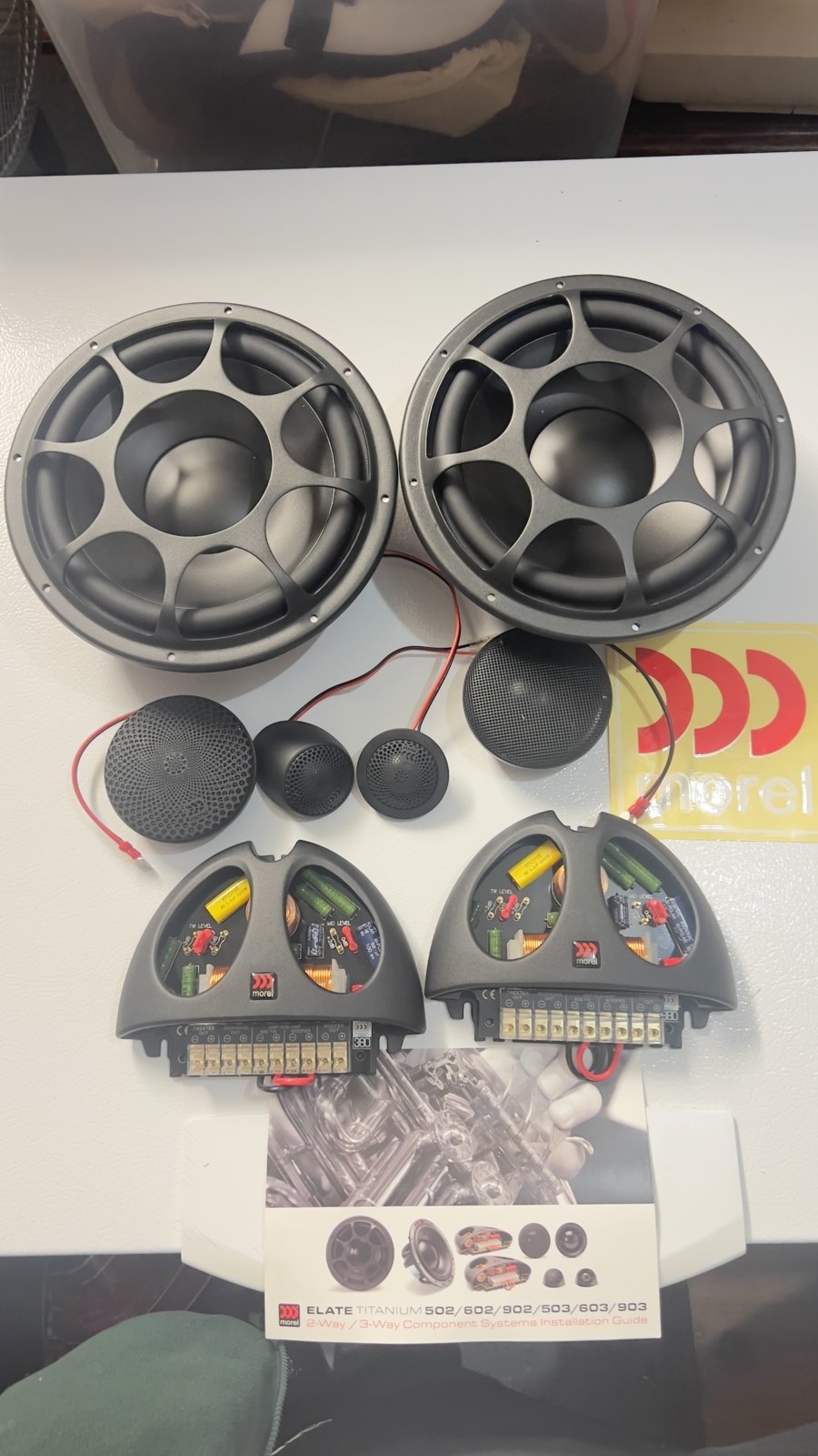

    I’m using the 903 titanium Morel 3 way system, Audison Voce Coaxial speakers for rear fill

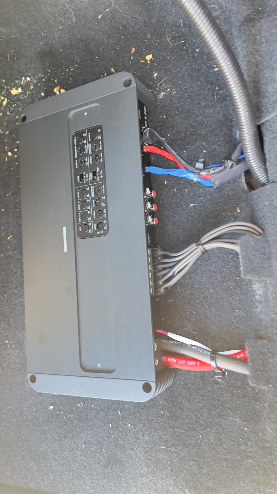

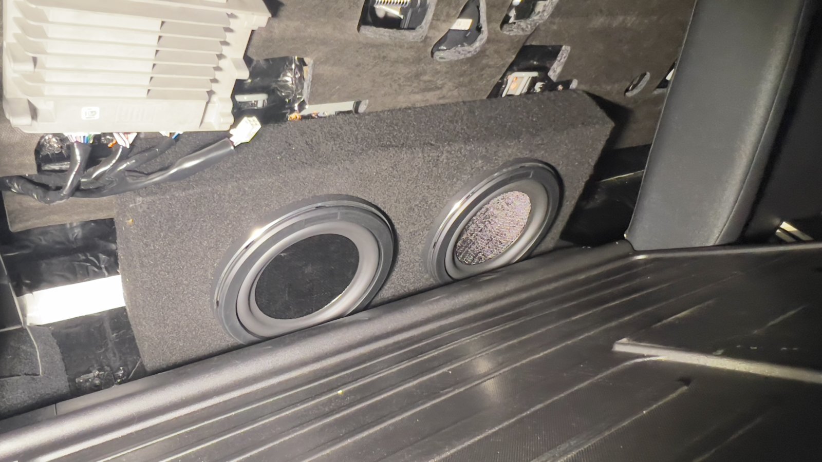

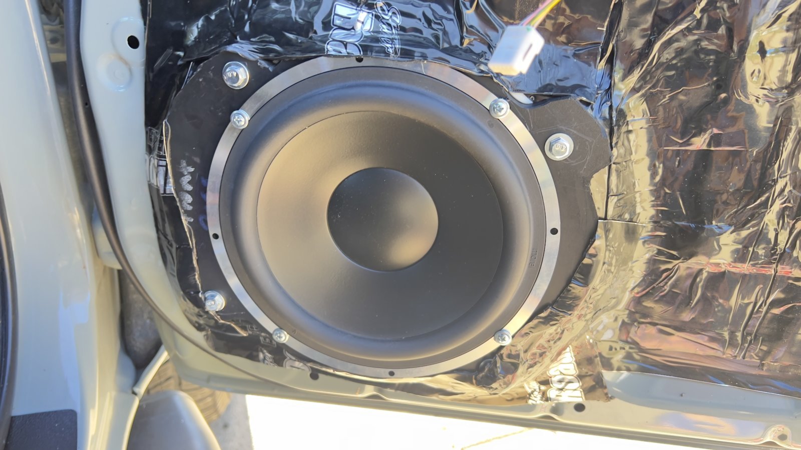

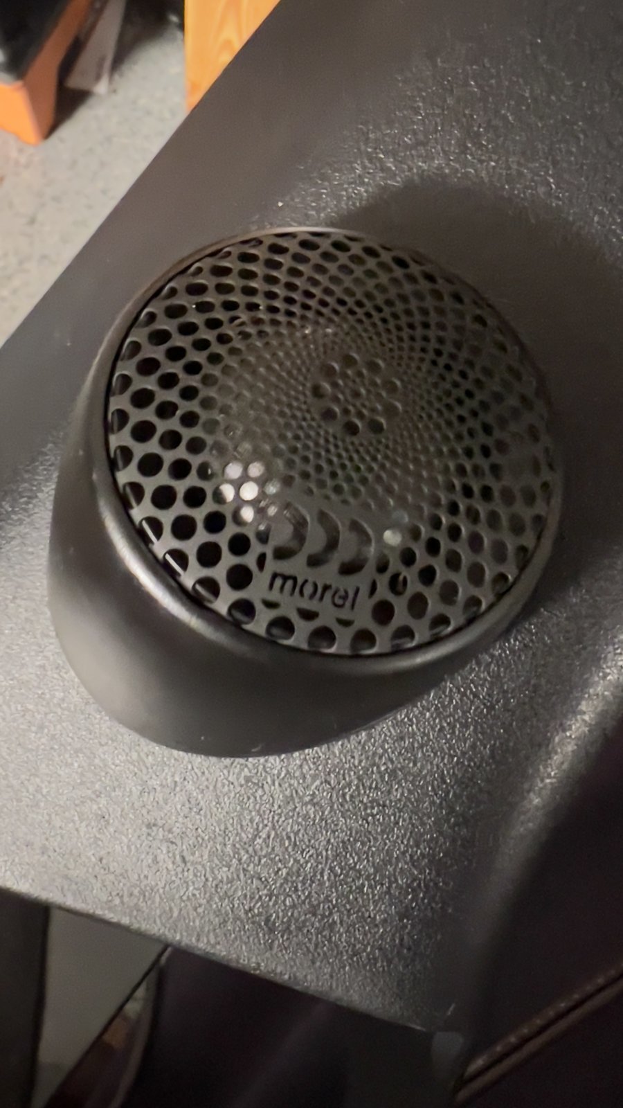

    And 2 8 inch kenwood exelon bass drivers. The amp Audison AF 5.11 Bit is driving 2 of the 9 inch mid bass drivers mounted in the front doors in bridged mode with around 200 watts each driver.the 5th channel is pushing plenty of clean bass power to the 2 kenwood subs, yet they are small and compact but with the amp running both subs at a 2 ohm load it is almost 600 watts of clean Audison power. The Audison 5.11 bit also has 6 DSP outputs sending a very clean deal of options to the Audison SR 6.600 despite the fact I am directing the DSP in to the high level inputs of the 6 channel amp the 6 channels are then diverted to channels 1 &2 front tweeters mounted on the a pillar with the provided angled mounting brackets, channels 3 & 4 go to the warm 3.5 inch Morel midranges mounted in the stock location of the dashboard and channels 5&6 drive the rear Audison Vice Coaxials. Much more work still left with proper tunning in the next few days but the sound is extraordinary at this point all EQ levels are set at the factory flat line or less just to cancel unwanted frequencies. As a piano player myself I’ve always struggled to hear the acoustic pianos as such and the upright bass. This set up has arrived and I can tell you the difference listening to my old songs is night and day!
    The bass coming from the 2 kenwood drivers in their custom enclosure ( super compact) exceeds the bass from even some of my old set ups like the Tw3 10s and the Audison 10 inch
    The 3Way Morel set up Makes such a huge impact with crystal clear high percussions sounding so natural, the voices from the 3.5 inch midranges are incredibly soft but with huge sound dynamics reproducing sounds I couldn’t hear before and the 9 inch mid bass add such a great bottom feeling of the upright bass sound from live jazz to some brass instruments in old band music, guitar strings (as in Keith don’t go) country music even some electric deep bass like astronaut in the ocean they are all reproduced very dynamically and is almost like listening to new tunes all the away again!
    Again I have not even touched the potential of the system as I’m pretty sure my tuners at Paradyme Audio in Sacrament CA will find a lot of flaws that may have to get revised.
    Definitely looking forward to their final touch and a huge thank you to Adrian, Joe and Terry providing their expert opinion as I was gathering materials and equipment from their shop here in Sacramento more to come I’m pretty sure but so far very happy with this set up!!

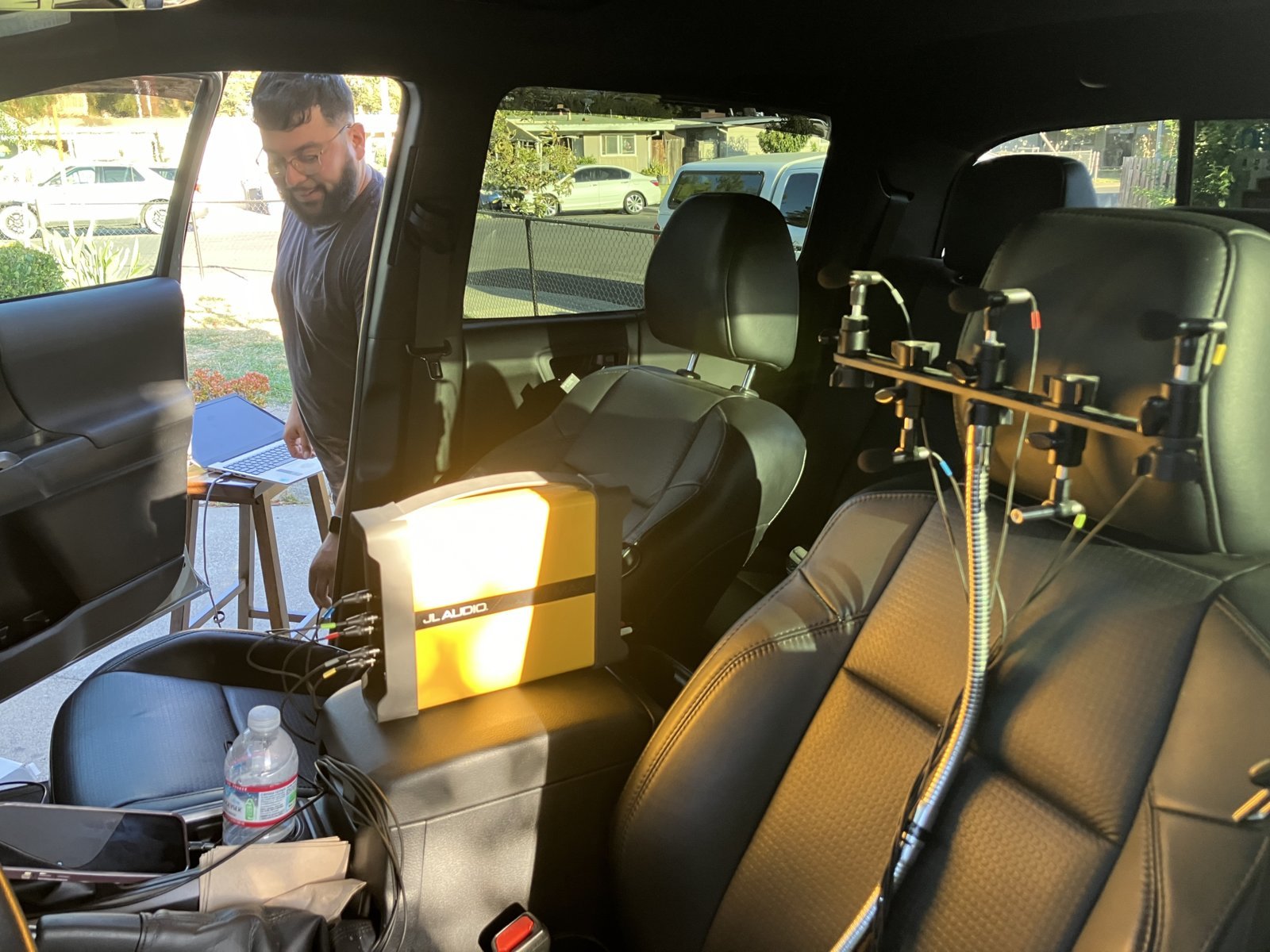

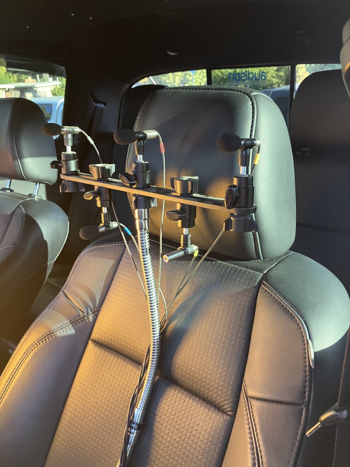

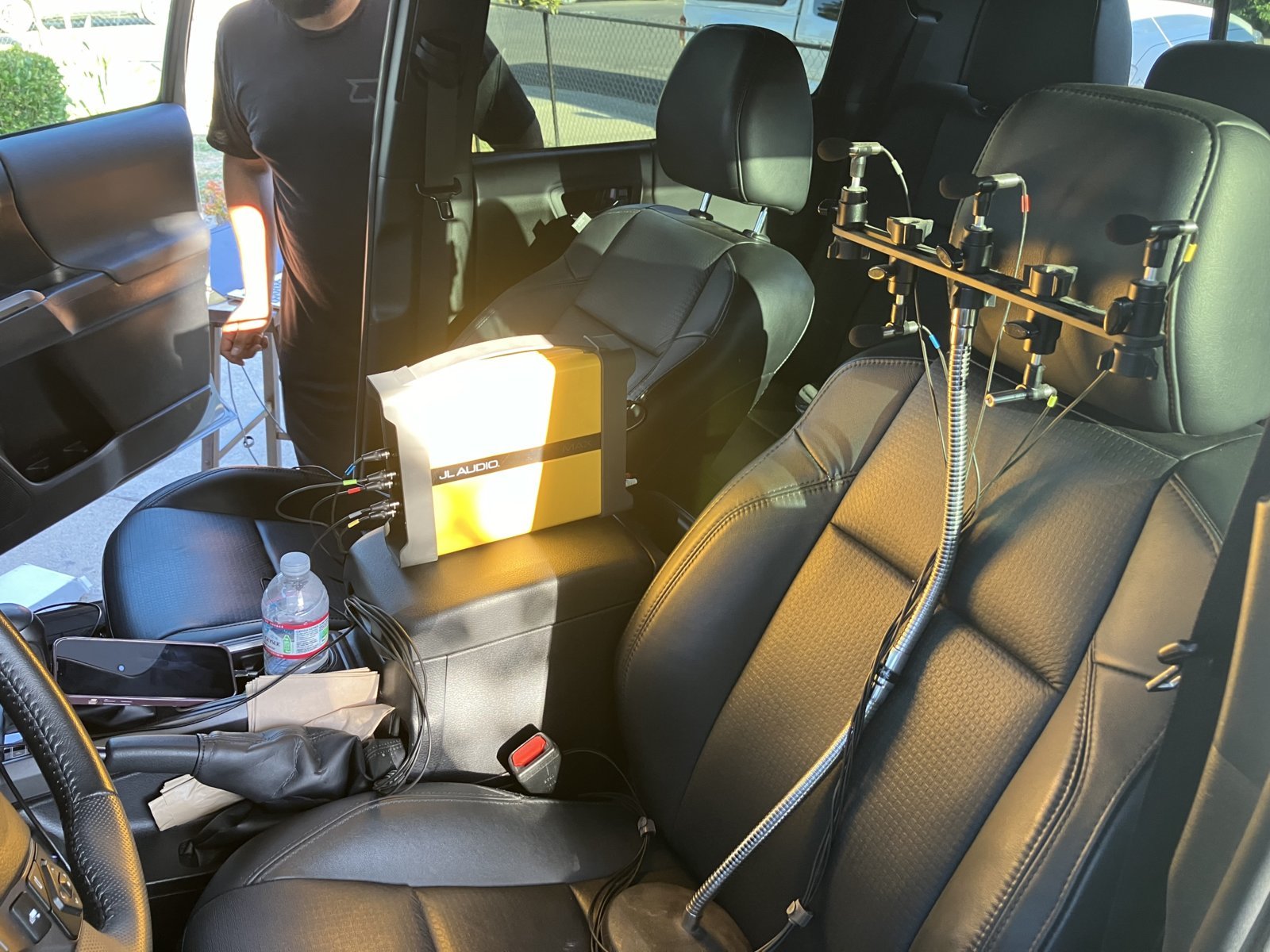

    Tuning completed
    Morel 3 way system in dashboard A pillars and 9inch mids in the doors
    Audison 5.11 bit and SR 6.600 all tuned today by Joe from Paradyme in Sacramento Ca
    Huge turn around in terms of tuning and alignment in sound!!
    Thanks Joe
