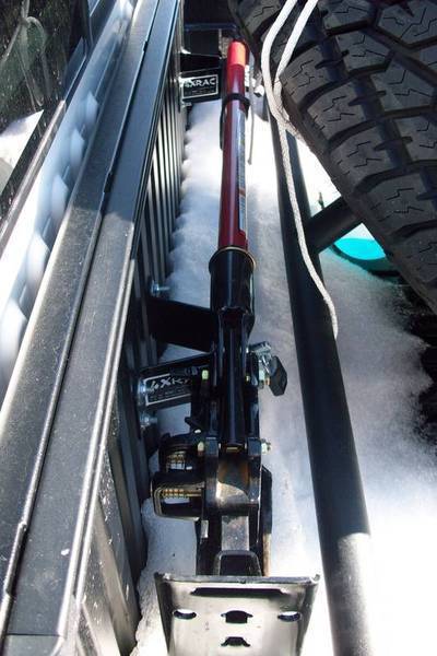

    guess i should explain a little, it was a pain to mount there but thats were i wanted it. i had to lay under the truck and reach up through to slide the bolts through the holes. As dilsky said aboout the plates, there one about 3x8 1/4 steel plate behind each 2 bolts. maybe a little overkill but hey why not! any other questions ask!

    Can you get to the back of the composite material to put the back plates on? I guess I never looked/tried. I actually had fabbed up some brackets and used the mounting rails to mount them, but the jack kept bouncing into the bed causing really bad marring on bed, not to mention it sounding like shit every time it rattled. It also seemed to put some serious stress on the rails.

    yea i had to again lay under the truck and reach up through the cab and the bed to put the plates on and bolts through. dont ask me how i managed that but i did

    I may just have to mount the jack on the side since you can get access to the back side much easier.
