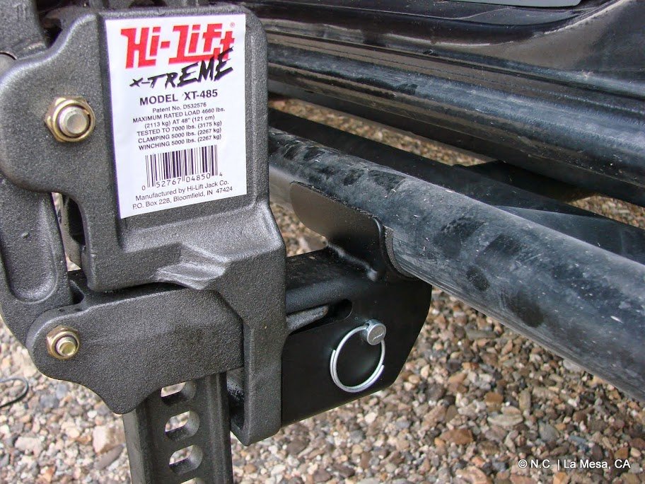

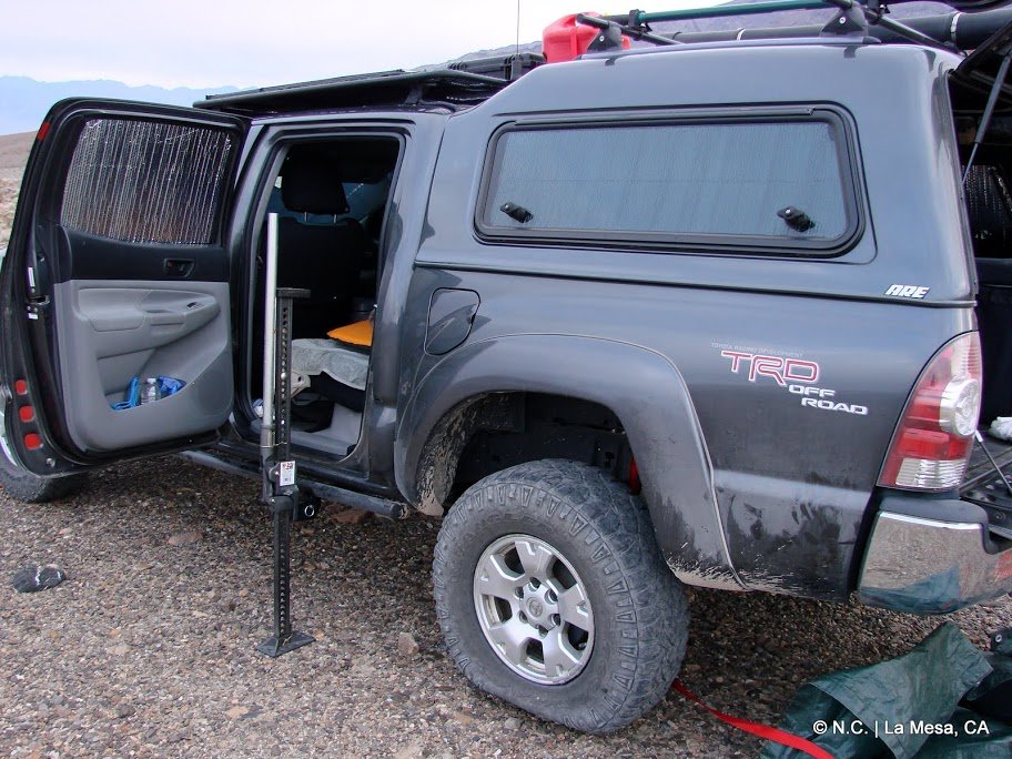

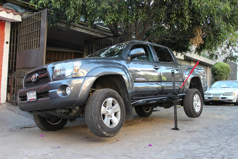

    Millions
    The above photos show how NOT to use the Hi-Lift. Owners did not read their instruction manual.
    ^ This is the right way. When not jacking the handle needs to be in the upright position and clipped to the steel bar.

    Yup, you are right!
    When I took that picture, I was in the garage of my friend who installed my sliders... I didn't know how to use a Hi-Lift and didn't own one...
    a week later I bought mine and realized that the handle should be clipped to the bar... and noticed that both of the pins go into the bar this way...
    That is why you need to put the handle in the upright position!
    Well observed, BTW :cheers:

    i always put the handle up all the way so its not in my way when walking. :p didnt even notice both pins go in that way.

    I'm still breaking the rules though. Those other guys like myself left the jack unattended which is a HUGE NO NO.
    I was by myself so instead of taking pics I should of been working fast due to my unsecured load :)
    Ive seen someones face almost taken off because they had the handle down in the release mode. His face was about 1/4" away as the handle flew up at supersonic speed.
    They don't call them widow makers for nothing. I'm not proud of it, but I have dropped 3 trucks using a hi lift - each time was due to improper use. If you have some common sense and follow the rules these jack are safe. If you don't follow the rules are are a dumb ass it's time to increase your healthcare coverage and life insurance.

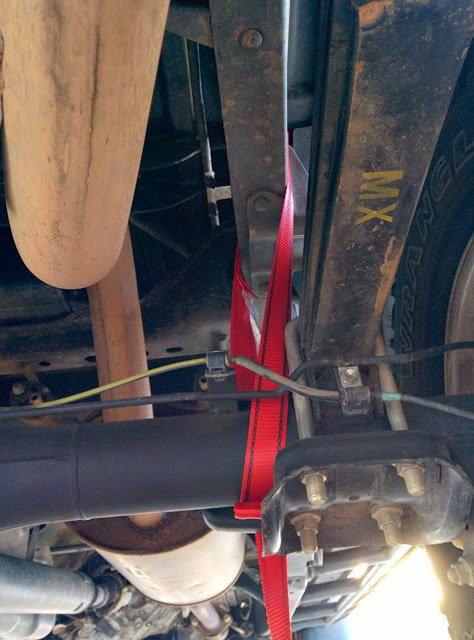

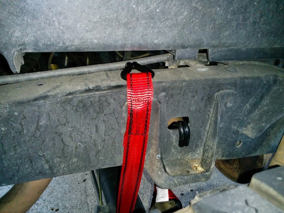

    Old thread, I know, just thought I'd kick it forward.
    One of the nice things you can do for yourself if you have to change a rear tire off road is to strap the axle to the frame. That way you don' have to jack through all the suspension travel. I use a properly rated ratchet strap to do it. It works great.

    Or two cheap homedepot ratchets.... :thumbsup:
