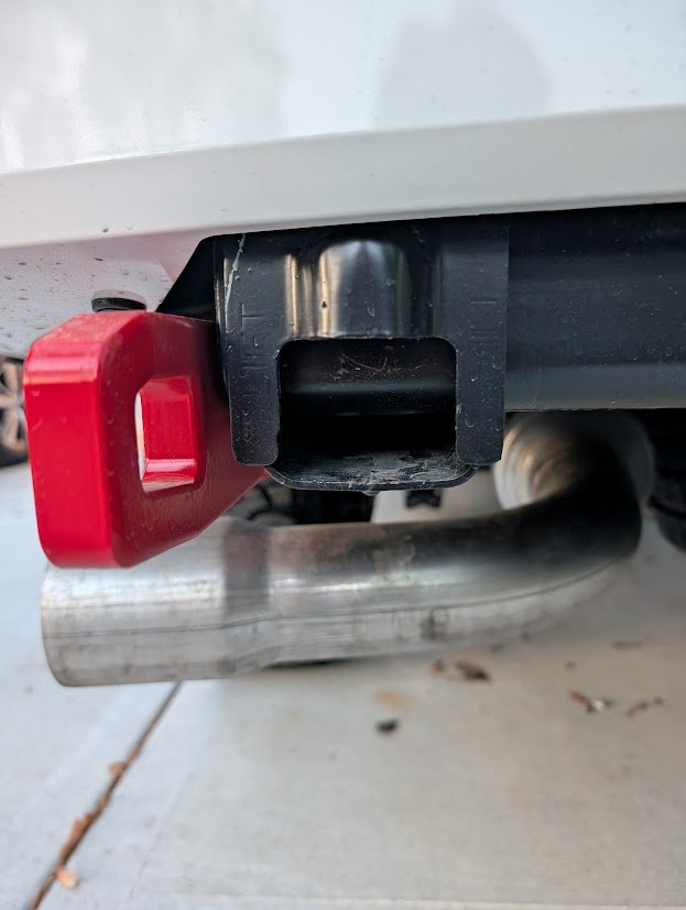

    I have a Hi-Lift jack and just bought a 25 Tacoma. Can you actually jack the truck up and change a tire with a Hi-Lift jack? Is the square box under the rear bumper in the enclosed pic a jack mount? I don't see any possible way to use a Hi-Lift on the front of the truck. I owned an FJ and there was no way to use it on that.

    Usually there aren’t any ways to use a high lift jack on modern vehicles. Aftermarket front and rear bumpers and rock sliders are where they are generally used
    However, Toyota did put in those rear points specifically for a high lift or high lift style jack

    Sliders, I tried to use a high lift once on a 4runner via the rear hitch hole and it puts the jack at a weird angle that I wouldn't trust. Sliders is your best option and its pretty stable. Invest in a base for the high lift, and dont trust it alone if any of your body parts are going under the truck.

    I think the only possible hi-lift jack point on a stock tacoma would be the trailer hitch receiver. But as others have said, hi-lifts are most appropriate for situations that the factory bottle jack (or any other jack for that matter, blocks of wood, tree stumps, rocks, boulders, small children, etc.) isn't available to use.
