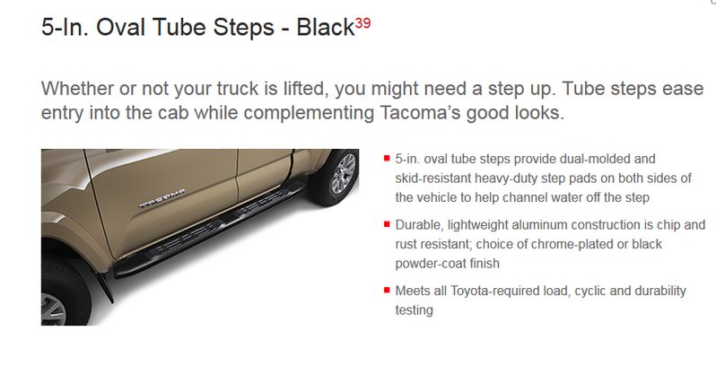

    Trailer Hitch Cover - Star Wars Pulp Fiction Boba Fett & Stormtrooper
    I assume these can't be used as jack points?
  8. Jan 11, 2017 at 10:08 AM
    eccracer104
    eccracer104 O.G. Member
    Apr 9, 2008
    #5854
    14,170
    San Diego, CA
    2016 Tundra 4x4
    Correct. Tube steps can't be used as a jack point. Frame mounted sliders can be. You need a jacking point strong enough to support the weight of the truck.
