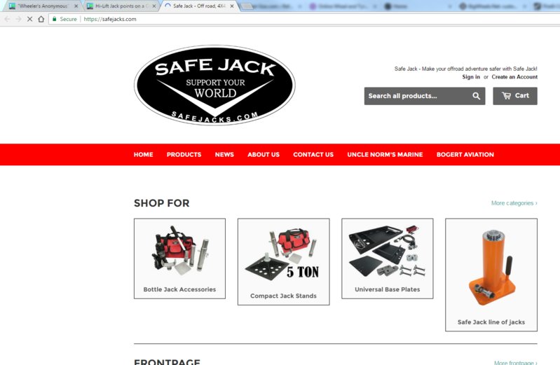

    So carry a safe jack to lift the frame and also carry a hi lift to use as a poor man's winch?

    I tried going to this site at work, and "safejacks.com" is blocked for being an adult-oriented proxy. Hmm. I wonder why?

    It's legit
