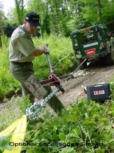

    Actually, I have one of these but didn't think to use it for this. I need to try that!

    Yeah, they have their place. Can bend stuff back with it too, like if you bend a fender into a tire. But I agree with the dangerous part. I don't use one unless I need it. At home, floor jacks and jack stands for sure.
