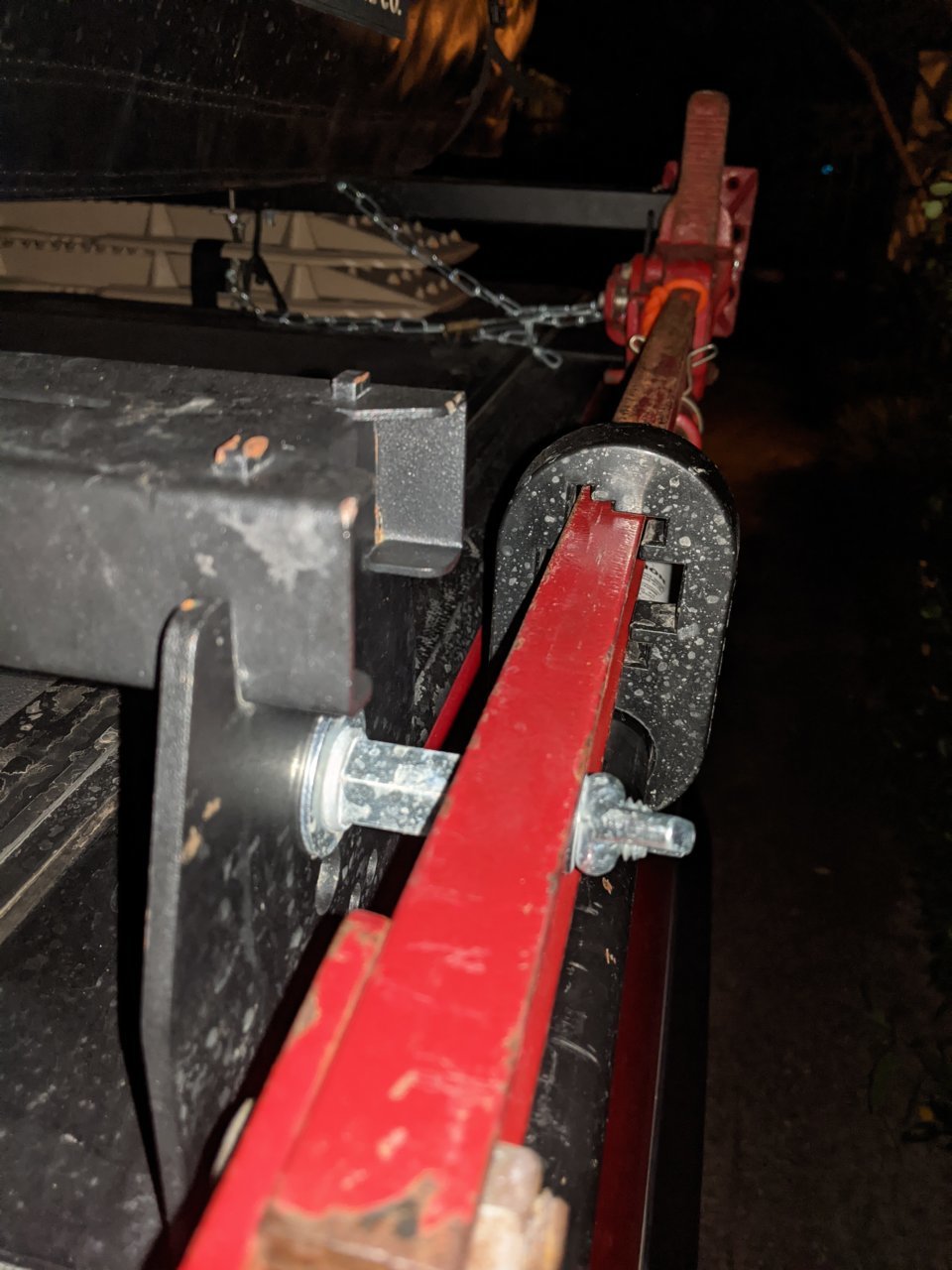

    I ended up making my own. Obviously, not difficult, but I would have preferred to just buy it pre-kitted and possibly in black. I don't remember everything exactly, but it's all 1/2". I cut the hex standoff down by roughly 1/2"...probably leaving 1-1/2". 3-1/2" bolt. Lock washer and flat washer against the rack, same against the Hi-Lift. I can get better pics tomorrow. Took this through 7 days of trailing in CO. No issues.

    Nice work! Oddly enough, I looked at a few JK hood mounts and thought it might work too. Decided to go the Home Depot route, but that looks nice.
