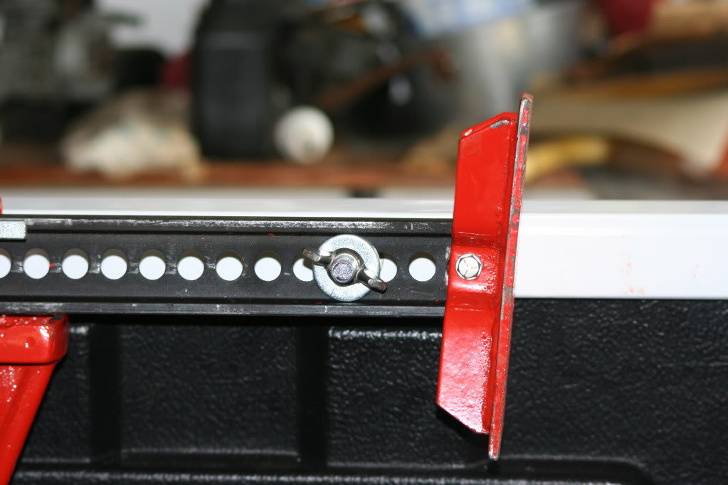

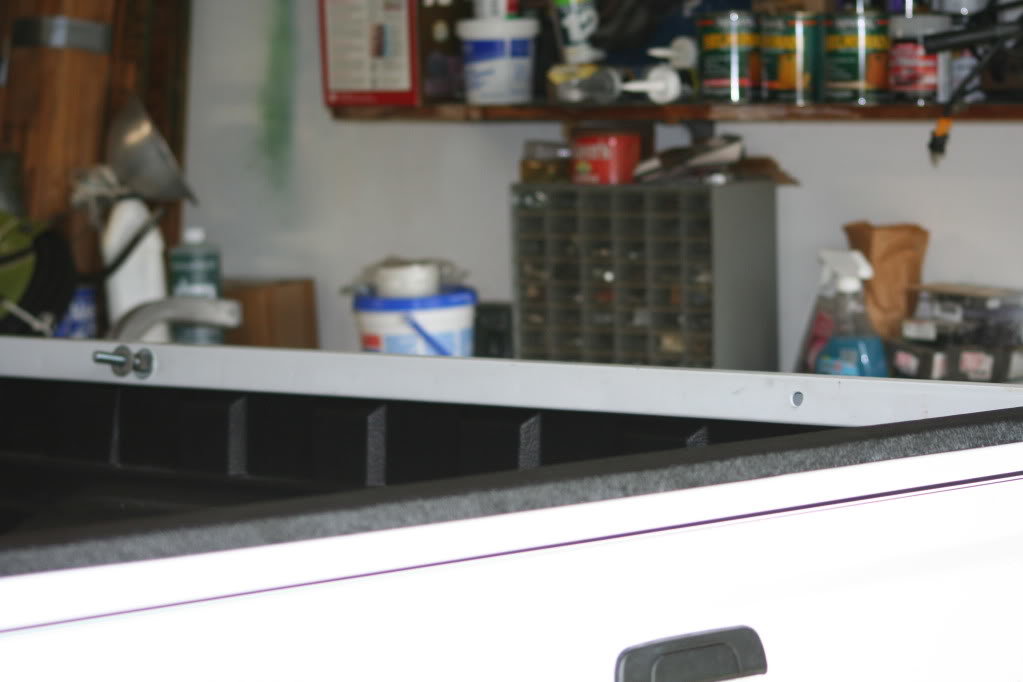

    Here is the Bolt hole and on bolt mounted. I painted the hole after I drilled it.

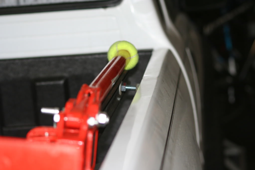

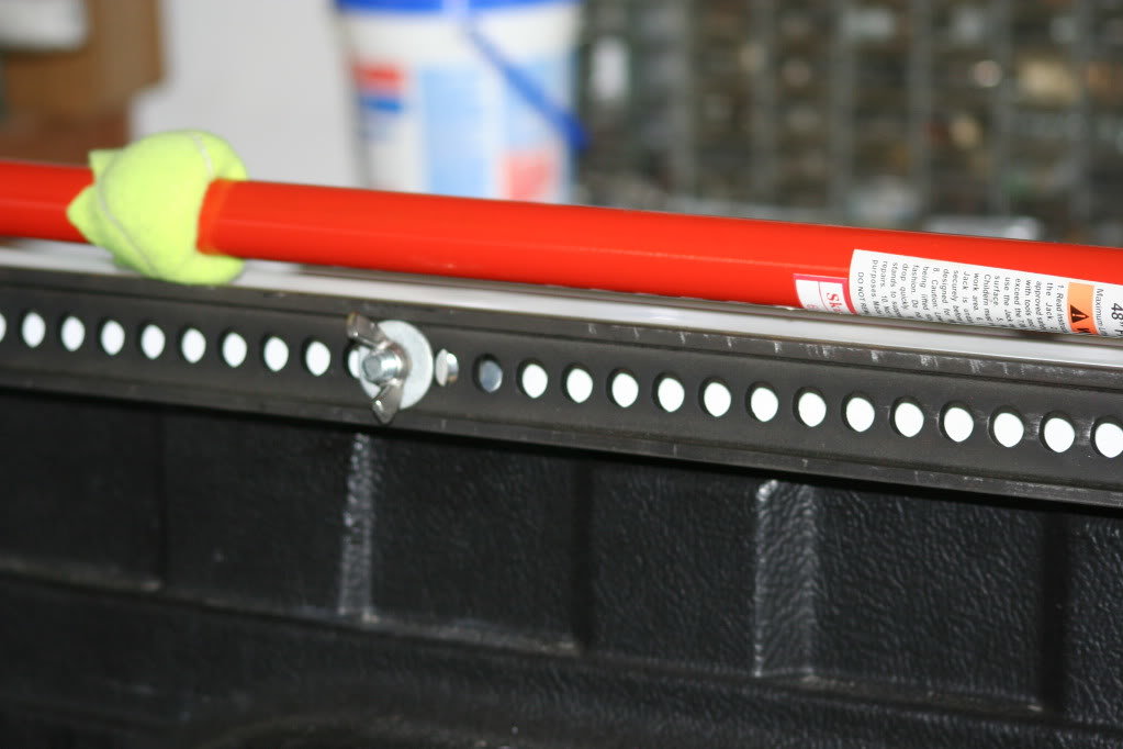

    This is the jack mounted. Note the tennis ball to keep the handle from rattling, it works
    There is a nut and washer behind the wing nut to keep the jack from rubbing on the rail of the bed

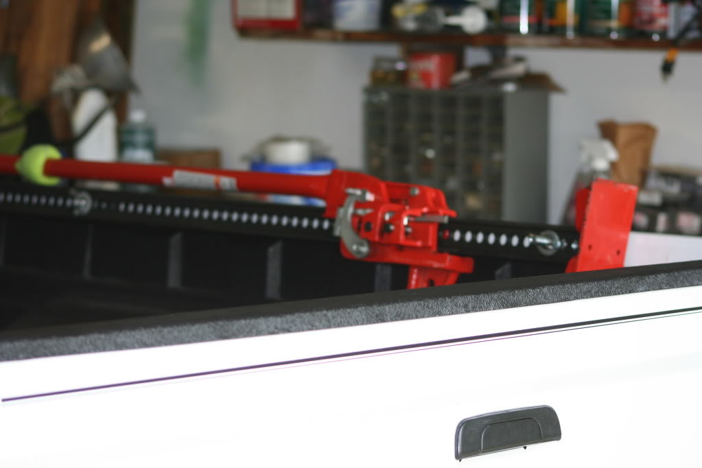

    Shows the offset from the bed
