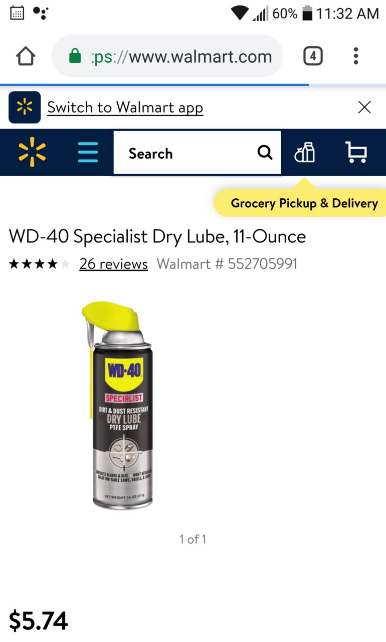

    I use this stuff on virtually everything unless it requires real grease. Never let me down and doesn't collect more dirt like a lot of other lubricants will
