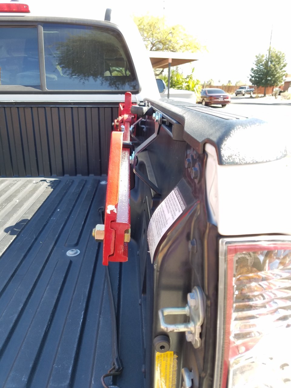

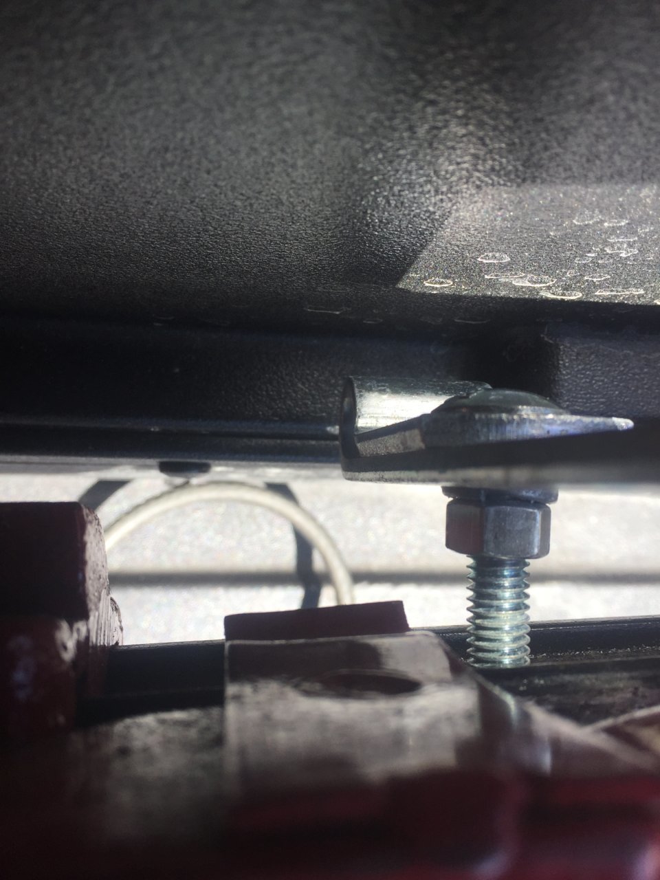

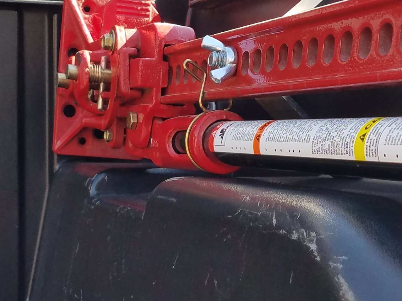

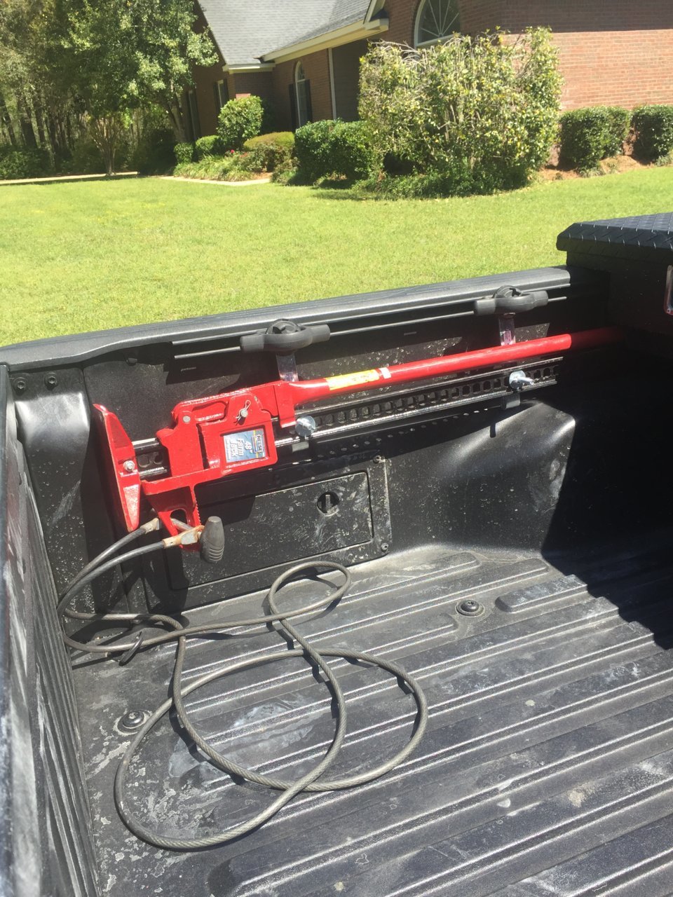

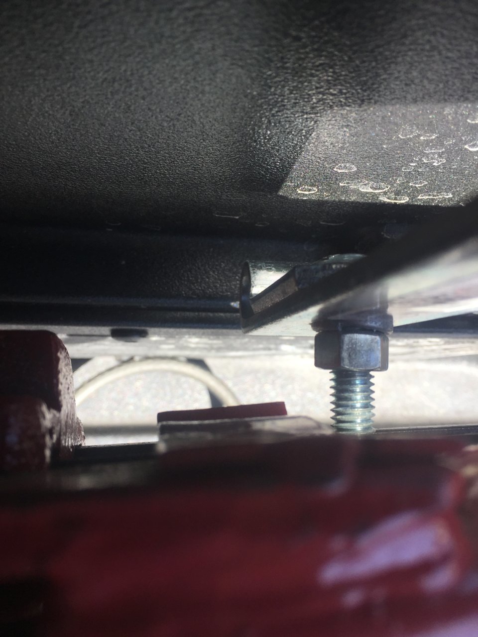

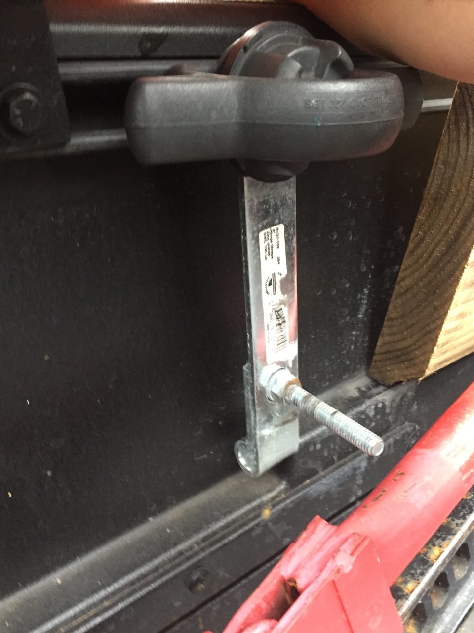

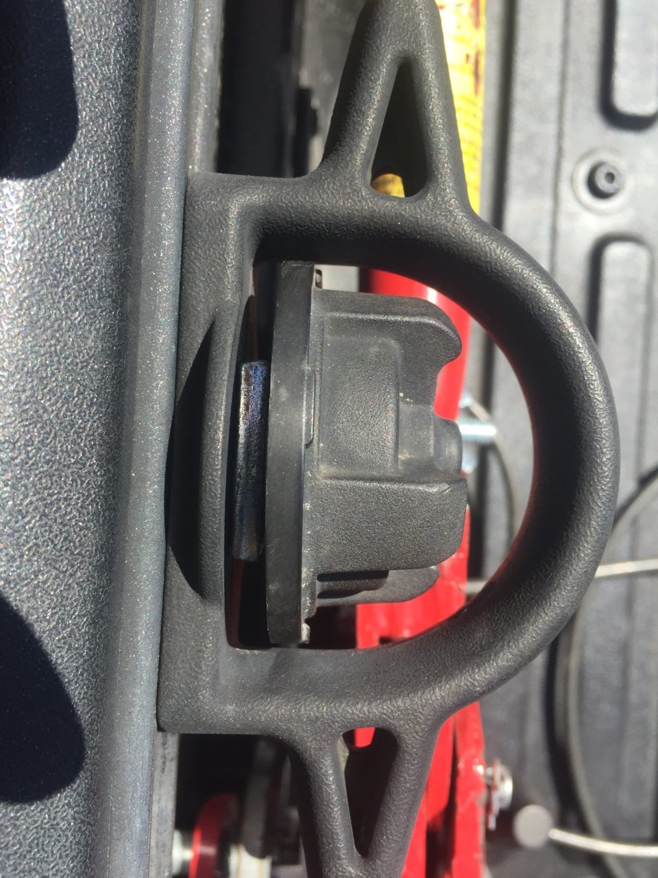

    I used two galvanized fence hinges, 2 3/8 carriage bolts, 2 lock nuts, and 2 Wing nuts on the outside. The hinge pieces work well because they are made for carriage bolts. I attached them using the stock tie downs 81A428EE-0DA1-439A-A30E-9C5327AB17E7.jpgA74C0B88-E9DA-4983-9A21-3CD9FBEDA092.jpg CE618F20-0B60-481F-8AE7-2E68943FDED9.jpg5ED3DD7A-56AB-40CB-8C11-531C0971E724.jpg

    Hey there- love the simplicity and positioning of this! Any chance you could share a pic of what the hinge looks like? Or a similar model? I can't seem to find one in that shape. Thanks!

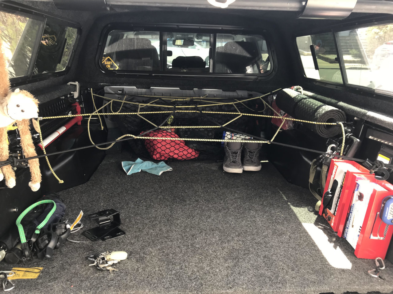

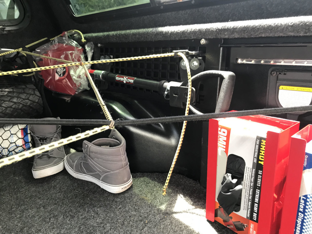

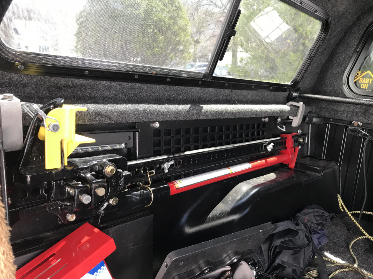

    here is mine
