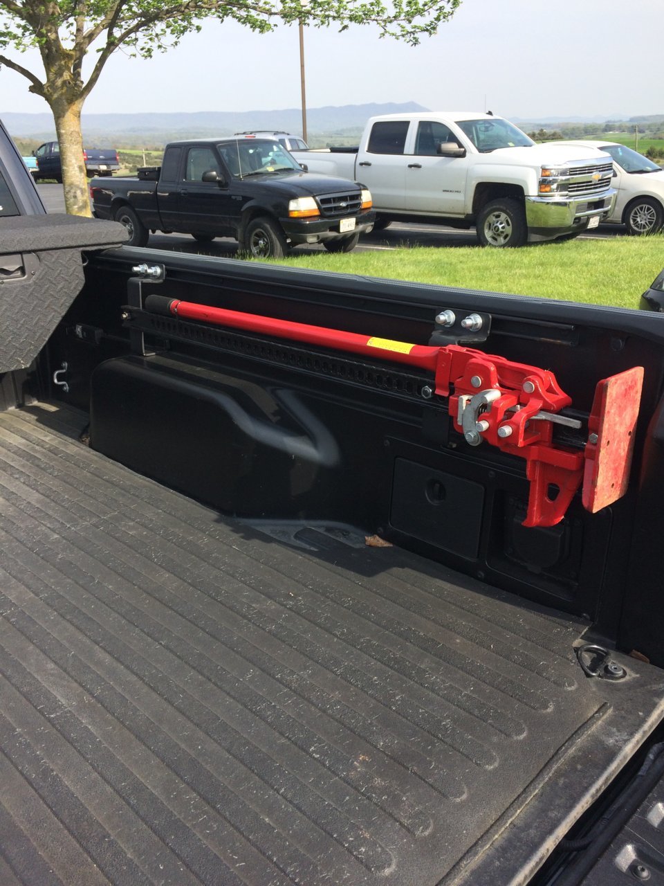

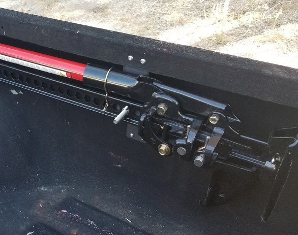

    This isn't that great of a picture, but here's how I did mine a few weeks ago:
    Just some 2" flat bar that I bent, and the lower section is bolted to the bedside with stainless riv-nuts. The top is just bolted with bolts/nuts to the top of the bed rail. The front mount is similar, but shorter because of the fender.
    Most expensive part were the stainless bolts I used. Maybe $20 in parts.

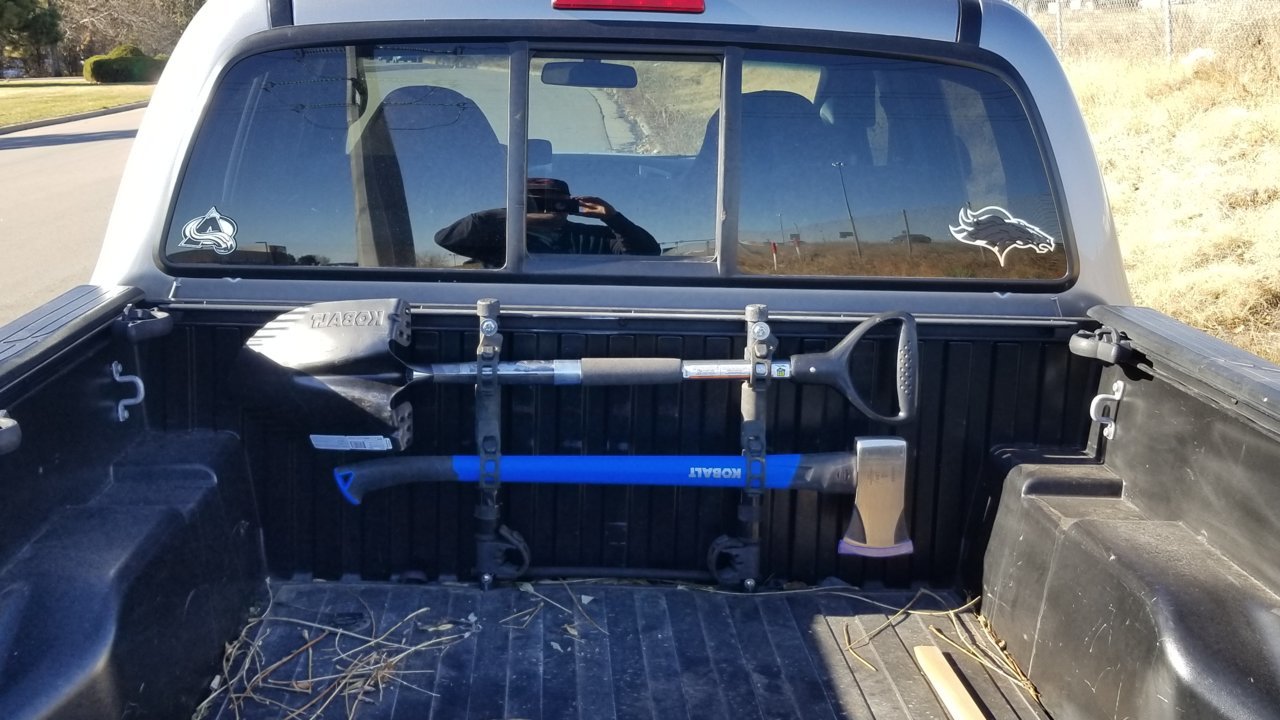

    Modified a 20+ year old Thule trunk mount bike rack
    OCD update... Decided the old bike rack mod wasn't solid enough for me, so I chopped my old skis, added some Quick fists....much better. Btw, cutting skis ain't easy! Very solid though.

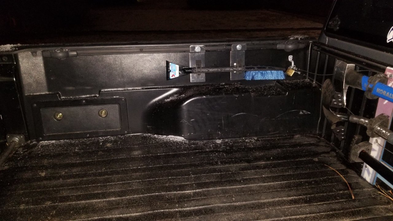

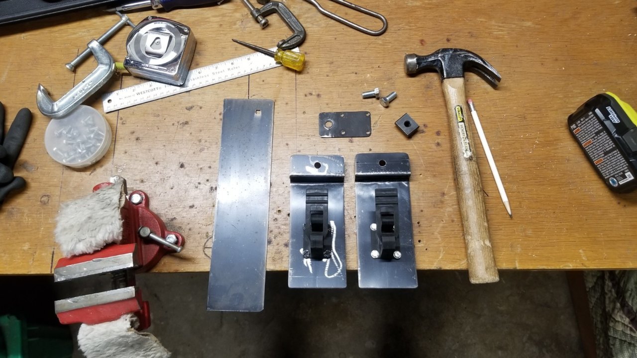

    Made some new Quick fist mounts that hold my ice scraper for now

    Where’d you get these

    I made them. Got a strip of aluminum from the local hardware store and cut them to length,bent the ends down and drilled out the holes.

    Did you use a metal break or did you just use the vice to bend those mounts?

    Vice and hammer

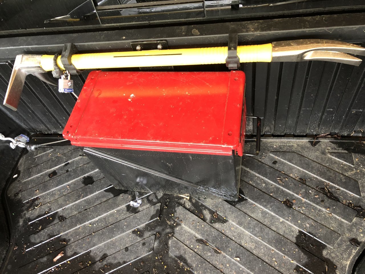

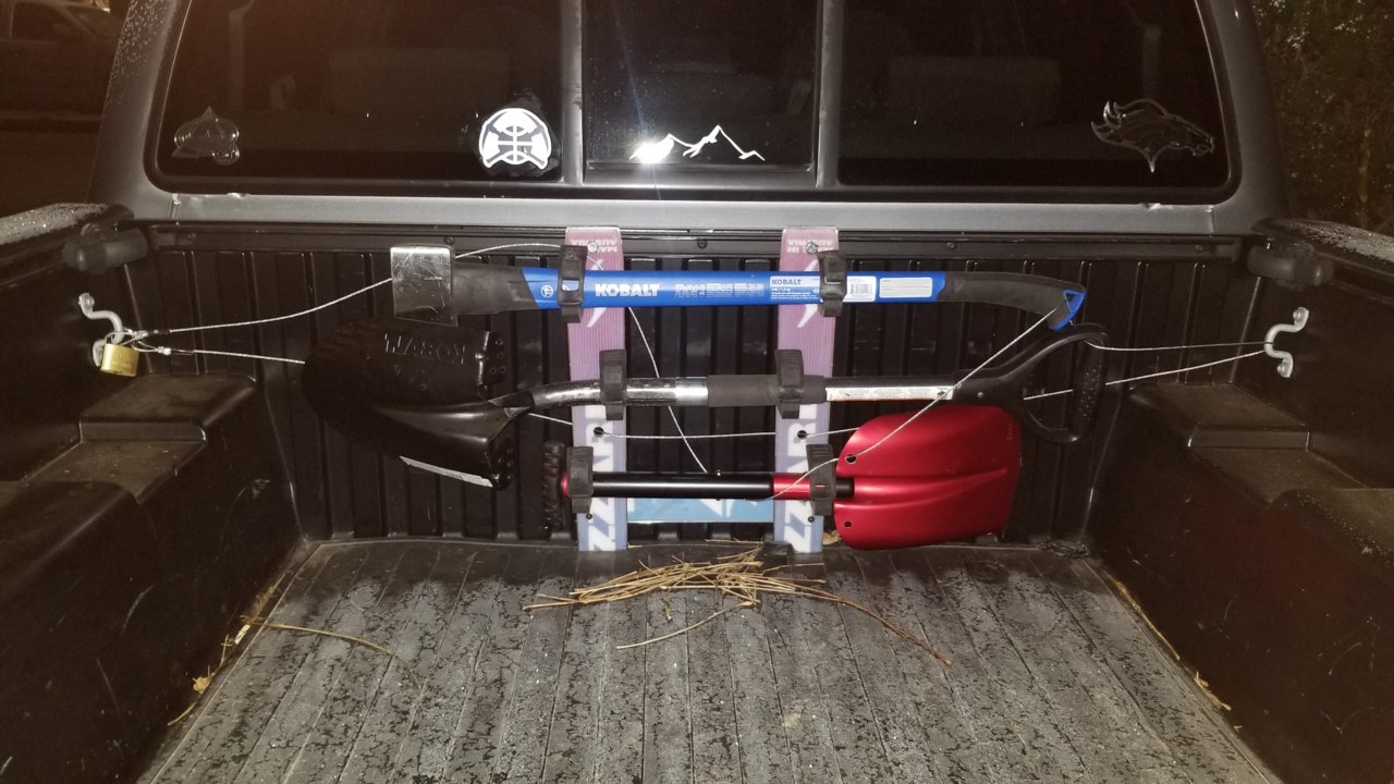

    Halligan with cable lock:

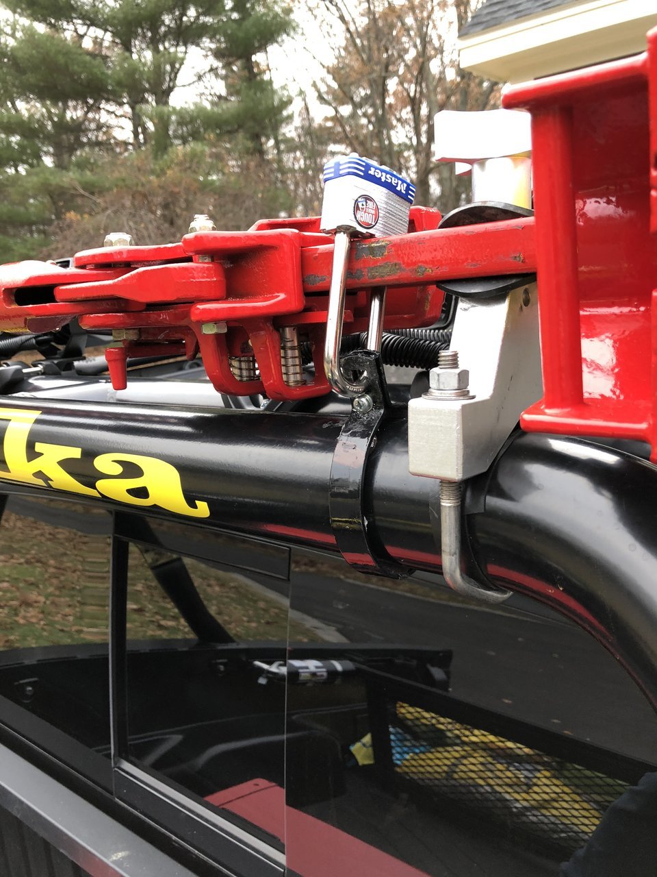

    High lift with padlock: (cover removed)

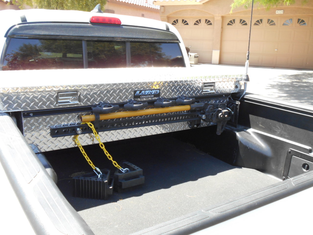

    I put mine on the tool box with wheel studs -
