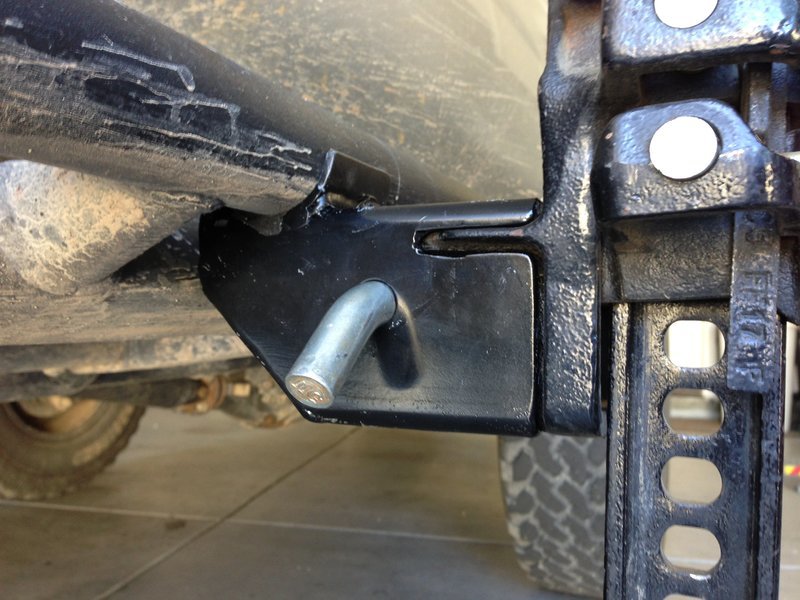

    Max and JLee, you're right. I was looking at the pic and didn't read the description saying 1 3/4 - 2" which is obviously for sliders and not tube steps. Clearly they are just to keep the slider from sliding off the tooth of the hi-lift.
    Well, since I don't have money for sliders yet, don't trust the structural integrity of the tubes or where they mount, would you say I should throw some jack stands in the truck and take the OEM bottle jack with a BIG block of wood?

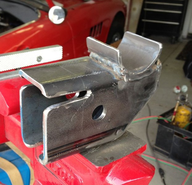

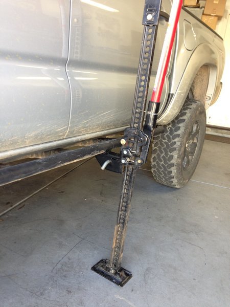

    I made one using some scrap steel.
    It works well, truck is super stable.

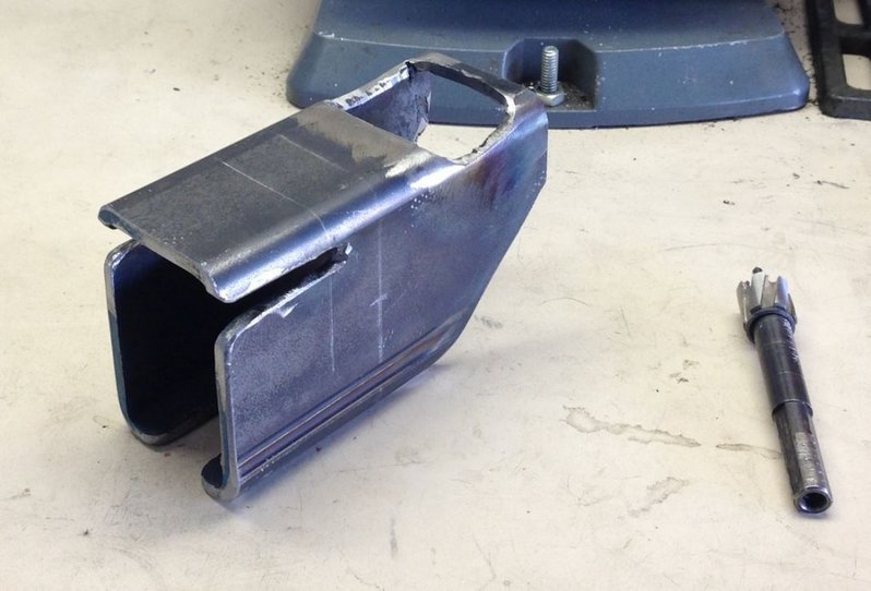

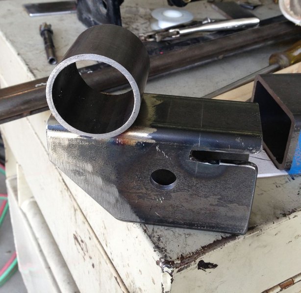

    More pictures

    2x3 rectangular?
