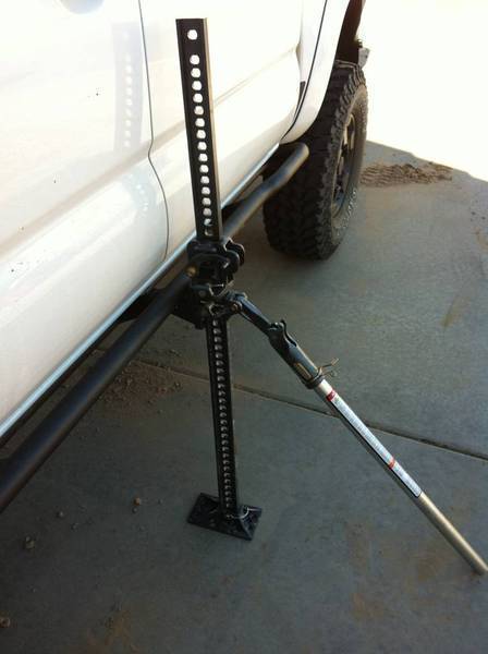

    I was installing my shiny new sliders by Dwreck (review forthcoming) and i was testing the strength of the slider using a brand new 48" hi lift and the handle snapped. I had the truck lifted slightly and had most of the weight on the jack but the tires not off the ground yet. About 3-4 pumps and all was moving smoothly... then snap!!!! It never even occurred to me that the jack would snap like this. Makes me wonder, did i just get a bad one?

    Why is the reversing latch in the "raise" position if you were lowering the truck?

    I may have mis-spoken. I raised the truck, lowered, and began re lifting from a different position on the slider. More towards the middle.
    I got the truck down by using another hi-lift.

    Did the pin on the handle break or did the casting actually break? If it is the casting then it is clearly a defect. If it is the pin, the is could still be a defect, but is more likely to just a damaged pin.

    If you look closely at the picture you can see that part of casting is rusted and the other half Is not. This leads me to believe that 1/2 of the cast broke during shipping, leaving me with only 1/2 to hold on to the pin that holds the handle in place. I bought it from Amazon and they already replaced it free of charge.

    ah yea I see that now.
    Amazon FTW!
