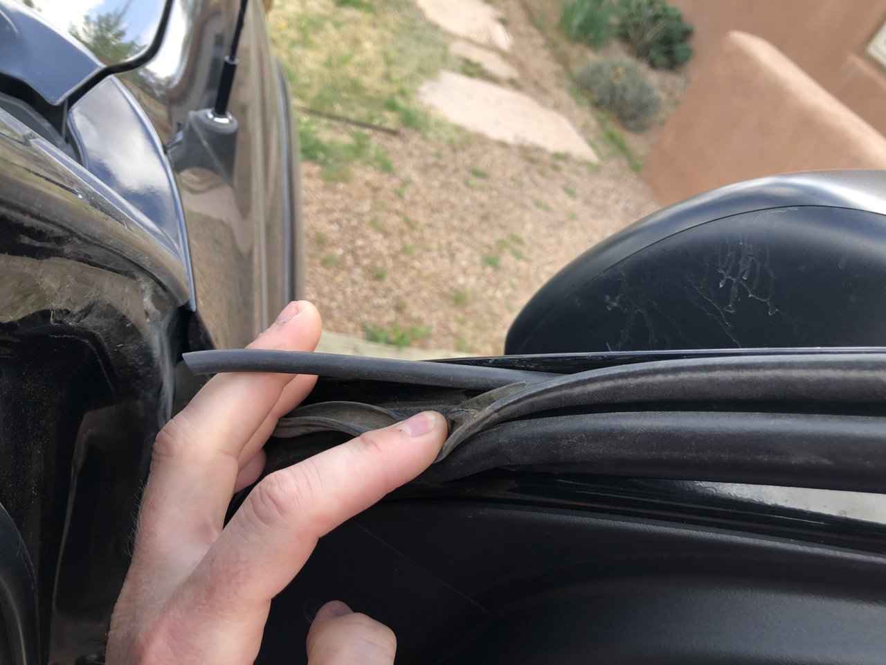

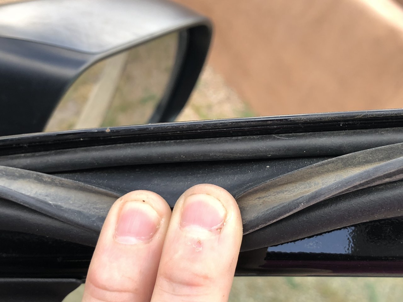

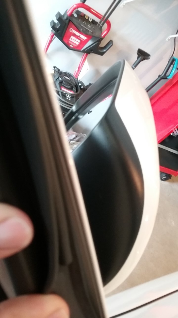

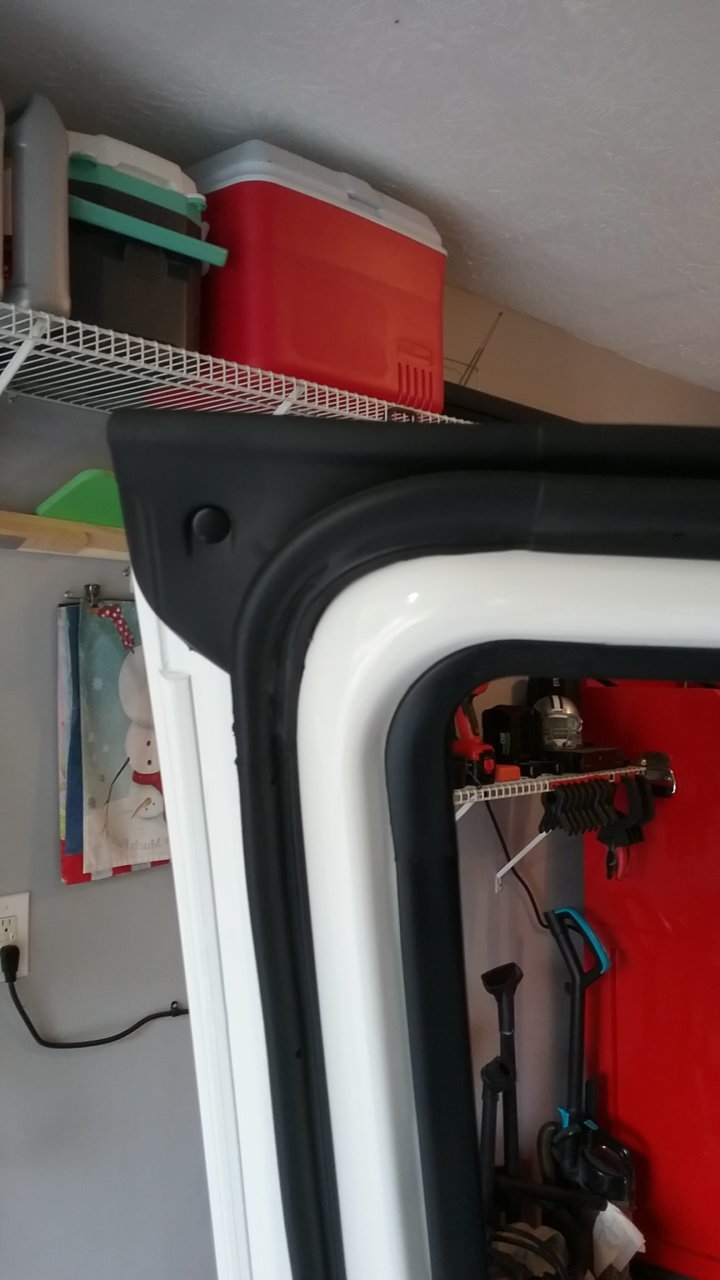

    There is an upgraded seal available. Cured my highway kazoo permanently a few years ago.
    20190424_155920.jpg 20190424_155912.jpg 20190424_175629.jpg 20190424_175655.jpg

    Very simple to install. Just remember when the door checker is unbolted that the door swings freely
