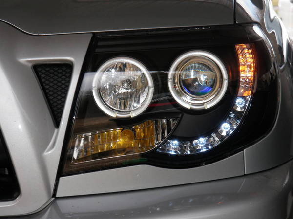

    My halo light fog up to the point i got so pissed i took them out and put the factory lights back in. Then i went inside and ordered 6000k Bi-Xenon and 3000k fogs. Now reading about the lights looks like i will blind the piss out of everyone. WTF The bulbs i got are for the factory lights. Do i or Can i use the projector from my POS fishbowl lights and install them in the oem lights? Or will i be ok with running the 6000k in the oem lights. will the bulbs i ordered even fit in the H1 projector. I think i got ahead of myself and got the wrong bulbs.... What is the best way to handle this? Do i work on the halos and reseal them or retro fit projectors in oem light and a BHLM or just put the F in HIDs in and drive.:mad:[​IMG][​IMG]http://www.hidxenonheadlights.com/

    one more thing. I did the hi/low beams on at the same time mod. do i need to undo this mod.

    hey i bought these headlights also n mines fog up really bad :( did you find a way to get rid of the small puff above the cutoff line? and so long as you ordered the H1 bulb, everything will be fine :D

    Is the bi-xenon kit you bought the H4 lo/hi combo? If it is then I'd say you need to use oem housings since your other lights have seperate lo and hi beam bulbs. And if so, I'd also say undo the lo/hi always on mod too. IDK about taking the aftermarket ones apart and playin around with that. Just re-aim the lights down a bit after installing. Unless you got 55w kit then you should be OK on not blinding people. My gen 2 aftermarket lights are seperate but there is H7 in the lo beam projector and 9005 or 9007 for the bright. I did HID fogs and left the headlights alone.

    Why not just re seal the projectors?

    Sounds like if he does that then the HID kit for headlights aren't gonna fit.

    I picked up the H4 moving hi/lo. And disc. the hi&lo mod. I also moved my lights down alot. I guess i will move them up a little and see if thy piss anyone off. For the old lights i just wanna sell them.

    Not sure which ones are the "old" ones anymore, lol. Assuming you are using the HID kit in the oems and talking about selling the black'd out gen3 ccfl's?
