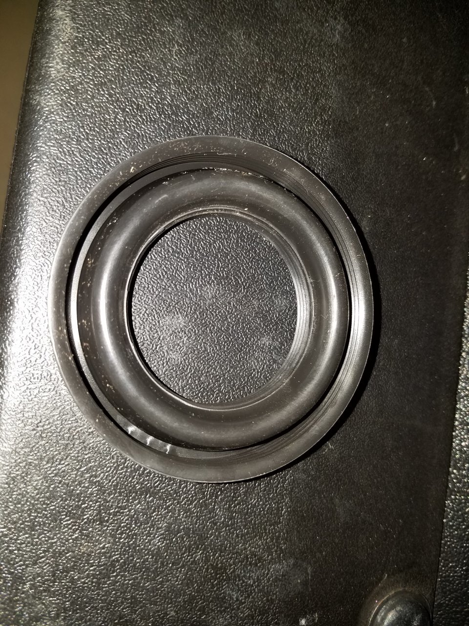

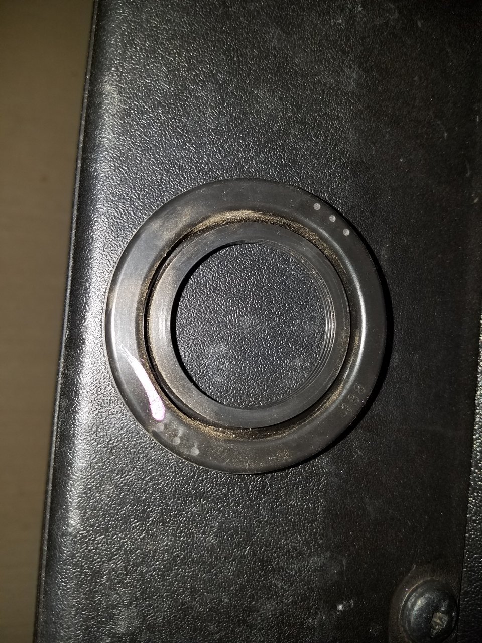

    Never noticed the new responses here. I looked back into it a bit tonight. Shake is getting worse now that it's warming up. I noticed on cold days that I got zero shake at first but after driving for 15min or so it would begin shaking. Saw this very consistently on my 30 minute drive home every night. No shake first half, lots of shake when I was almost home. Now that it's warming up I'm seeing more shake sooner in the drive.
    This to me means heat getting into the gaskets is for sure part of the issue. Whether it's the big black gasket around the projector or the tiny red gasket on the bulb or both I can't definitively say.
    What I do know is the big black gaskets on my truck have significantly deteriorated. There's a gap at the top and the bottom is thinner/smushed. You can see it in the original photos I took. I need to pull these off and look at them more closely but I haven't gotten around to it. Also as far as I can tell you cannot buy these gaskets individually...which sucks. I would have bought some if they were available.
    I swapped the morimoto red gaskets for the oem red gaskets that were on the halogen bulbs tonight. They seemed pretty similar so I don't expect any difference but we'll see. I do admit when I was jiggling them around while installed and on it seemed like the smaller red gasket was the first to give as opposed to the big black gasket. You have to wiggle it pretty good to see give in the black gasket.

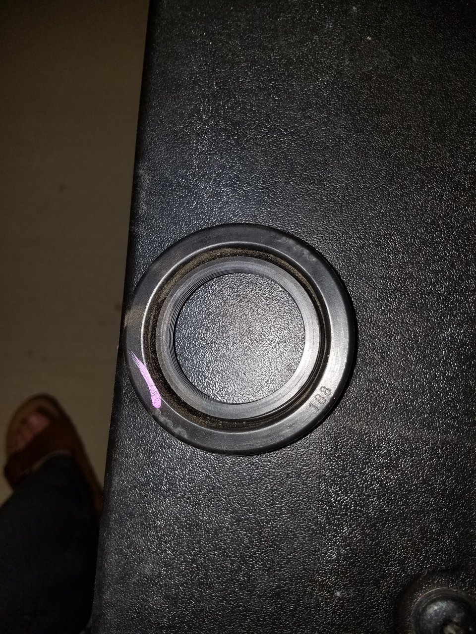

    Update...I went out and pulled off the black gasket and I was wrong. My theory in the first post is bull shit. The black gasket is fine. Perhaps my projectors were tilted a bit from day 1 and thats why the bottom seems smushed and theres a gap at the top. Either way I rotated the gasket all the way around and its exactly the same. In fact that gasket isn't responsible for stability at all...its just a weather seal. The metal bit that the bulb goes into is the back of the projector which is bolted down within the assembly. Even with the black gasket removed the projector does not wiggle around without significant pressure.
    So with all that said I think there's only one remaining culprit...the seating of the bulb and it's small red gasket. The play in the red gasket is what creates the shake. Probably every setup has a bit of shake but 3 things can make it more noticeable...hotter bulbs, brighter bulbs and hot spots in the output. The morimotos are no doubt the brightest and do have hot spots in the middle and I have the 50w kit so lose-lose-lose with respect to shake. I may try the thicker gaskets from TRS. I got my kit early and I think I got the original gaskets so.
