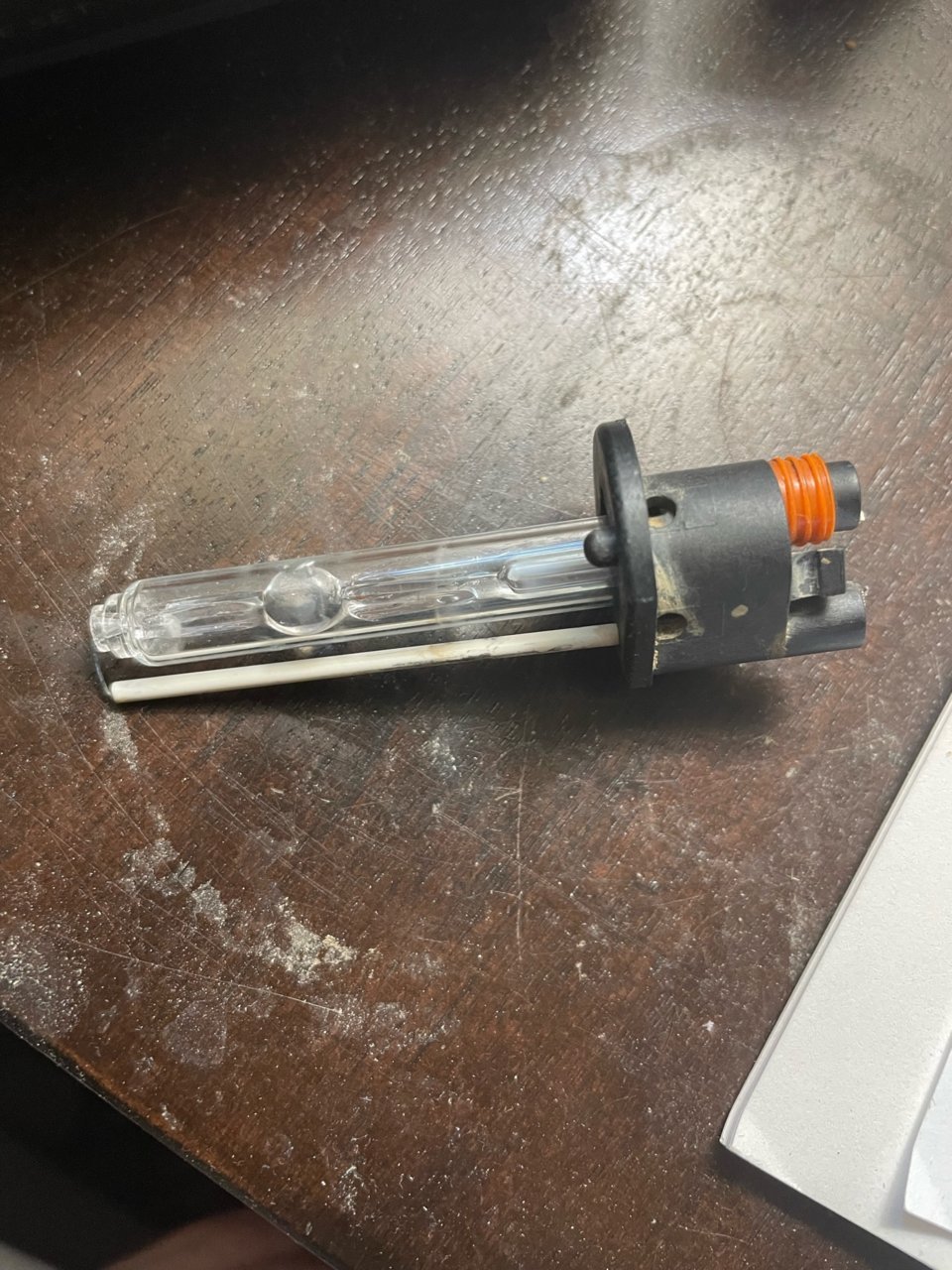

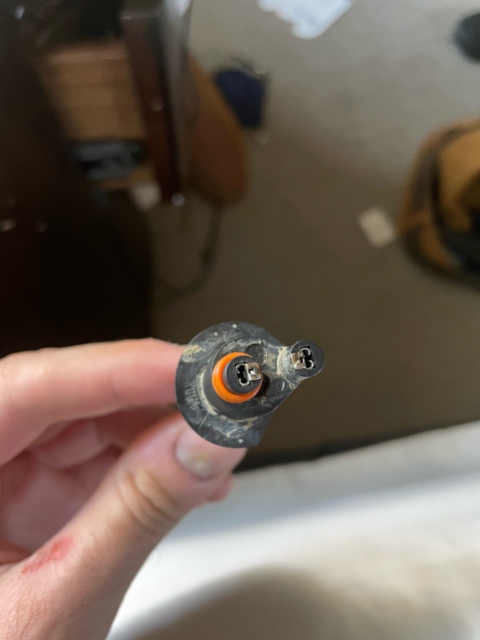

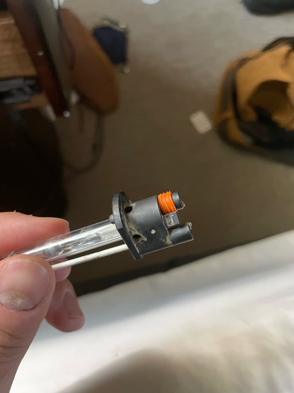

    I had someone retrofit my Tacoma with HID about 5 years ago. A bulb burned out and I need a replacement. What can replace the attached pictures? They’re labeled XBH1. I can't seem to find anything on the morimoto website that is just a bulb to plug in.

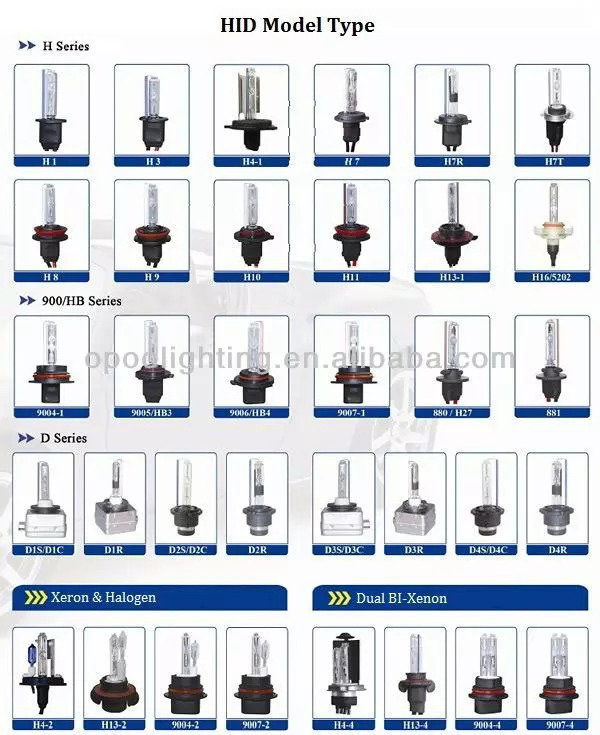

    It may only come with the ballast. Here’s a chart for reference. Hope that helps. A5A6E303-C31C-40CE-9CC4-C83A67449F4F.jpg

    Here:
    https://www.theretrofitsource.com/h1-xb-hid-B-H1?quantity=1
    HIDs dim over time. Replace both.
