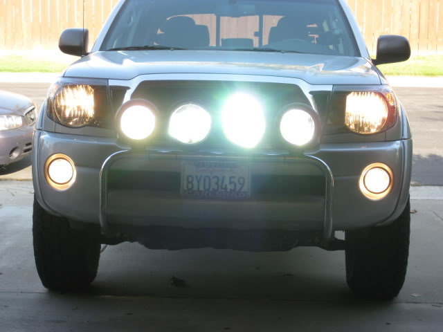

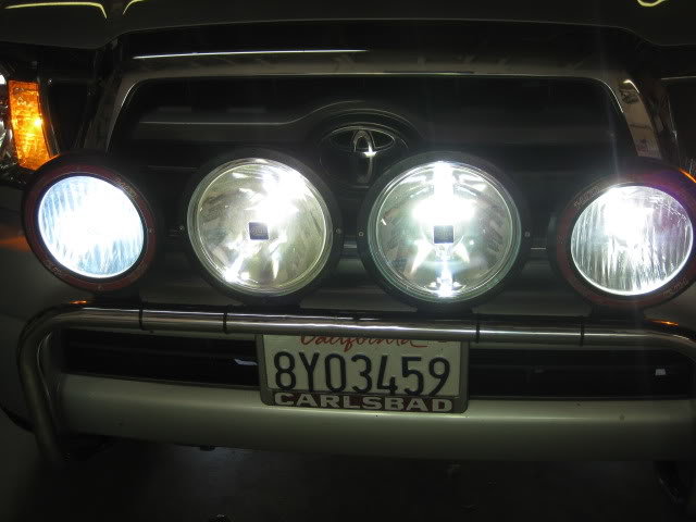

    They are absolutely brighter, no doubt about that. They should be--those halogens probably won't be putting out more than 2500 lumens, whereas HID should be around 3200.
    The second picture shows quite a bit of errant light above and below the spots. Above is a lot lighter, but right below between the spots is big a hot spot almost connecting the beams. It could be that's just because the light source is brighter and it's not showing up with the dimmer halogen bulbs. Or, it could be different exposure on the camera.
    With spot lights, it's pretty likely there's not a "whole lot going on" in the reflector bowl. However, if it's anything but a parabolic reflector, it's going to change the pattern regardless. The light sources are different shapes--one is roughly a rectangle, and one is a large "blob" in an elliptical shape.
    Think of a signal mirror, or even just reflecting the sun through a window off your watch face. Ever remember as a kid trying to spot someone with it? A tiny movement of the watch face/signal mirror makes the point of light reflected across the room change significantly. When this happens with a headlight, you get some very different light outputs--including a lot of stray light that can be damaging to the operator or others (too much light in the wrong places can be as bad or worse than not enough light).
    One of your pictures with the bluer lights has the spot way off, which must mean the bulb wasn't on quite right (either mounting or manufacturing), which is another good example of what I'm talking about.
    In this case, it looks like it works well enough--but in most cases it doesn't.
    However, my explanation is why the other poster's 500FF's didn't work well. They use the reflector for a "driving" pattern. Factory halogens have this same issue.
    Anyway, not trying to discourage you in this case. It looks like they'll be fine, and the other lights will probably wash-out any errant "hot spots" (and you won't be using them in traffic--I hope LOL!). I almost converted my Lightforces before I got rid of them. The biggest problem I had with the Lightforces is that they were too much of a spot light, and my eyes would gravitate to where the "spots" were. On curvy roads, I needed to be looking elsewhere. I do miss the reach of those beams though--even with halogens, they went as far as I could see at 65MPH.

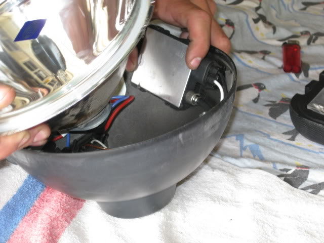

    Do you have any better pics showing how to place the ballast in the housing to make everything fit together? I have the kit from GG and can't figure out the fitment

    Hard to believe that GG is still in business. Soon after my install in 2011, and the ballast fails, wrong color temps, etc. (apparently several others on Tacoma World, too?) he left a lot of people here out in the 'cold'. He was banned. A friend of his, later on, picked up the pieces and made good when my ballast failed and the color was wrong, I wish him well... however.
    Anyway, to answer you, I think I posted all the photos I took of him installing it. It is a tight fit, but the slim ballast will just fit inside the lamp housing... it is just loose but when you put the lens half on, it is so tight, nothing rattles.

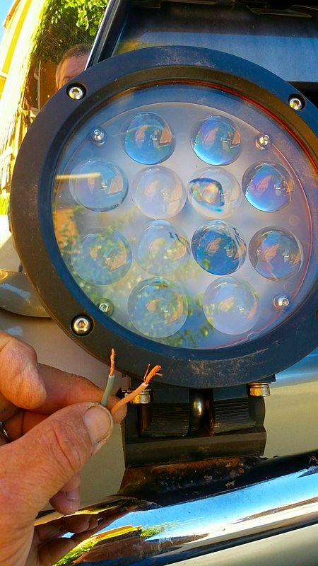

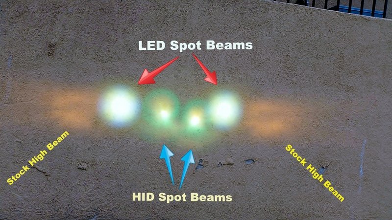

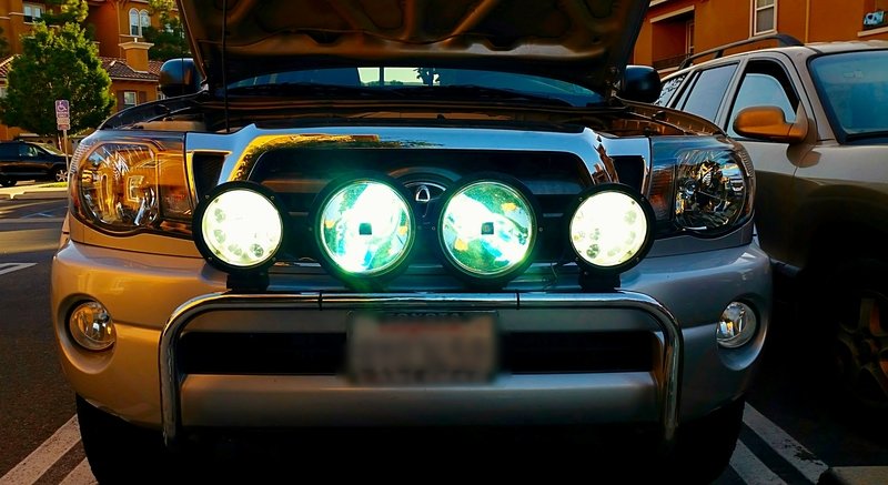

    I have the two Hella 4000 lamps (spot beams) with GG converted to HID (35 watt, 5,000°K or about)
    The center two:
    After I replaced the two outside lamps to LED (7" 60 watt Cree spot beams), with the Hella HIDs on, too:
    Projected against a wall. The LEDs just knocked the socks off the converted Hella 4000s.

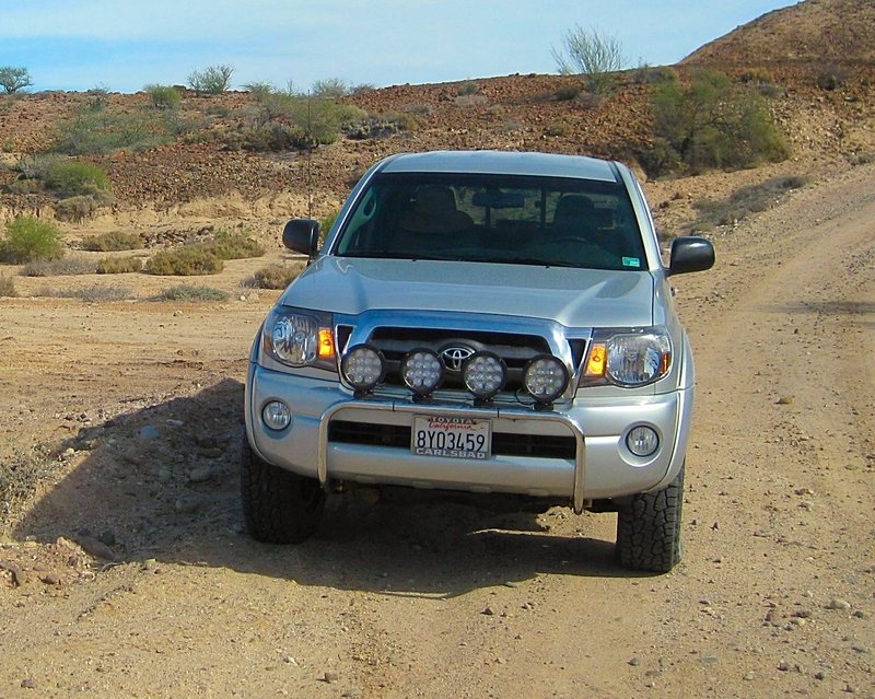

    Now, I have all 4 lamps locations with the Cree 7" LEDs (2 spot and 2 Euro/Driving):
    I may consider selling the pair of Hellas with the HID conversion that this thread is about?

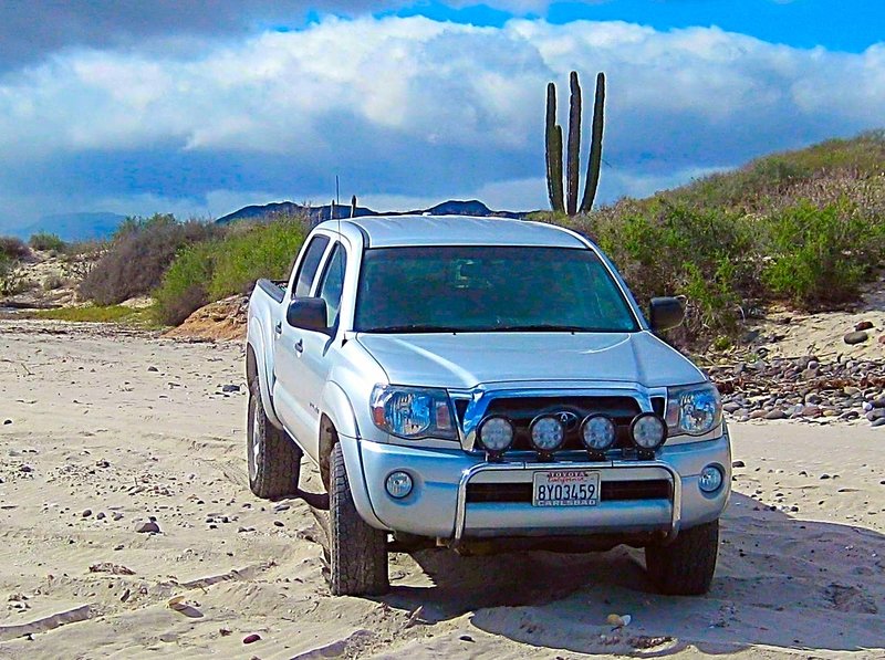

    Nope, bought them from a friend off a Land Cruiser he got. I searched forever before finding what looked like them on Google. 7" round Cree.

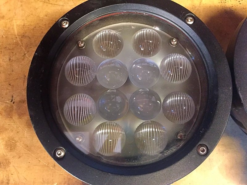

    Gotchya! Any pictures of them without the lights on?
  16. Jul 15, 2017 at 11:47 PM
    #56
    David K
    David K [OP] Well-Known Member
    Jun 27, 2009
    #18969
    12,407
    Pala Mesa, California
    2010 4WD Off Road DC
    Differential Breather Mod Light Bar: 4 Cree LED lamps Bilstein 5100s Ride Rite Air Bags
    Driving (Euro) Beam has fluted convex lens. Spot (Pencil) Beam has plain lenses. They light up the parking lots. No warm up, it is instant/ The light is pure white.
    By Pancho's at Bahia San Rafael
    Happy New Year 2017! Viva Baja!
    How about if IVAN STEWART stands between me and my LED lights, while holding my book (Baja California Land of Missions) I just gave him?
