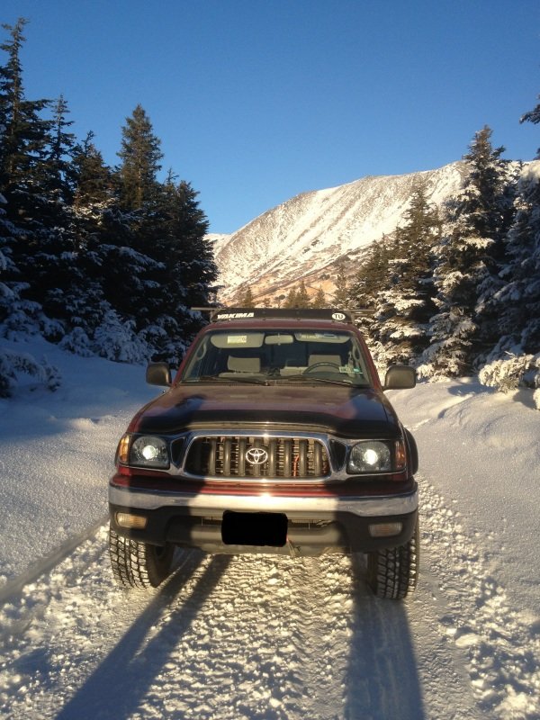

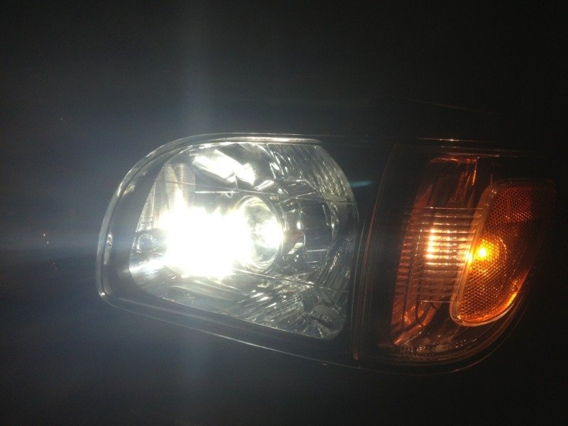

    I just got the mini H1 kit with the upgraded xb35 5000k bulbs. I love them so far. They are amazing compared to stock. And it was very easy to install. I baked the housings, installed/aimed projectors, sealed them up, and installed them on the truck in about 6 hours. I could have done it faster, but I would recommend taking your time with it. And seal up the housing with silicone too just in case.

    These look great! Can you comment on light output, pattern, and any difficulties you might have had since the install?

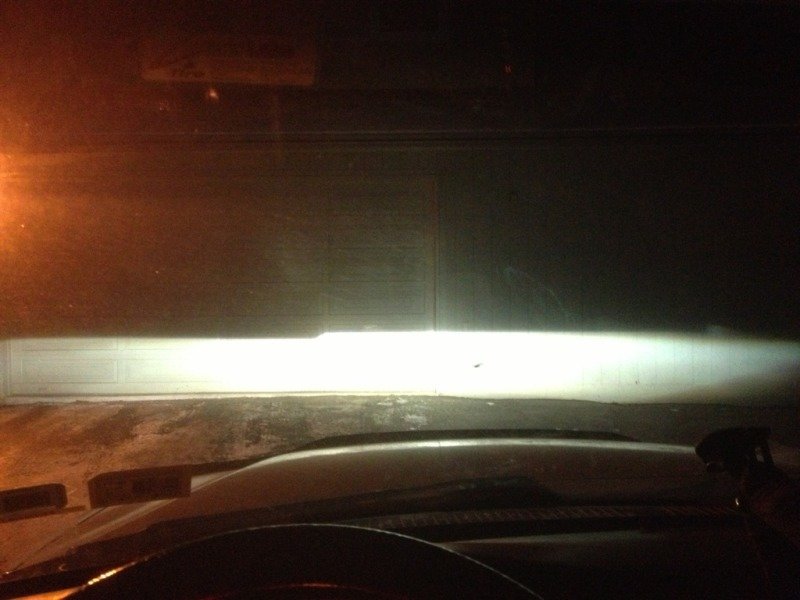

    Light output is very good. The beam is very wide and covers the road well. However, it does not cover immediately in front of the truck at all. I see you have a 2013, so your fogs will likely take care of that. I have not had any difficulties really. My driver side bulb isn't seated properly, as the cutoff is blurry and yellow rather than fine and blue. It's also a little crooked, but I've just been too lazy to take the light off and fix it. It's still very usable.

    Not sure what the issue is with you not getting a good beam in front of the truck. Mine is awesome... maybe it's the shape of the housing? Or are you running H1?

    Yeah I'm running the mini H1. It just does not seem to project immediately down. I'd say the beam hits the ground about 15-20 feet in front of me. It still has some faint light there, but the majority of the light doesn't hit till then. Other than that I think it's a great kit. I wanted as close to plug and play as I could, and that's what I got. Only had to dremel once spot on the housing and one on the washer.

    That's the ever-present 5.0 foreground limiter. That can be modified on the projector if you prefer foreground light.
