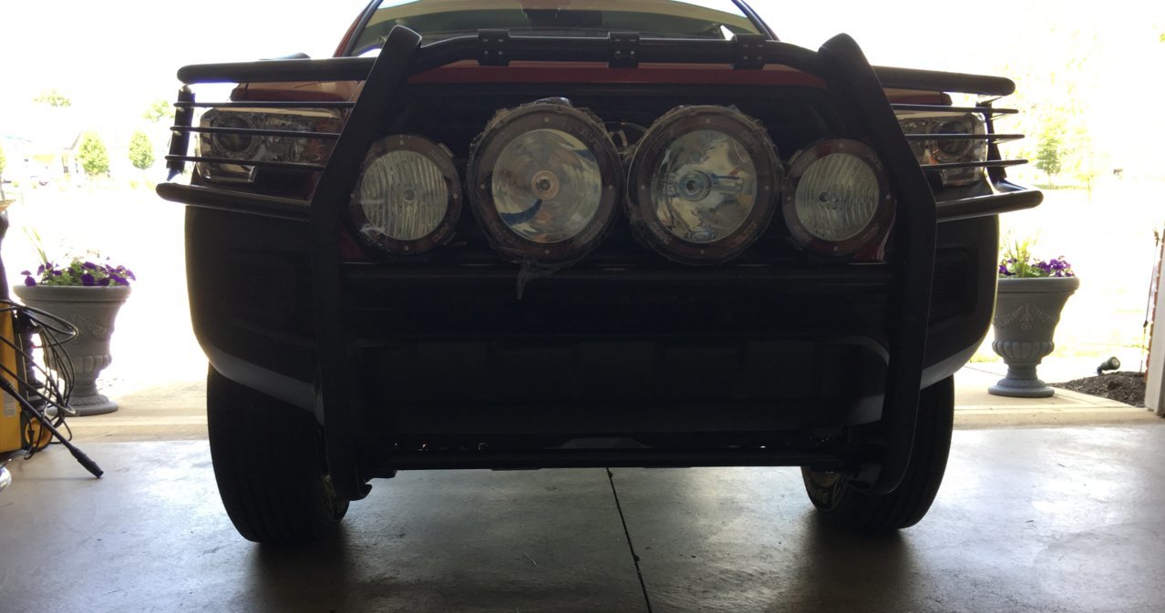

    So I’ve this driving lights setup in mind.
    Will it interfere dangerously with the airflow for my radiator?Asking for a friend...:D

    hmm needs another set on the bottom. no but seriously why don't you just take it on the highway and just check your temperature if it's higher then normal.

    I had 4x hella 500ff across the grill of my 2nd Gen. No temp change.
    There is a lot of room around and under the grille for airflow- your good.
    Might take off that damage multiplier though..

    I don’t have the link, but there was an interview with one of the engineers. He said that they designed the front end to get more air to the radiator due to the fact the radiator is 8” from the grill which is way more than any of the previous gens. Seemed they didn’t want the front blocked... I wouldn’t do it since the wind drag alone would be a abnoxious. Seems to me you would want that wind, not being blocked by those nice round lenses...:confused:

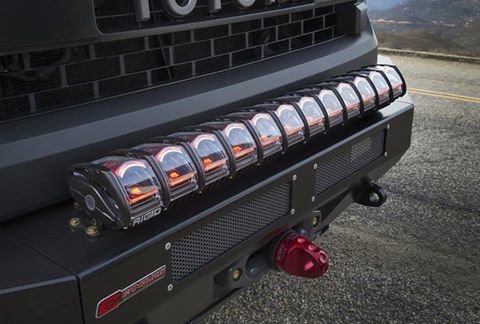

    Spend the big bucks and get a color adjusting Adapt Rigid light bar...(only kidding due to it being $$$)
    https://m.youtube.com/watch?v=Qq3_1Z8kK8U
    (Commercial is a little “cheesy :jerkoff:” to me, but the concept is cool)
    in all seriousness a slimmer design would benefit you a lot more even though those older style setups look slick. You could get a headache rack style setup for the round style and it will affect your mpg the same-ish and not mess with cooling the truck (importante’)
    This truck’s top setup must absolutely make it like day...

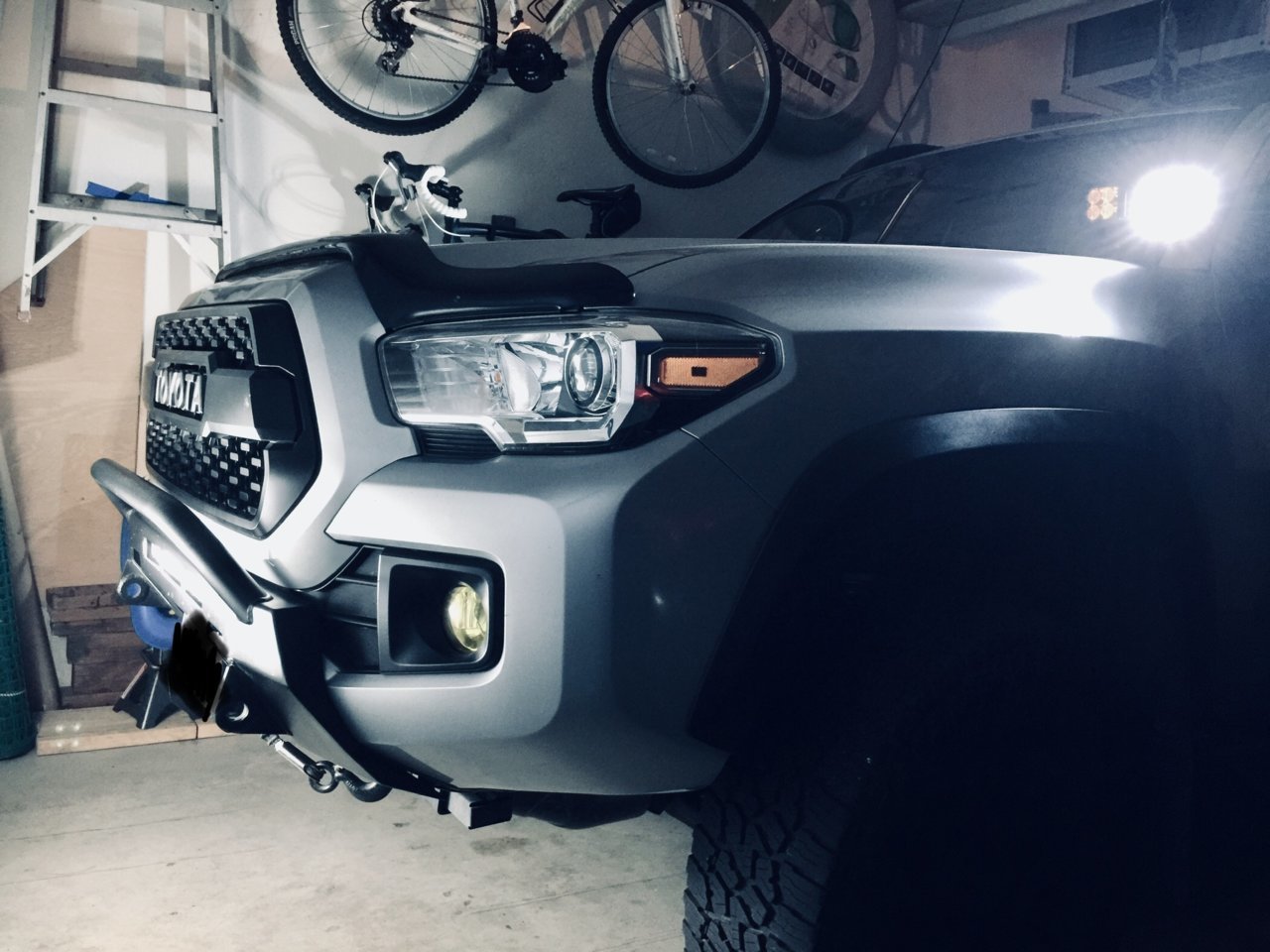

    I like leaving my lights on when I camp and other reasons...so LED with the correct filters seems ideal for me

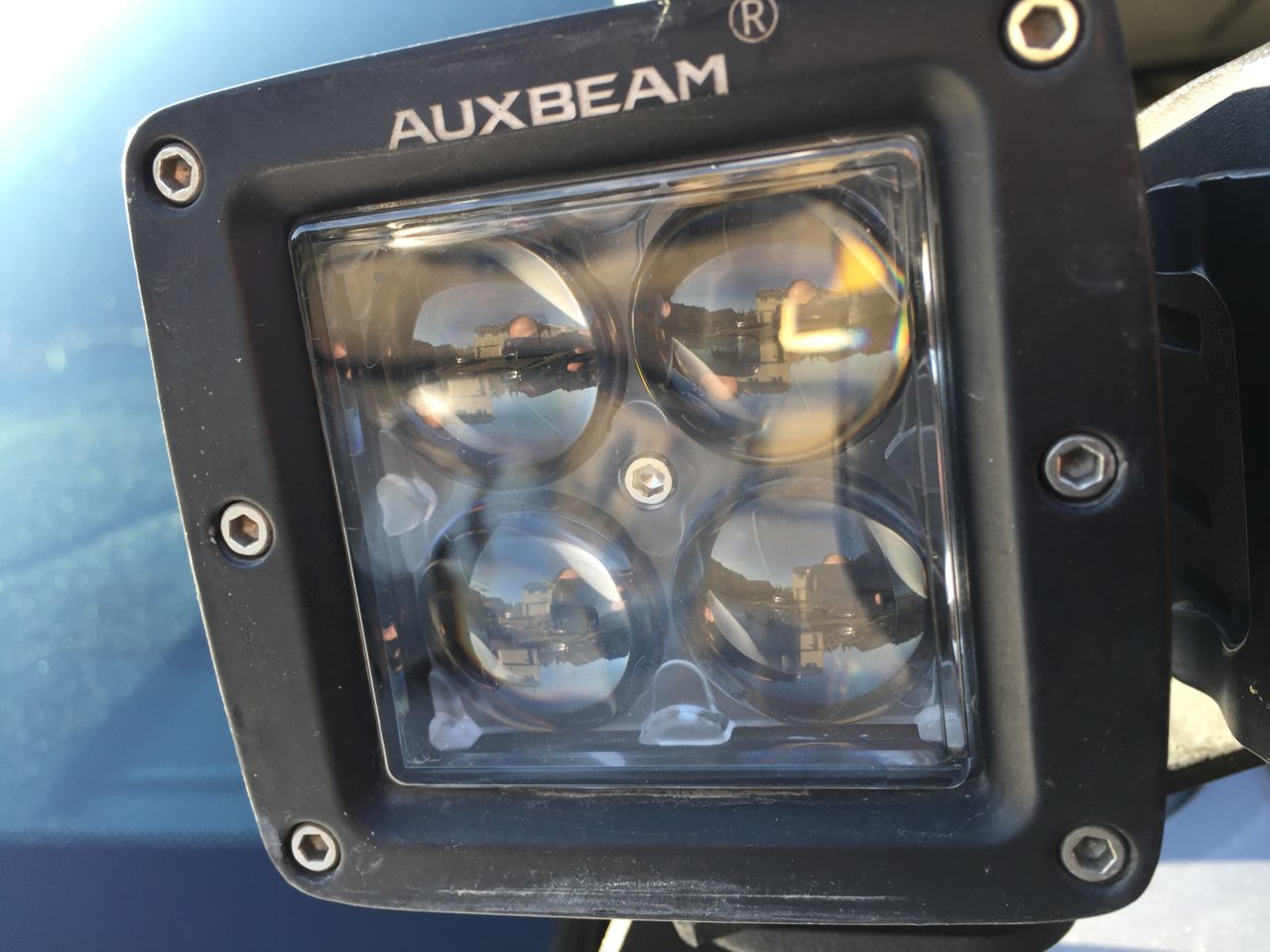

    quad pillar cubes and a 20’ bumper light and it does just fine on the night trails, even at speed. I have different color lenses and the yellow works wonders in the dust.
    (Shown with black filter ‘street’...(yah right) lenses. Inside spot, rotating outer is flood)

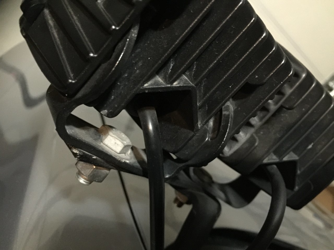

    The mounts are CBI
    The lights are any 3” cube. I like Auxbeam for the $
    The trick is the custom steel, rubber lined extender I bolted to the mounts to hold and swivel the outer while maintaining the inner.
    And no, I have about 1/2” to the windshield with the hood up.

    So is the double mount a part that you made, rigged from other parts or that you bought?

    I made it and rubber coated it

    Any pix or details or is it a secret?
    I could have sworn I saw some double ditch mounts but can’t find them.

    It’s a solid piece of steel I measured and rubber coated. It supports the lights pretty well. They don’t shake that much at all on the trails.
