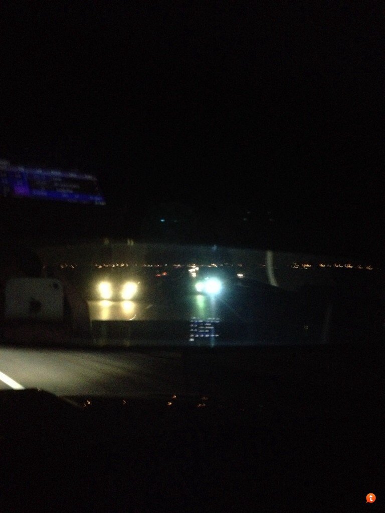

    This has been brought up several times but people still don't seem to understand how bad it is to run HIDS in stock housings.
    Here is a pic from a drive home the other day showing how bad the scattered light is from another driver.

    But bro... that's just not properly adjusted :rolleyes: ;)
    I hear you. CHP has been clamping down lately. I haven't seen yellow headlights in a couple of years now, and I'm seeing fewer and fewer of the darker purple lights.
    And yes... there's a silver DC Taco that always seems to get behind me on my way to work, and the idiot has HIDs in his stock housings AND his fogs.
    I see him coming up, I move over, slow down, and tuck in behind him.
    It seriously gives me a headache to be in front of him.

    Agreed..I wish I had a LED light bar for certain people who really don't get the message..:rolleyes:
