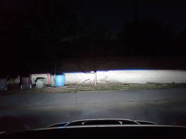

    The shroud limits the lamp to use only the top half of the reflector because that is the half of the reflector that projects the light DOWN.
    If you are lighting the bottom half of the reflector, you are throwing light above the cutoff, directly into oncoming drivers.
    You can't paint the HID burners... they run too hot and will burn off any paint applied.
    If you can't afford retrofits, you can't afford HID.
    Do it right or don't do it.
    Park your truck in front of a wall, take a picture, and post it here.
    This is mine:
    Drop-in HID lamps will have bright scatter above the cutoff. Halogens will cut off more gently without the sharp edge.

    Yeah mine don't look like that. But I enjoy actually seeing at night, and I already spent the money, so they gotta stay. I'll probably be doing a retrofit soon

    You probably enjoy the extra light but the people in front of you probably hate you.
