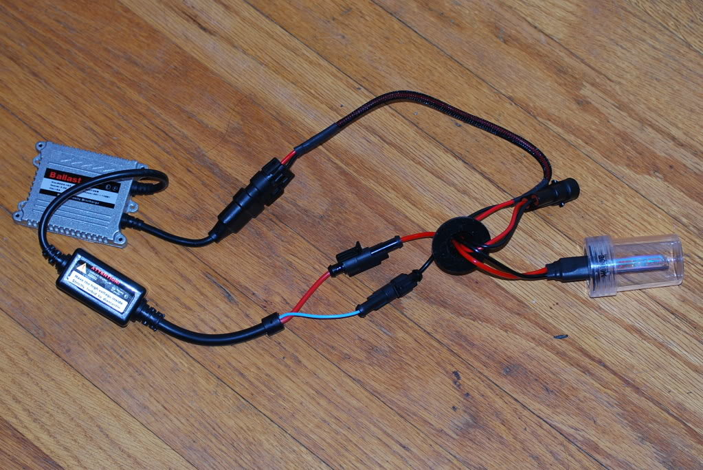

    Someone quick help
    I took a quick look at them today and tried to hook them up and nothing happened. I had everything plugged in as you see in the picture and the female connector that isn't connected to anything I had plugged into the fog light harness.
    I'm obviously doing something wrong.
    Someone help please.

    Do you have the stock harness plugged in right.. maybe you plugged it in backwards..

    try flipping the plug around, the connector might be on the wrong way.

    new here when there hooked up and do not work try the high beams 1 place I cot mine from gave me the wrong harness it was backwards give that a try.

    are there in-line fuses on those? If there are, check 'em.

    Sorry I didn't keep up with this thread. I got it all figured out. I just had to flip the plugs. Noob mistake.
