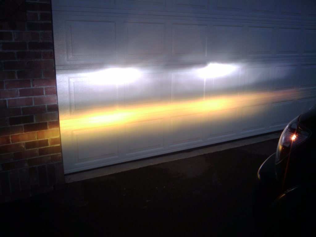

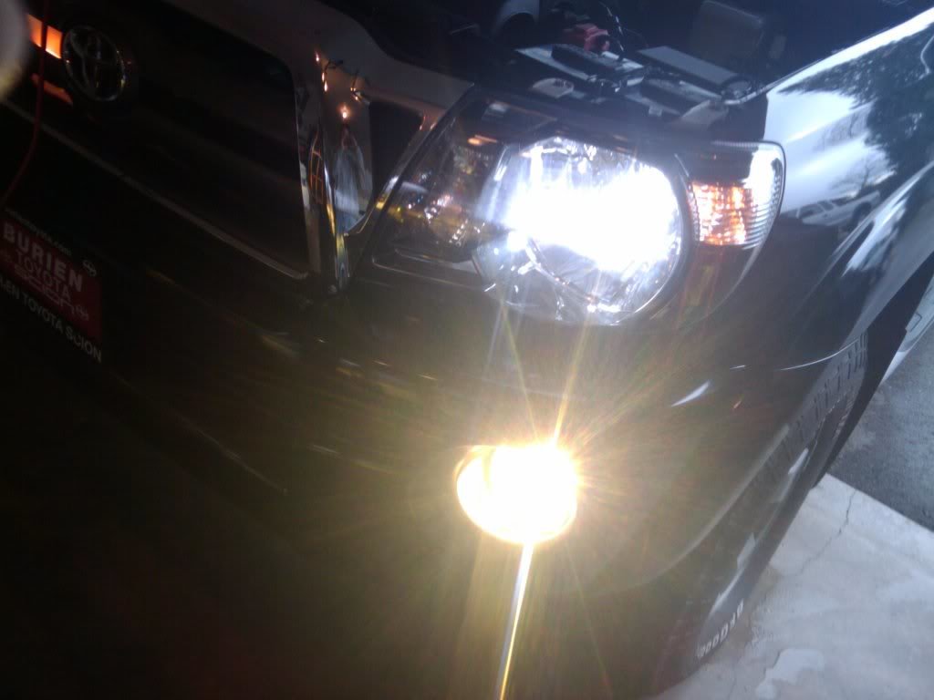

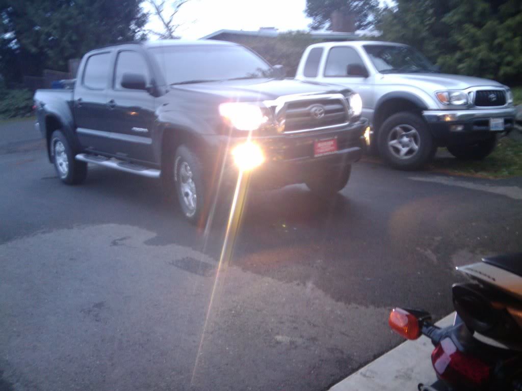

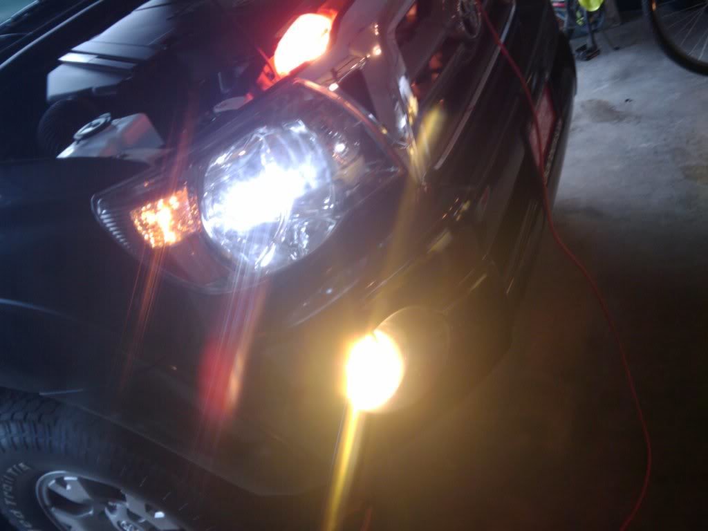

    The headlights are ddm 5k and the fogs are the 3k's.
