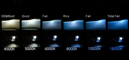

  3. Jan 9, 2014 at 5:35 AM
    neonlazer
    neonlazer Mechanically Goofy
    Oct 17, 2011
    #65333
    2,611
    Lafayette, LA
    '23 DCSB 4x4 SR5
    The combination of 55w and 10000k will almost certainly get you pulled over. Go with 35w and something 6k or under. Note that also you will not get as much light out of as a 4300/5000/6000k.

  5. Jan 9, 2014 at 6:24 AM
    itzyoboipaul
    itzyoboipaul Well-Known Member
    Jul 18, 2013
    #108518
    2,922
    Paul
    PFville, TX
    2020 TRD OR Cement
    1000k all you will get is that purple blue color and that's about it
    you wont see squat. you will piss/blind every other drivers around you.
    like they said stay between 4300k-6000k.
    and if you really want to do it the right away. RETROFIT!

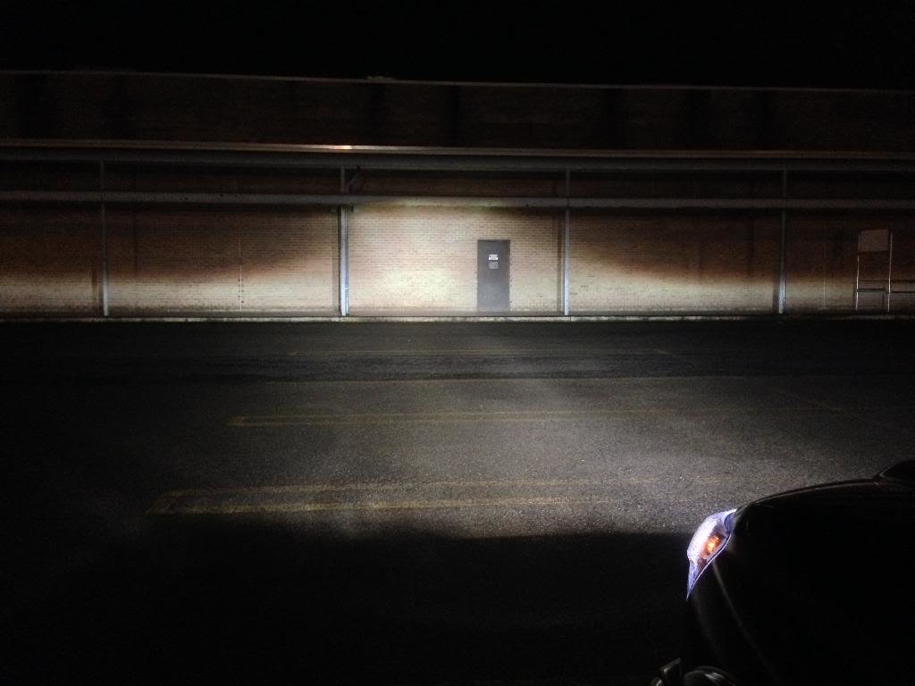

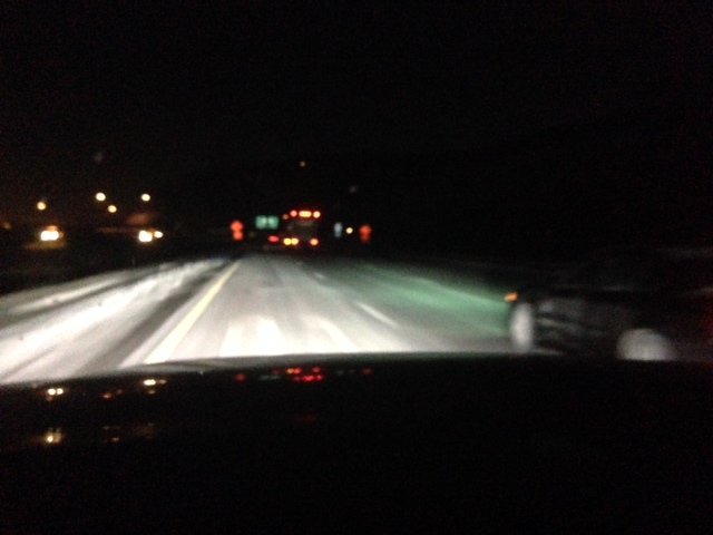

  14. Jan 9, 2014 at 8:33 AM
    InSight Retrofits
    InSight Retrofits Closed
    Sep 17, 2013
    #112687
    1,260
    4300k is brightest, 5000k (which I went with this retrofit) is still bright but pure white and 6000k is still bright but slightly blue.
    If you retrofit you will smile every time you hit the high beams or see your cutoff flicker off something. Just a warning.
    Here is me going by an impala with an 8000k plug and play kit. Looks green in the pic for some reason.
    mine
    4A1A11BC-50CE-4C02-914D-CED0CC265BA6_zps_21aa804069f32bfeaff46595fa1f5345a19cf20c.jpg
    my bike, stock projectors 5000k bulbs
    my bike, stock projectors with 8000k bulbs. Blue doesn't look cool, one it looks stupid and light output sucks. I learned that the second I put them in and immediately went to 5000k.
