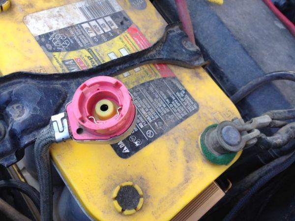

    so a few days leading up to the blackout, my headlights would some times not come on when i turn them on. i would need to turn them off and back on for them to fire up. then monday they gave up. both lights do not fire up at all.
    setup:
    1x Bi-xenon Morimoto Mini Stage III Kit (D2S)
    • Wire Harness: Relay: H4/9003
    • Bulbs: 1x D2S: Philips 85122+
    • Ballasts: 1) Morimoto 3Five 35w
    so i tested the voltage at the bulb connection
    and my driver side was at 23 volts, but the passenger side was only hitting 6-7 volts
    volts at the factory headlight connection was at 12
    tried a different bulb (Morimoto 3Five 5000K D2S) and no luck
    grounds all appear fine (they have been fine for over 2 years), but i went over the connections to make sure and cleaned up some wire routing while i was at it. but no changes made.
    so i'm baffled...why would both lights not be working? 24 volts at one, but only 6 at the other, ballast? but why would the other side not work too?
    any suggestions?
    thanks
