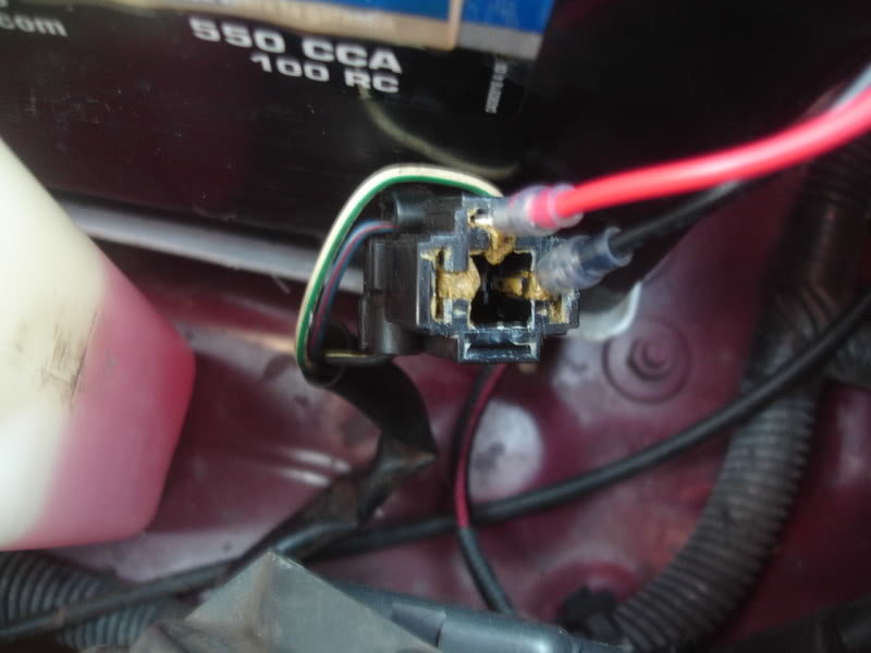

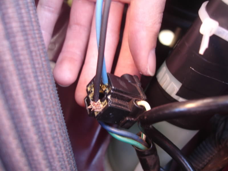

    okay so i got in a new set of HIDs/ballast (single beam) and my cooworker installed them for me. he did a different kind of setup though... he used his own plugs and it conflicts with the DRLs. when i release the parking brake, my bulbs start to flicker and when i switch the lights to on, they still flicker. then once i turn the knob to my highbeams, the lights stay on... he said i would have to purchase something else in order for the HIDs to work with the DRLs.. anyone know? heres the pics of what i got going on... thanks in advance

    That is nasty looking!!!!! First thing is to let someone else do it. Really, that connection is doomed to failure. Did the kit come with any instructions??? The HID's I purchaed from Slim were easy to install and work very well.

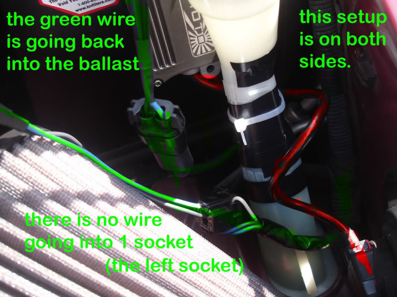

    appreciate the info guys, but idk with this setup i dont even got a relay harness or nothing, its basically from ballast to lightbulb on each side.... the ballast are good quality so i dont really want to get rid of them but it seems like i need the wiring for the DRLs and could use a wiring harness... like the DDM setup. i ordered my kit from DDM before, but had to return it because it wasnt working properly....

    That's a fire in the engine bay waiting to happen.

    hmm well the thing is i think i got a pretty nice ballast..? the matsushita gen 3... but the thing is that i dotn have any good wires for it... i thought i was getting the whole kit... but man this is horrible

    exposed hot/negative wires like that can create shorts and fire. Get rid of that ghetto ass shit.

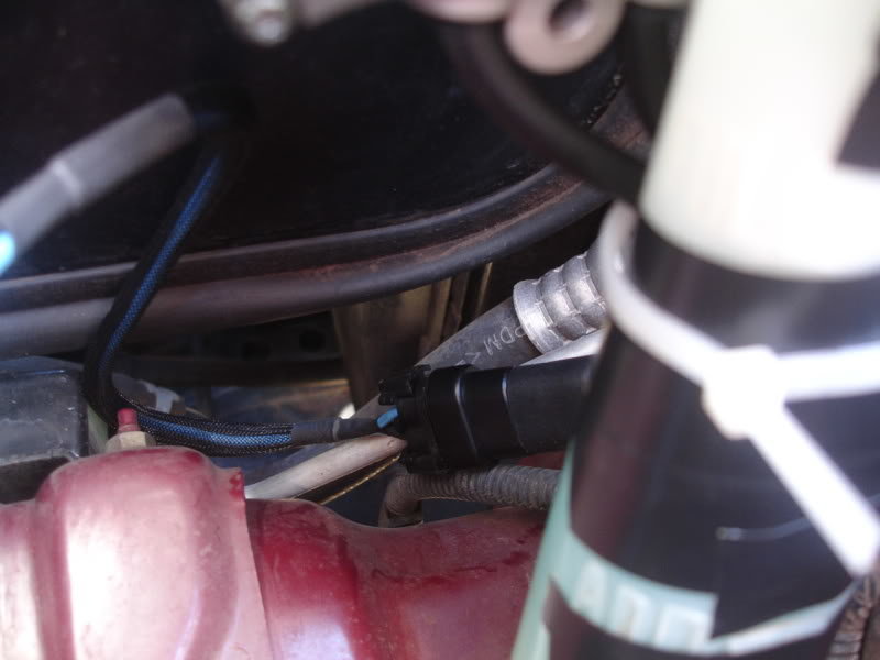

    okay so heres whats going on in my setup:
    do you think that if i were to buy a wiring harness it would help solve the problem?
