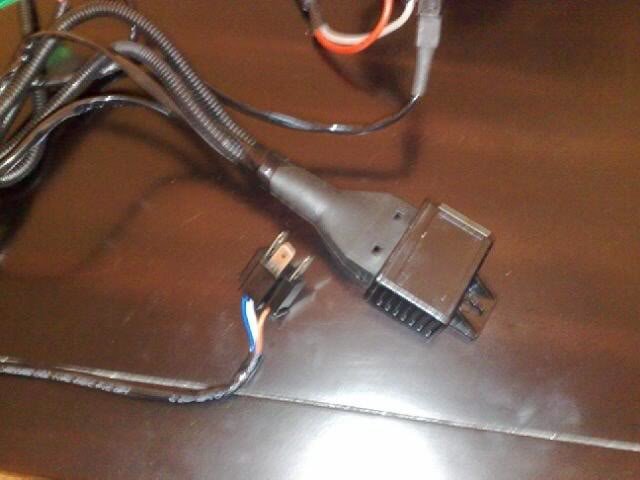

    Hey guys just wondering what these plugs were for.

    ok, this is kinda hard to explain with text, but i'll try my best...
    in the top pic, it is just a fuse used for overload protection...
    in the 2nd pic, the "plug" you're showing will plug into where a stock bulb would plug into...
    Sorry, if i'm not making any sense...
    btw, i just installed my HID fogs...
    i now have HID Headlights and Fogs...
    If you need help, i'd be willing to help you out with the install...

    first pic is just a fuse, run that to your battery.
    second pic is the piece that selects from high beems to low beems. [i think]

    That the positive wire(goes to battery positive)
    The hi/lo relay
    The 3 prong plug plugs right into your factory harness...

    Everything what they say is correct... inline fuse for the protection of overload... and the bottom plug is to be plugged into your stock plug that was once connected to the back of your halogen bulb. Let me know if you need more help.
