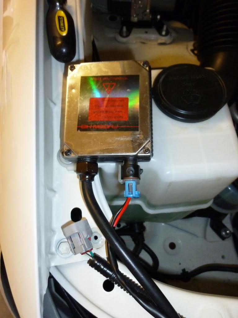

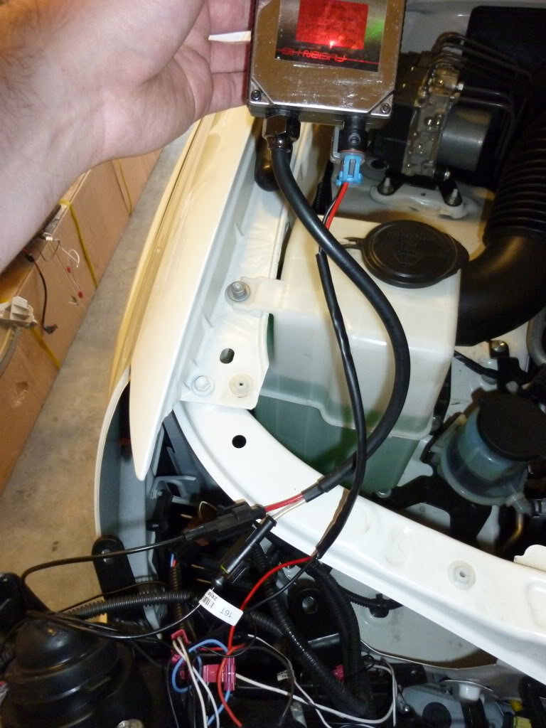

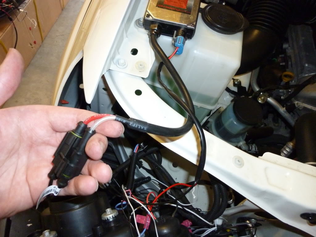

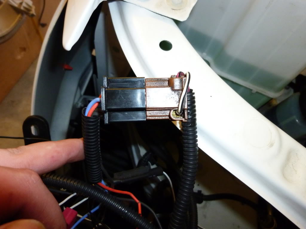

    Below are pics of what I have. The problem is the hid's are low beam only but aren't working when I turn the lights on low. They will turn on when I put them on high beam but it's supposed to be regular lights on high, not the hid's. They were prewired with the Hid's already installed so I didn't mess anything up that end.

    I had the same problem, but its a simple fix if yours are like mine. P1000322_f2218fa91a7154fe3d59fe70e1d809503a839614.jpg
    In this picture you have the new wiring harness, with the blue and red wire and what looks to be black? Now for me I had two red wires but it would be the blue and red wires for you. What you might have to do is unplug the connection in this picture and switch the blue prong with the red prong. For me all i had to do was swap the two prongs and it was fine. Just take a look at it and see if you can get them out and then swap them. If you cant do that then i dont know. but it worked for me
