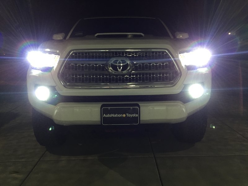

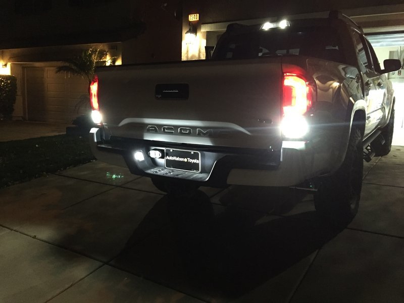

    Simple plug n play both from iJDMtoy.com and they usually have coupon codes too. No need for relay or canbus decoders. I got both low beams and fogs for only 130 and bought all my interior lights, reverse lights and license plate lights from them. Good stuff.

    Nice thanks for the info how is the vision at night and rainy weather?

    It's actually really clear and I'm thoroughly impressed. HIDs are typically brighter than LEDs so if you are going for brightness, stick to these. Mine is 6000k. So far I haven't gotten high beamed from oncoming traffic so no adjustments made yet.

    Did you get anyone shot back to you at night? Just worry about the light could be scatter.

    Thanks! I haven't had one person flash me back yet and I've been using them for over 4 months. I believe the light isn't as scattered as other headlights on previous tacomas because 3rd gen has a projector headlight assembly which HID works better in.

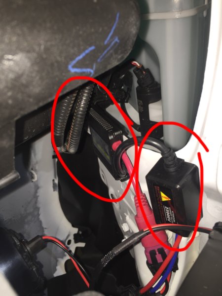

    Did you get the relay and/or other harness? Thanks

    No relay just the ballast and harness that comes with it. I used heavy duty double sided tape to mount them.
