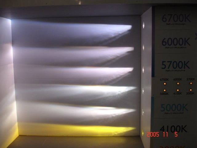

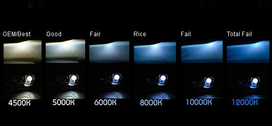

  12. Dec 22, 2012 at 9:54 PM
    Rich91710
    Rich91710 Well-Known Member
    Feb 23, 2012
    #73470
    16,399
    Rich
    Los Angeles
    08 Base
    Satoshi with FJ badge, factory cruise, factory intermittent wipers, Redline Tuning hood-lift struts, Hellwig Swaybar, Rosen DVD-Nav
    I've seen a number of charts that aren't even close to reality.

    as far as the kelvin between brands, ive seen some brands where 6k is a light blue and 6k is a purple, it all depends on the quality of the product.

    The difference between the various charts is likely due to wattage.
    A 55w ballast will "wash out" burn a lamp slightly closer to 4000k than a 35w ballast will, so a 6000k 35w will absolutely appear slightly more blue than a 6000k 55w... but a 6000k should never appear to be a darker blue and purple is absolutely in the 10,000k+ territory.
    Likewise, a 35w 3000k will appear more yellow than a 55w.
