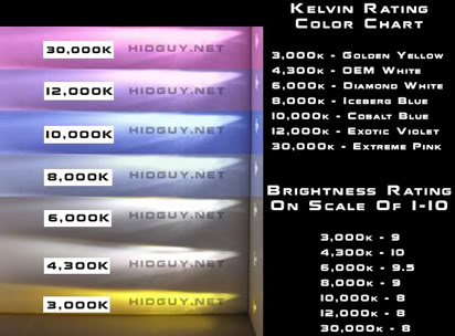

    I had 10000K hid headlights and fogs at 35W. I figured I wanted something brighter so I went and bought 6000K headlights and 4300K foglights both at 35W. I did half the truck 10000K and the other half the new stuff and honestly I think the 10000K is brighter. Can anyone help me out here. Is the new stuff going to be better or should I keep the 10000K?

    10000k? so basically purple... 4300k is pure white, it will be the brightest, with 5k and 6k behind it. higher the number, the more blue/purple it gets..ie less bright

    10000K is bright blue. And the 4300 I got actually look yellow.............. So you guys are saying stay with the 35W 6000K and 4300K?

    when in doubt check the chart

    That helps alot thanks. I forgot about the chart
