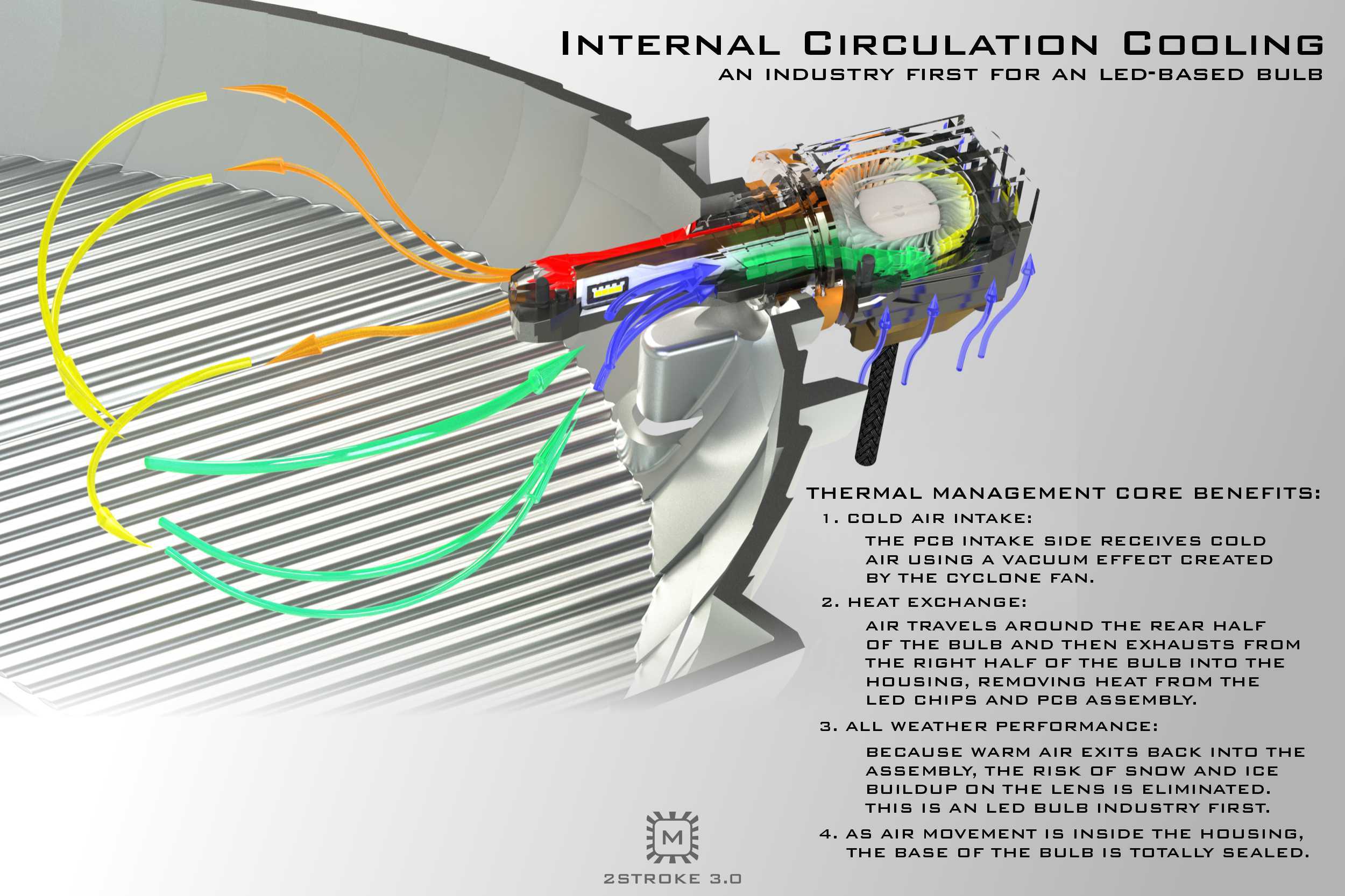

    I feel like the new morimoto 2strokes have a design flaw. The fan inside of them pulls in air, blows it into the headlight housing, and then sucks it out again. If your driving in rain, fog, or generally damp conditions its just going to blow moisture into the headlight housing. Now move this to northern climates with so much salt in the air you can taste it, that fan is just going to blow salt water all over the inside of your headlight.
    EDIT: looks like their website cuts off the last 2 bullet points about the headlight, including the one that says its a sealed unit so air doesnt get inside.

    Those are a bulky poor/dated design that will increase foreground light and reduce distance projection. The distance between emitter faces is way to large, I would not recommend those. Unfortunately 'good reviews' are usually based on people seeing huge increases in foreground light and thinking the lights are a significant improvement as people intrinsically favor foregound. But that isn't how a headlight is supposed to work, and they do not realize they have lost their distance projection.

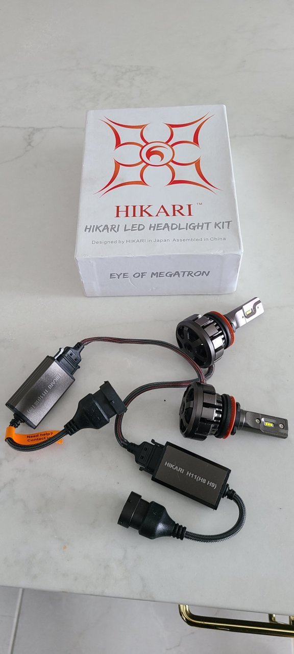

    Holy Schmokes these bulbs are awesome.
    They look incredible and seem to have some great distance lighting.
    Very pleased.
    Also matches the color of the fogs almost perfectly.
    This is exactly the look I was going for. Suddenly lost the desire to do the BHLM.
    If you're considering Hikari, don't even hesitate
