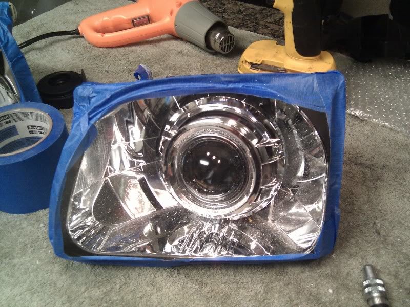

    Good timing on this thread... I was just doing this last night.
    WIP obviously............

    what projector is that?

    FX-R (Apollo bezel) from TRS. I figured if i'm going through the trouble I should put in the best bi-xenon (but more importantly, the best crystal) I could afford. Surprisingly the bezel required a lot more trimming than one would expect from a "kit".

    can you take a pic of the back and detail of mounting the projector?
    i was gonna either those or the mini's just for ease of mounting

    When i'm done. Might be a few days before I get back to it.
