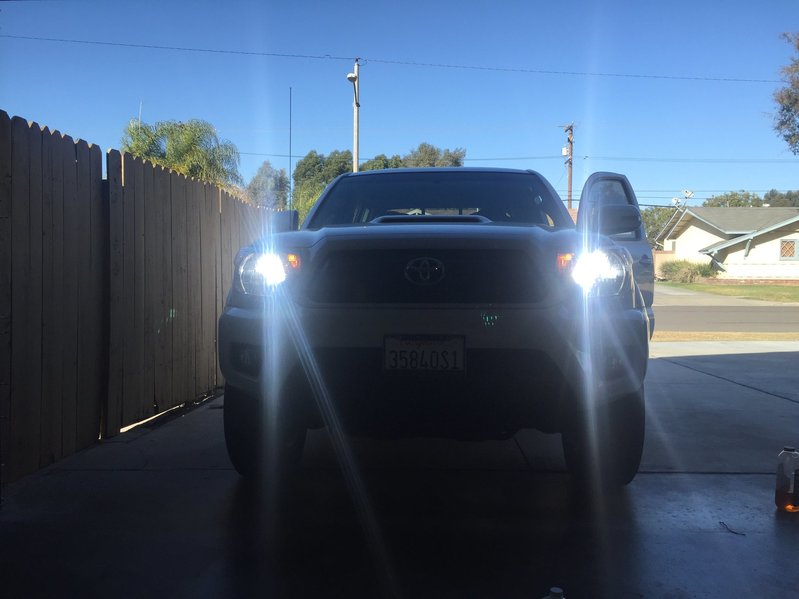

  14. Jan 6, 2016 at 10:25 PM
    15TrdSportec
    15TrdSportec Well-Known Member
    Jun 21, 2015
    #157896
    148
    2016 DCSB TRD Sport 4x4 Super White
  15. Jan 6, 2016 at 10:26 PM
    MatthewMay1
    MatthewMay1 I'm an amateur professional.
    Nov 21, 2011
    #67486
    11,102
    Matthew
    Lone Star Republic
    Supercharged '01 TRD
    :facepalm::smack: You better be planning a retrofit soon.
  16. Jan 6, 2016 at 10:26 PM
    #16
    Toy1985gc
    Toy1985gc [OP] Well-Known Member
    Jun 20, 2015
    #157815
    419
    G
    2020 TRD Sport 4WD DCLB Tech Pckg Cement
    3 & 1 leveling kit 32 BFG KO's x17 Method Roost wheels/ TRD Skid
    Looks good- I should have mine in by Friday
  17. Jan 6, 2016 at 10:27 PM
    #17
    Toy1985gc
    Jun 20, 2015
    #157815
    419
    G
    What do you mean? I'm just replacing hid bulbs
  18. Jan 6, 2016 at 10:29 PM
    #18
    Justus
    Justus fucks not given
    Jan 4, 2013
    #94417
    9,230
    Nabisco the kid
    In ur toolbox
    not so low, not so slow 2006 6 lug
    stockish
    ur gunna blind ppl
  19. Jan 6, 2016 at 10:30 PM
    #19
    MatthewMay1
    Nov 21, 2011
    #67486
    11,102
    Matthew
    Lone Star Republic
    HID bulbs NEED to be in a projector housing, NOT a reflector housing designed for halogen bulbs. There's a ton of information on this site about why. I'm too tired to dive into it right now, but long story short you are getting less focused light patterns with HIDs in halogen housings. Not to mention you infuriate every other driver on the road at night.
  20. Jan 6, 2016 at 10:31 PM
    #20
    Toy1985gc
    Jun 20, 2015
    #157815
    419
    G
    Point taken- thanks for the heads up
